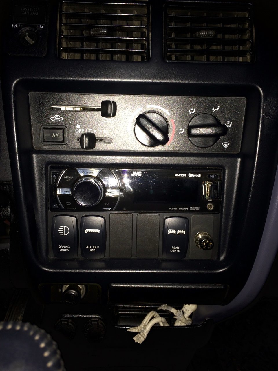

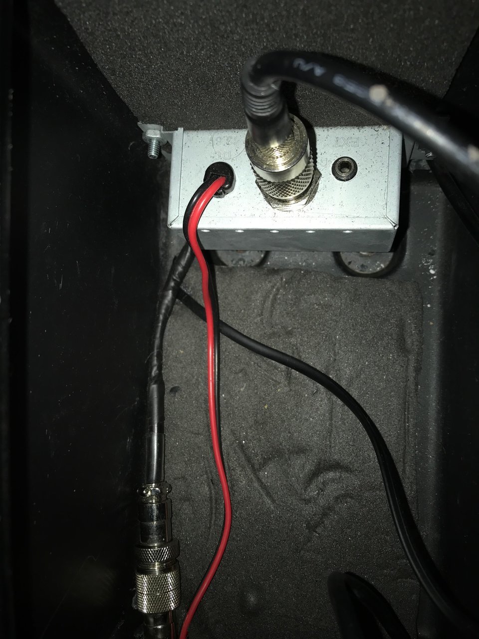

    I have a Cobra 75WXST handheld CB. The remote box is secured in the lower compartment of the center console where it then runs to the back of an OTRATTW blank that nests in my Paranoid switch panel in the single DIN spot under the head unit. I just store the handheld mic in the glove box until I need it.

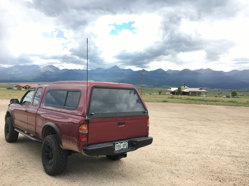

    I have a 4' Wilson Flex antenna mounted on a BAMF tailgate mount on my driver's side.

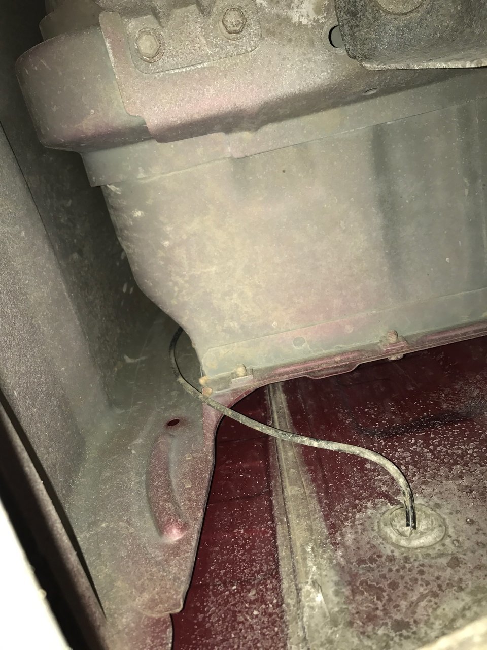

    I ran the coax from the antenna under the bed rail in the bed down to the front of the bed on the driver's side - fully concealed and out of the way. The coax was then fished down the channel that runs between the two skins of sheet metal on the front of the bed. From there the coax runs through the driver's side grommet on the rear wall of the cab and into the rear storage cubby. Through a hole in the cubby under the carpet to the rear of the center console, up through a small concealed hole and into the lower compartment where the remote box is.
    Here's a crappy pic of the coax running down the channel between the two bed skins and into the rear grommet of the cab. This is looking up from the floor. You can see the channel on the left and the grommet on the right.
    I like this install a lot. All the cable, power supply, connections and CB is super concealed and the installation is clean. Might not be the greatest range for a CB but I've never once had any issue during a road trip or trail run.

    How did you surface mount the cb connector to the blank?

    Lots of epoxy

    Yup! Great little radio, nice to see someone with the same setup. And yes that is a Paranoid Fabrication bracket in the factory clock cutout! That guy makes some good stuff.

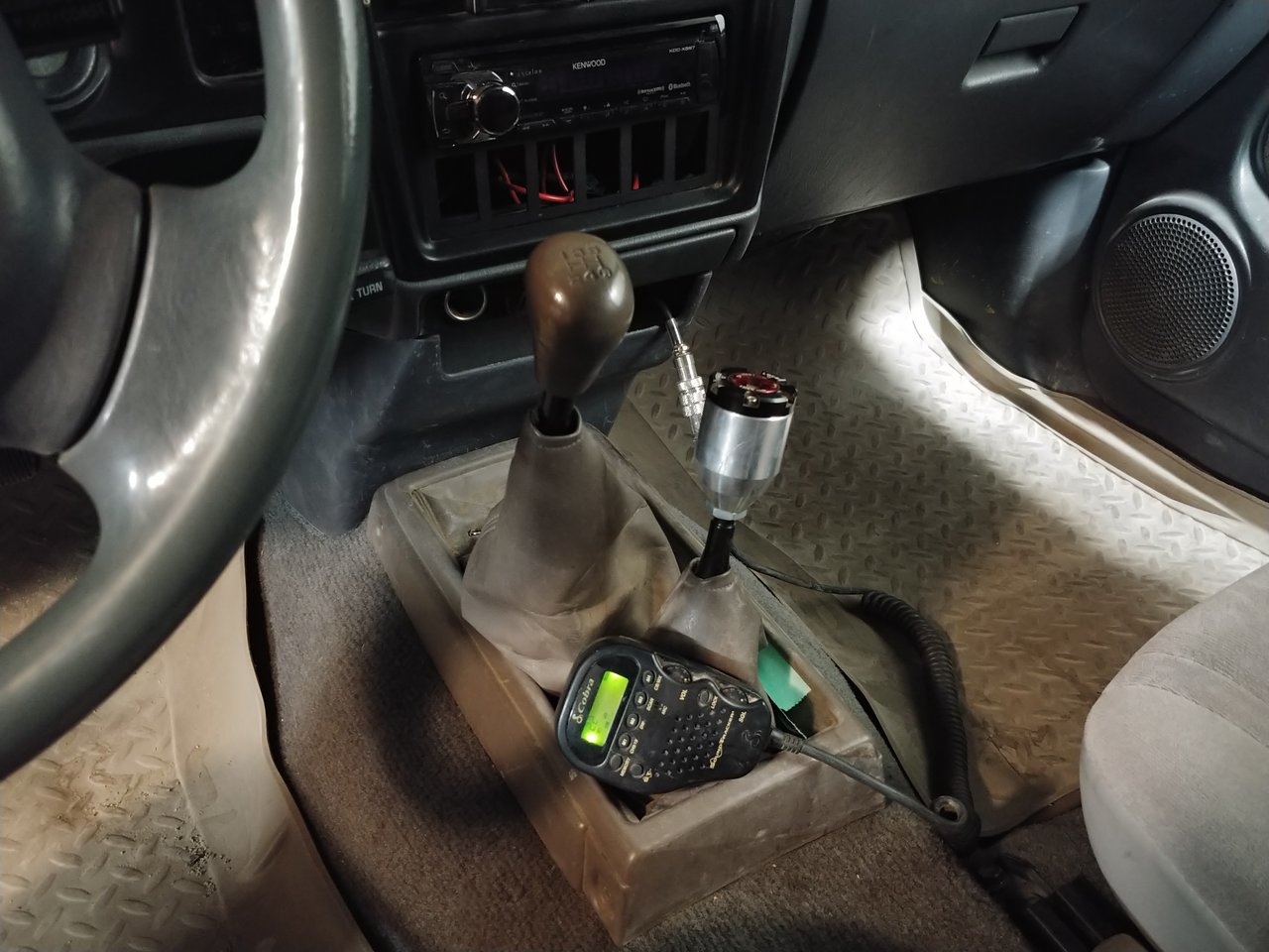

    It's less Tacoma and more mod
    Just went and took a couple pics of my setup. Used stock holes in dash to run the headset connector through (75 WX ST Cobra), and the transmitter is held behind a trim panel. Just a Wilson 3' antenna on the outside on a CBI mount. Tunes nicely to 1.2-1.3 SWR :)
