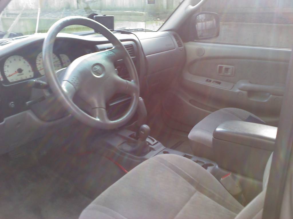

    That is the picture of my center console, bad quality my enV lense was dirty. Lol, note the power wire squished up against the centerconsole. Need to get that underneath :)

    Oh, I see it. Mine was a standard and I thought you wanted to remove the part you would lean your elbow on. Im not sure how that piece comes out, but I think it MIGHT just snap out. Look at the sides for screws holding it in and go easy, I could be wrong.

    Yeah i want to take the whole thing out. Shifter console, arm rest, I want to run that wire under it and potentially get a ground under there. Hoping to find a good bolt thats hidden.
