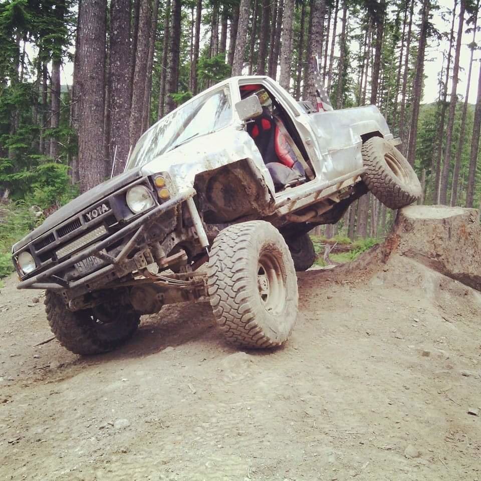

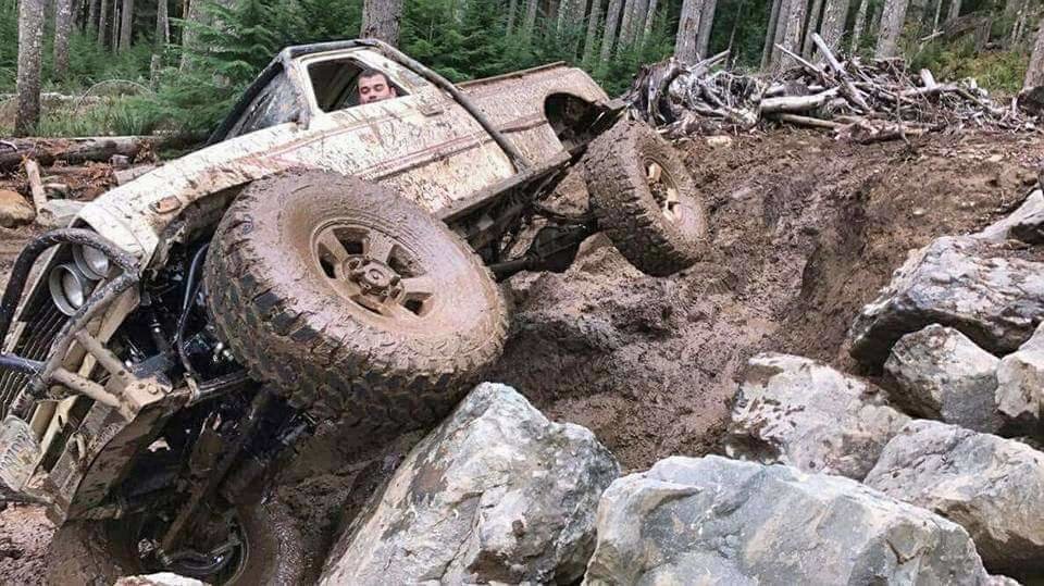

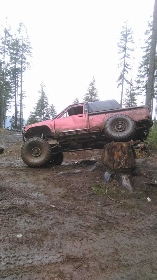

    Not a Tacoma like you said, but probably a good comparison. I almost never hit the shackles, with running 33-40" tires, and if I did, it never effected anything nor have I ever got stuck on them. Unless you're bobbed, you're going to drag your bumper/spare tire/rear end just as much, if not more, than you would a shackle. Ran 63s for 6 years on 4 different builds

    Yeah for the most part I've never really got hung up on the leaf/shackle, and if you do, its a smooth slide off. The 63s carry a good amount of weight, as they are coming off of trucks heavier than ours/meant to support more. All the rigs above were daily drivers, and all would max out 14" shocks. Handled great on the road, and I always ran 3.5-4" shackles.
