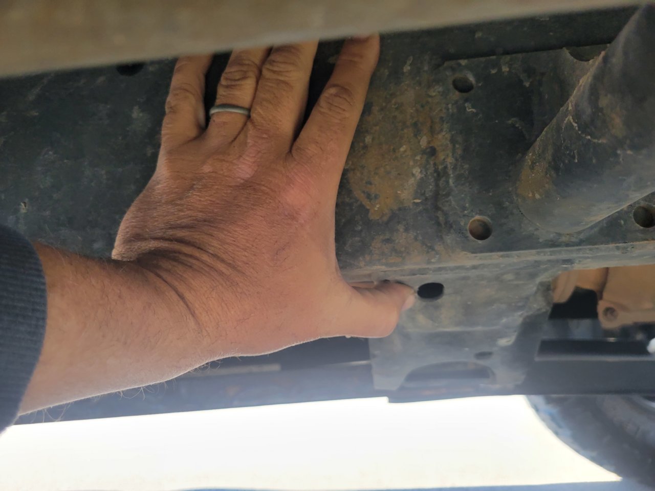

    @Speedytech7 how bout from the trans cross member?
    There's an oval on the back side of the cross member (it's there on both sides). How bout if you hooked to (or measured from center of it) that and went to center of the eye on the front perch.20230421_091514.jpg
    I think the cross member is always in the same spot, regardless of auto/man 4cyl/6cyl. Cause I've never seen it make a difference on skid plates. (I'm pretty sure that cross member is in a slightly different spot on 3 gen T4R. But I think it's always same on Tacoma).
    For the back. I know the earlier Tacoma had the rear leaf perches in a different spot. But I think the frame is always the same length. How bout measuring from the end of the frame to the center eye of shackle perch? Would that work?

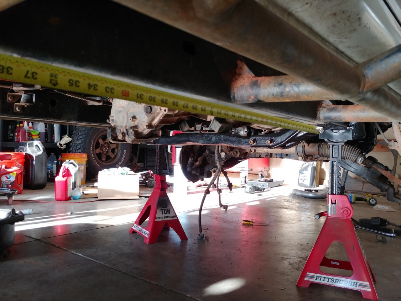

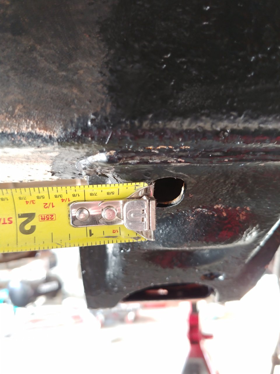

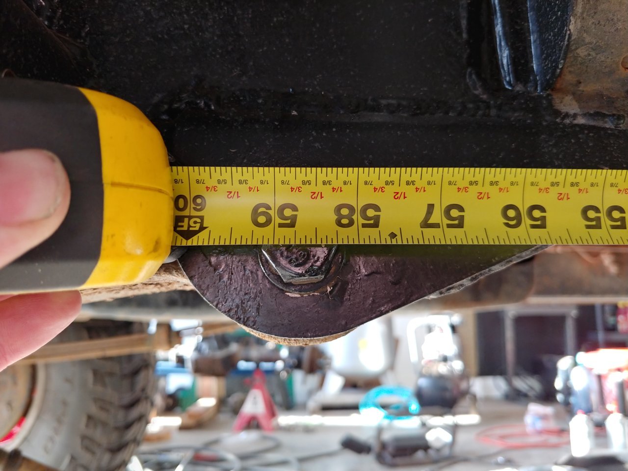

    58-5/8" from the edge of that hole in the x member to the center of the bolt. Exactly the same on both sides of my frame (that surprised me actually).
    Just so it's clear, this is how I was using that hole as a reference

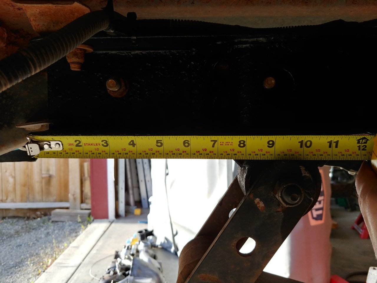

    9-3/8" from the end of the frame rail to the centerline of the shackle hanger.
