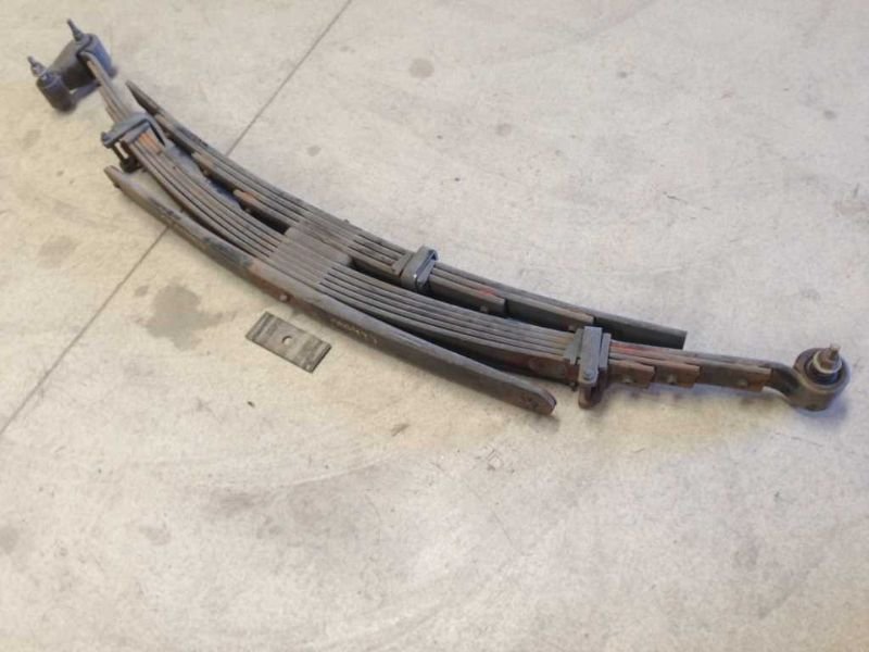

    Found a 3500 work pair
    I think this be able to handle the weight :rofl:

    Those look like the ones I've got

    It's less Tacoma and more mod
    Definitely don't run the micropack on top of the main pack, those are designed to hit bump pads hanging off the frame and will do nothing for you besides hit the frame and limit up travel.

    Haha, thank you for the clarification, but figured that was why they were there.
    I did not actually pick that pack up. but its an image from some of the ones i found. going to see if i can find that without the top pack (they want more for stuff that won't be used) don't know if that pack is available without them though.

    YA, Just glanced at the pic. Looked like 2 sets laying on top of each other.
    Didn't realize they had the overloads on top. Like Zane said... definatly remove those. The main leafs look like my pack (Thickness of leafs etc)

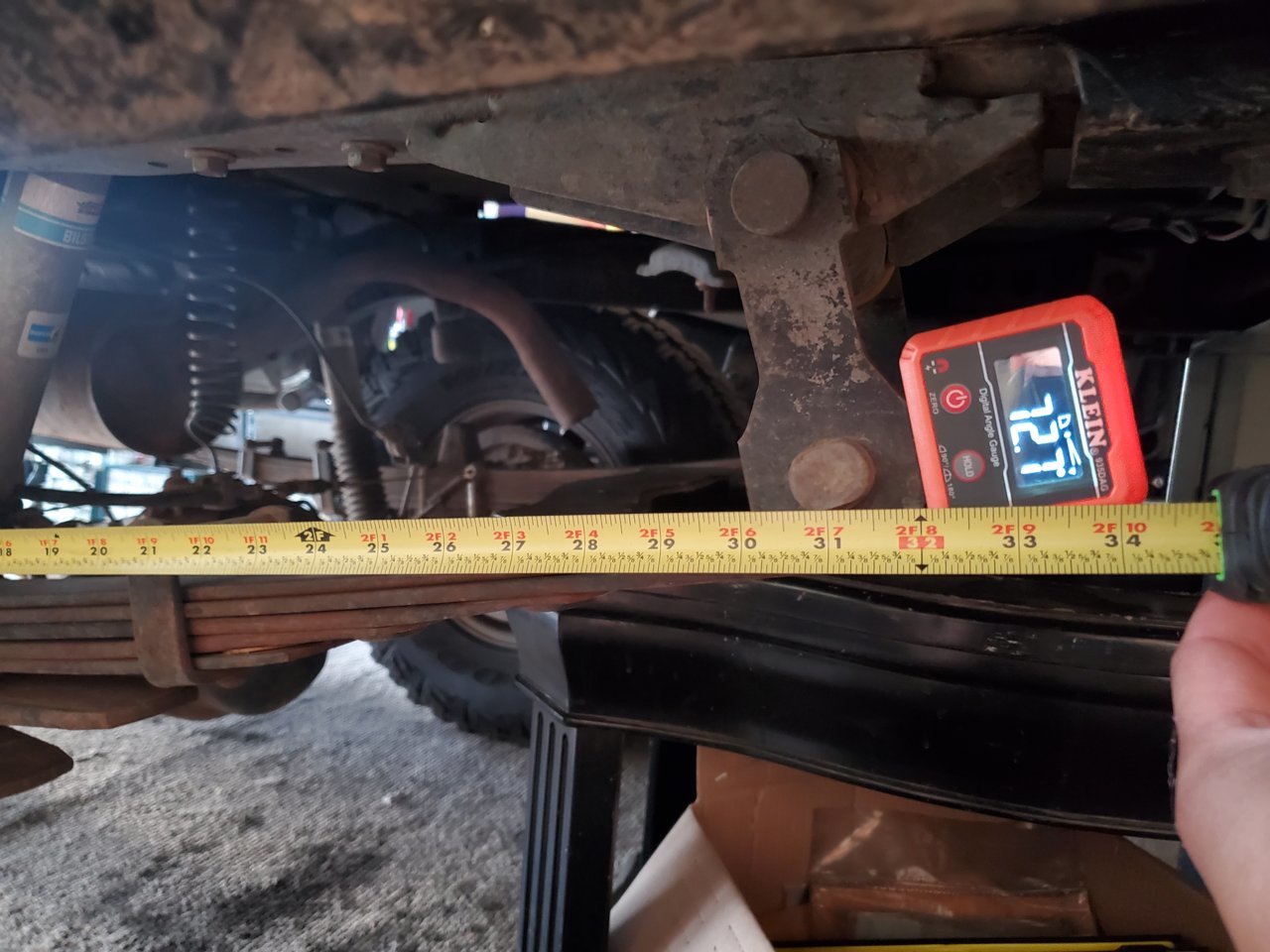

    Few questions for you 1st genners that have 63s already:
    1. Does the spring perch have to be clocked or can you keep the perch in the stock location?
    2. Did you have to move the rear hanger forward/backward?
    - I say this because I have Dakars on the truck now, at ride height from center pin to rear center eye of spring I got 31". The 63 measures 31 1/2" center pin to eye. I know my shackles aren't in the ideal angle but if I'm correct at most I would have to move my hanger forward to get the 45°.

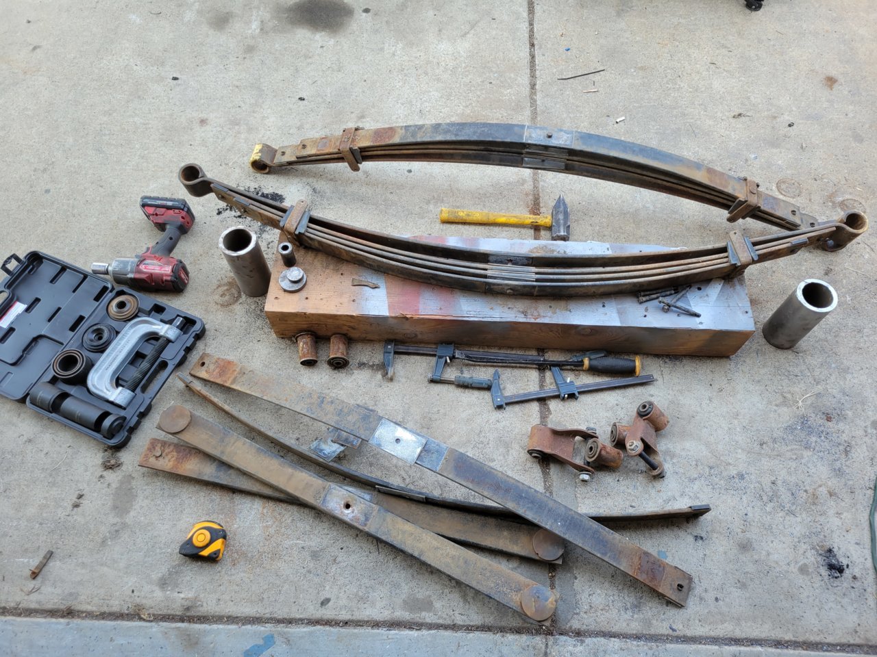

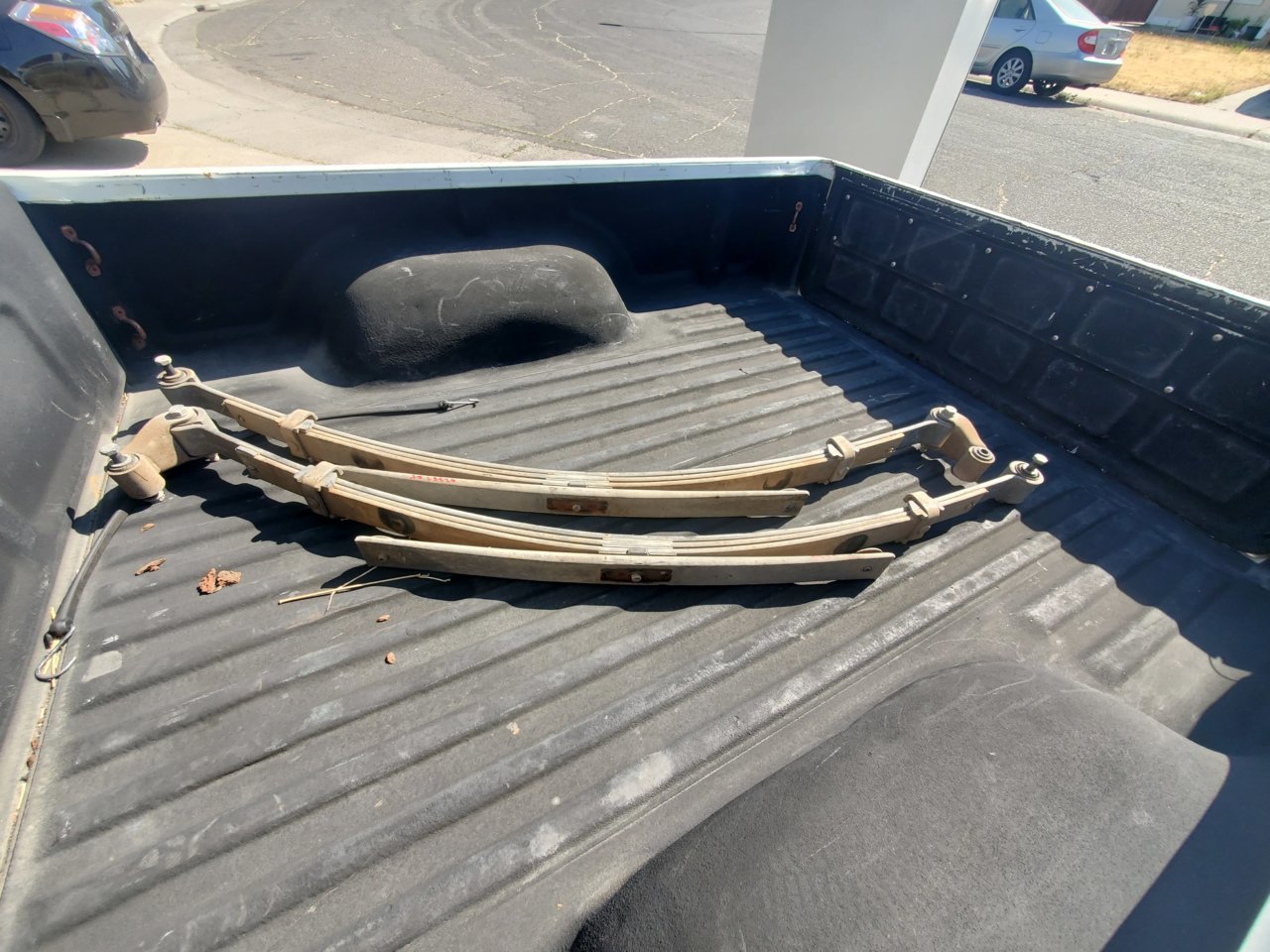

    Finally cracked open the leaf pack. I Think this is the stack I'm going to try first.
    Got the old shackles off and pushed the old bushings out.
    erice likes this.

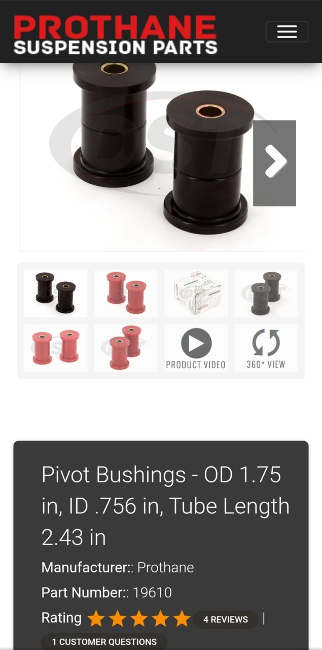

    Ordered bushings

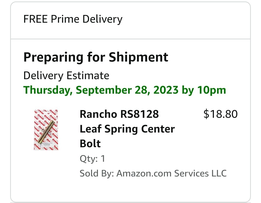

    Also ordered new center pins. (Don't forget about thise)

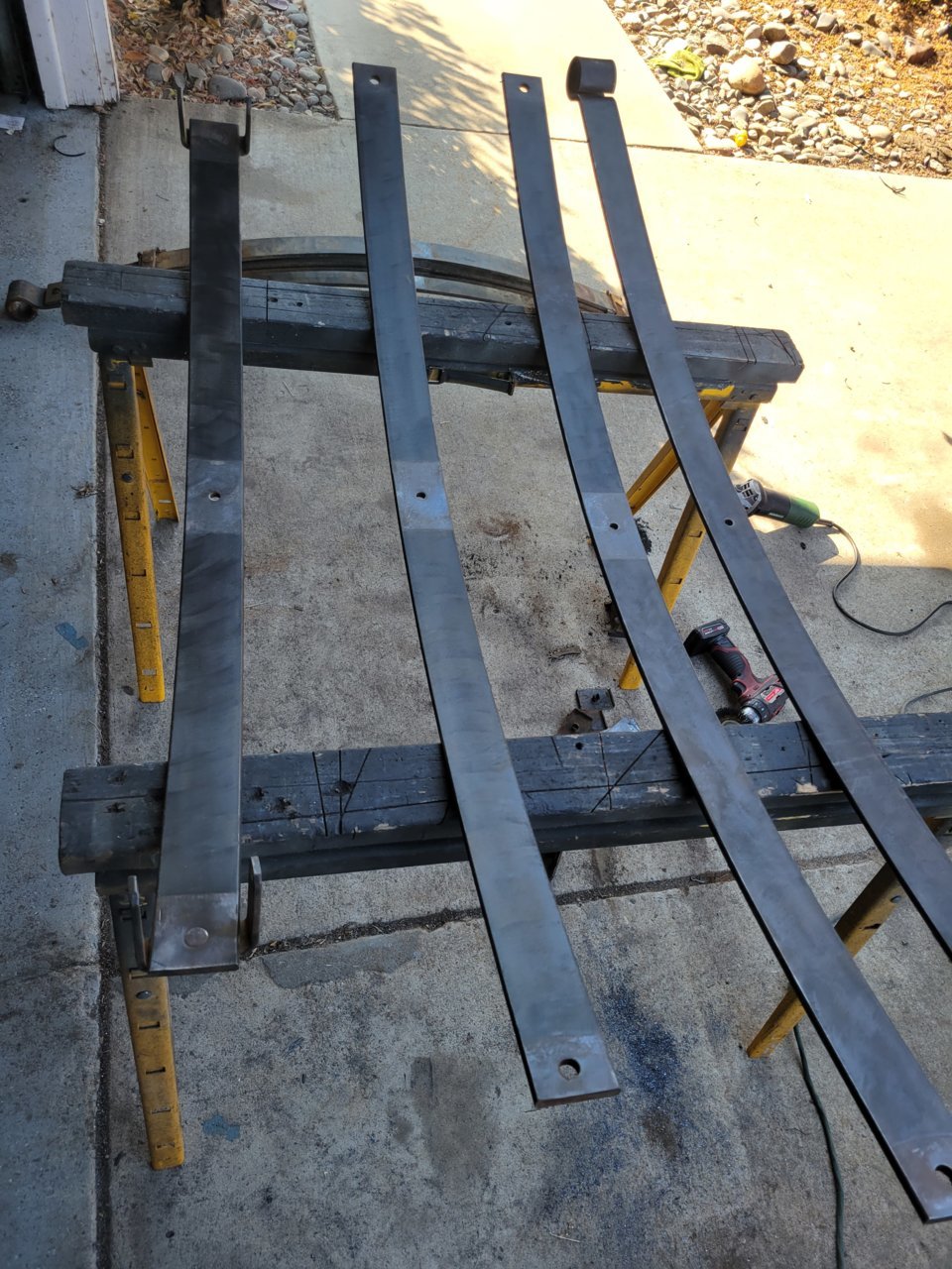

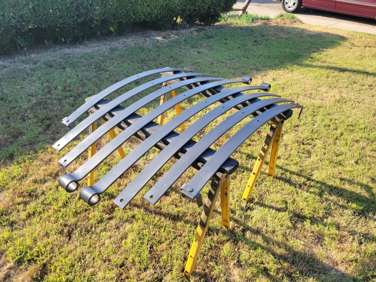

    Used a wire wheel to clean all the dirt and surface rust off the leafs.
    Said screw it and just put a light coat of Rustoleum on them. Just need to flip em and do the other side.

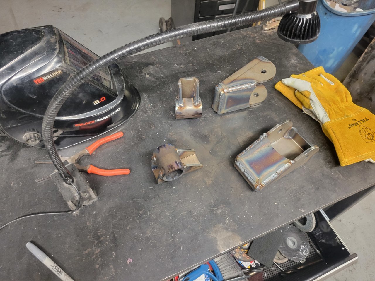

    Made a bit more progress. Zapped the leaf and shackle perches together.
