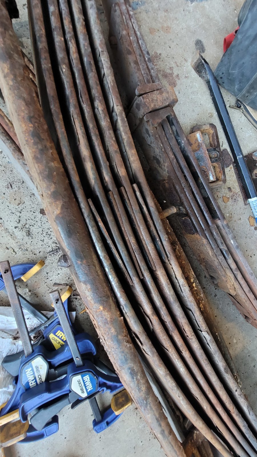

    Lookin good!
    Mine feel a little bigger

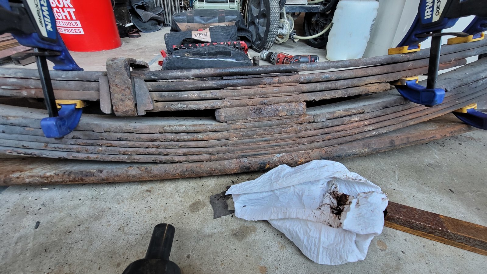

    Just need to figure out the safest way to bust that centerpin out

    C-clamps... or if you are going to use F-clamps, use the type that have the ability to screw tight.
    The quick grips don't have the ability to screw tight... which means they don't have the ability to slowly loosen (screw).
    I'd clamp the whole stack. Loosen and remove the center pin. Then loosen the clamps slowly.
    Honestly... I think that stack looks scarier than it is. It'll be under pressure, but I'd bet it won't be that much. It won't be like a coil spring type tension. (But that's just a guess)

    I used a big hammer and prayed
    The rusty paint some idiot put on it helped it loosen slowly.
    Yeah I couldn't lift them solo. Super heavy!

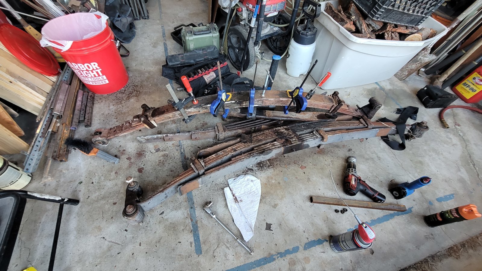

    Left the ends on. I spoke too soon lol
    All the clamps!

    Once you get them apart, that mini pack on top, and the overload leaf on the bottom go to the scrap yard... they'll be half the weight at that point :thumbsup:

    Yeah, welding and fab scrap. Maybe a knife? Anyone in sd got a forge?
    So, how did you clean your springs?

    Wire wheel on a 4.5 inch angle grinder.
    Acetone.
    Paint.

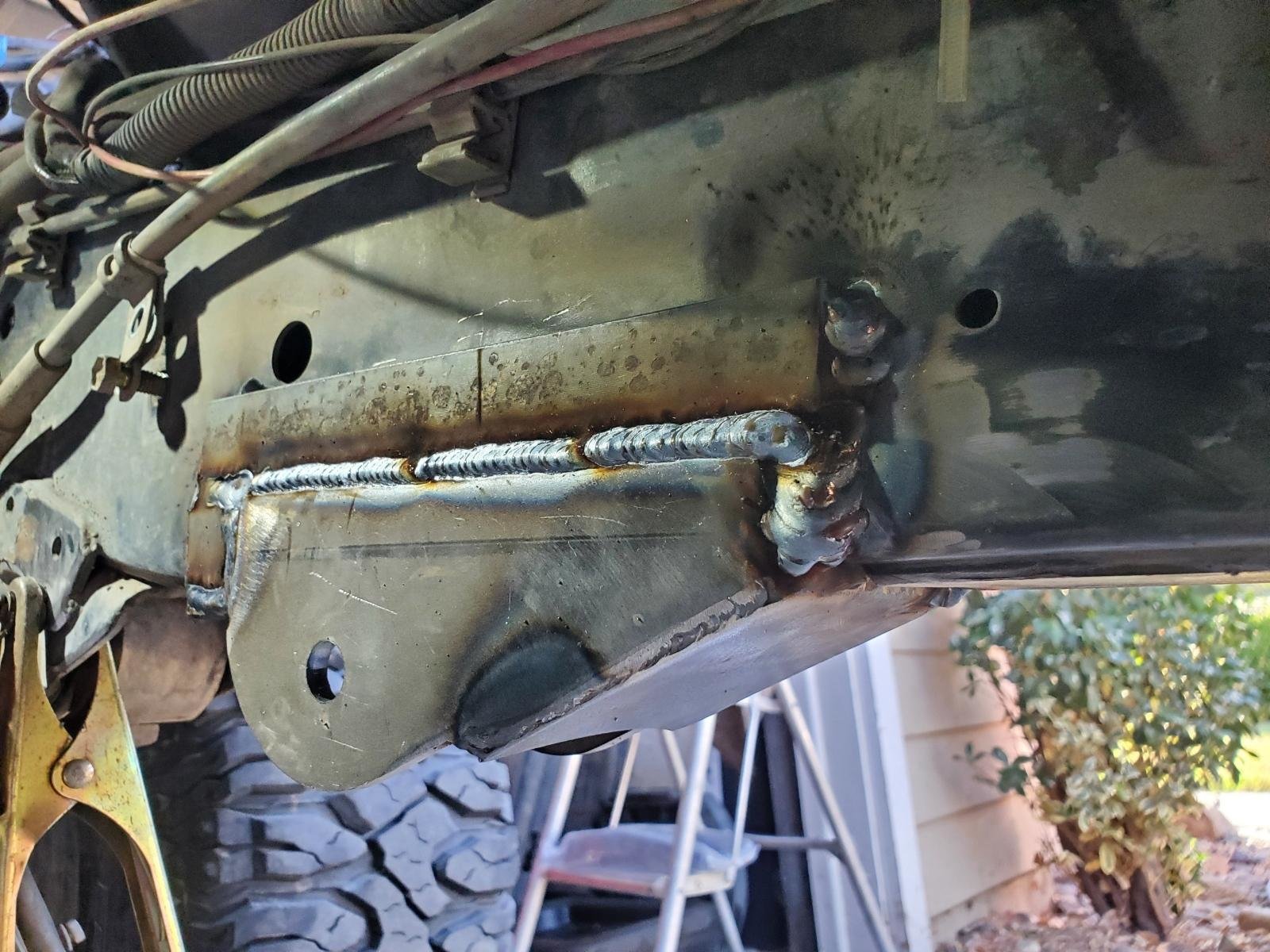

  12. Oct 7, 2023 at 5:05 PM
    #72
    ToyRyd04
    ToyRyd04 Taco Transformer
    Aug 5, 2011
    #61217
    1,879
    Greg
    Perryville, MD
    '04 PreRunner

  13. Oct 7, 2023 at 7:19 PM
    #73
    El Taco Diablo
    El Taco Diablo [OP] Professional Pinstriper
    Nov 6, 2017
    #235223
    13,979
    Matt - KN6DZP
    Hughson, CA
    Impulse Red DC, 5vz-fe, 4wd swap, LT, dual case, F/R locked
    Just 3 tons of fun!!!
    Nope, mine are frenched.
    erice[QUOTED] likes this.
  14. Oct 7, 2023 at 7:34 PM
    #74

  15. Oct 7, 2023 at 7:38 PM
    #75
    El Taco Diablo
    Nov 6, 2017
    #235223
    13,979
    Matt - KN6DZP
    Hughson, CA

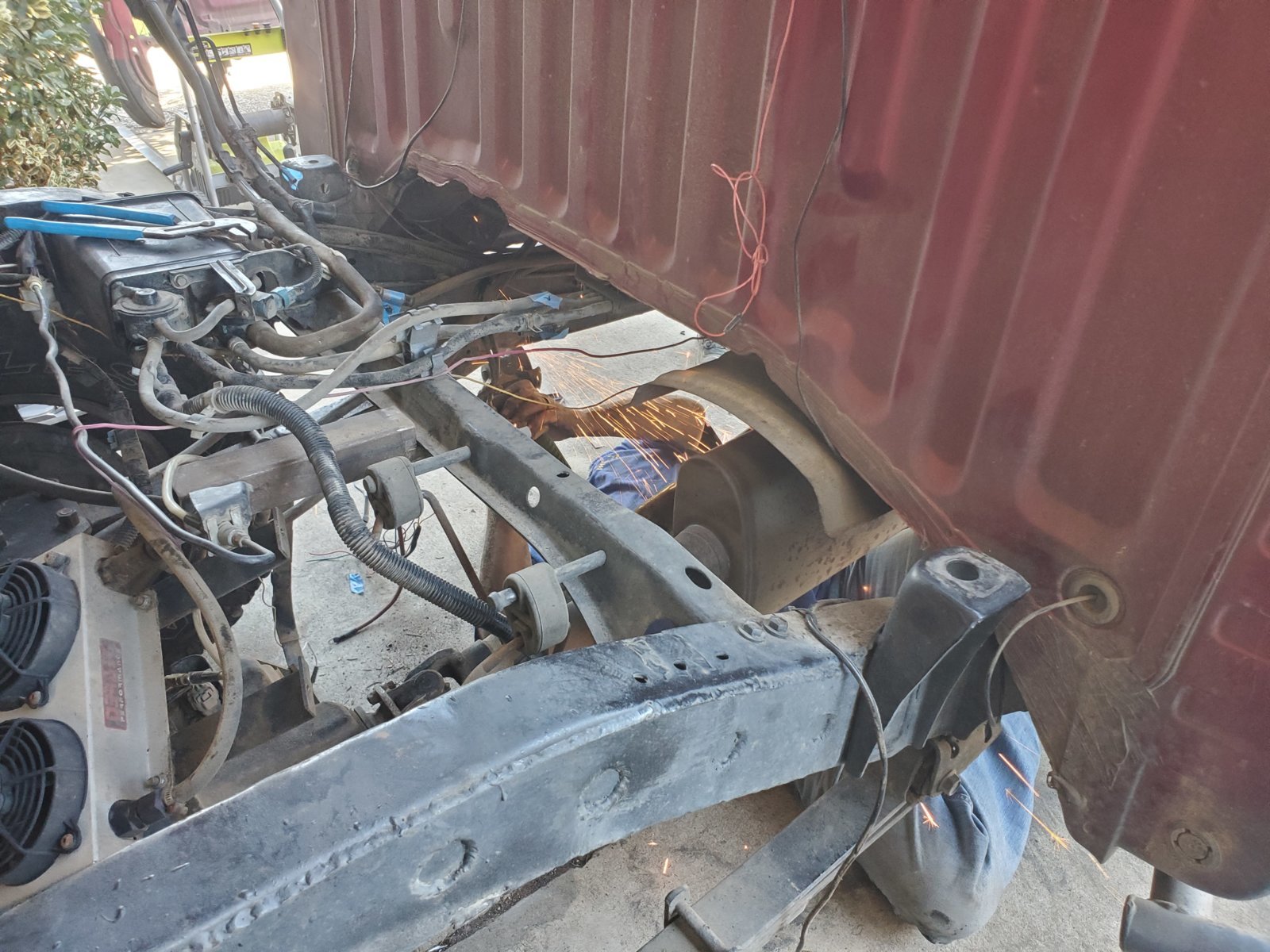

    Grinder and paint will make me the welder I ain't.
    Those nice welds are @Kwikvette. I'll take some pictures of the other side after I give it a little love.
    erice and Kwikvette like this.
  16. Oct 7, 2023 at 7:46 PM
    #76
    El Taco Diablo
    Nov 6, 2017
    #235223
    13,979
    Matt - KN6DZP
    Hughson, CA
    Welding those in was a major bitch tho, let me tell ya.
    Can't get in position. My old ass couldn't see crap. Tried with my glasses, without my glasses, damn near standing my head.
    Filling big assed gaps didn't help one bit either.
    erice and Dalandser like this.

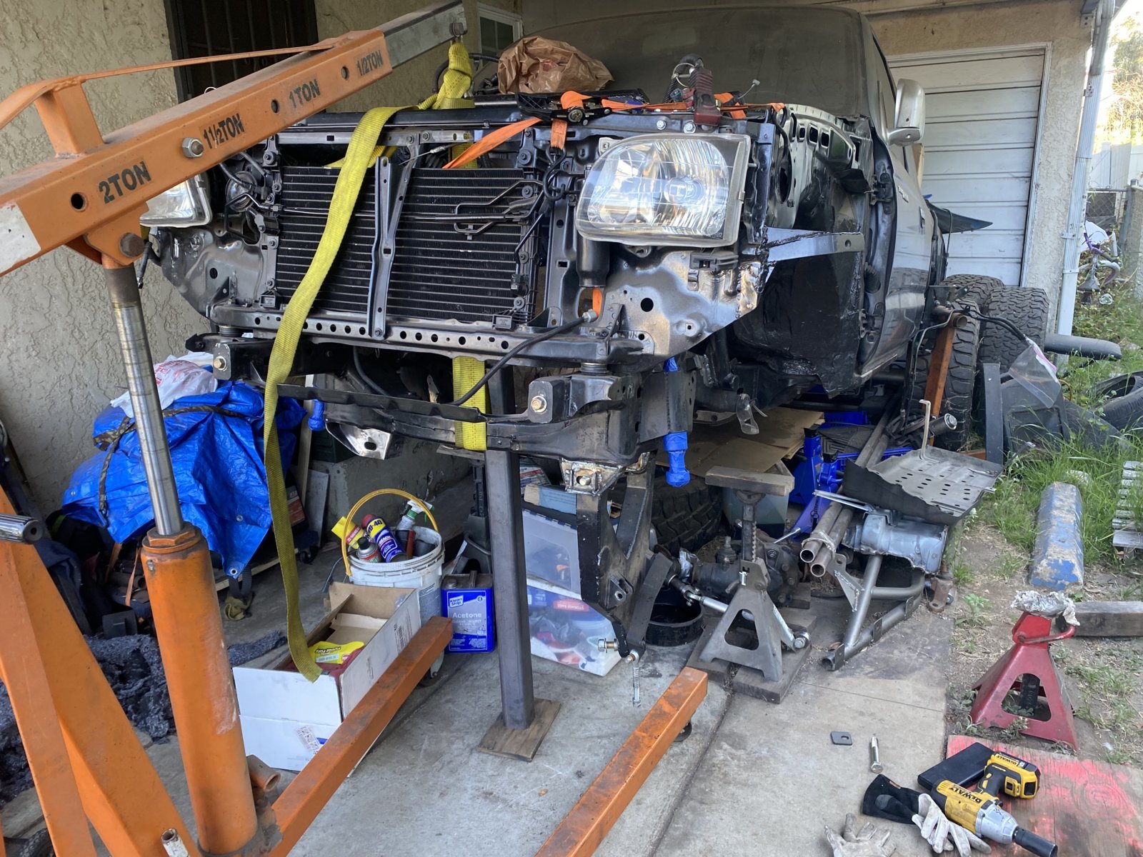

  17. Oct 7, 2023 at 8:08 PM
    #77
    Dalandser
    Dalandser ¡Me Gustan Las Tacos-mas!
    Feb 19, 2015
    #149090
    17,634
    Anthony
    Downey
    08 PreRunner Regular Cab / 98 4x4 Extra Cab
    Empty Wallet Mod
    Feel ya on that - my big jack stand when doing cam reinforcement - one day a lift would be amazing.

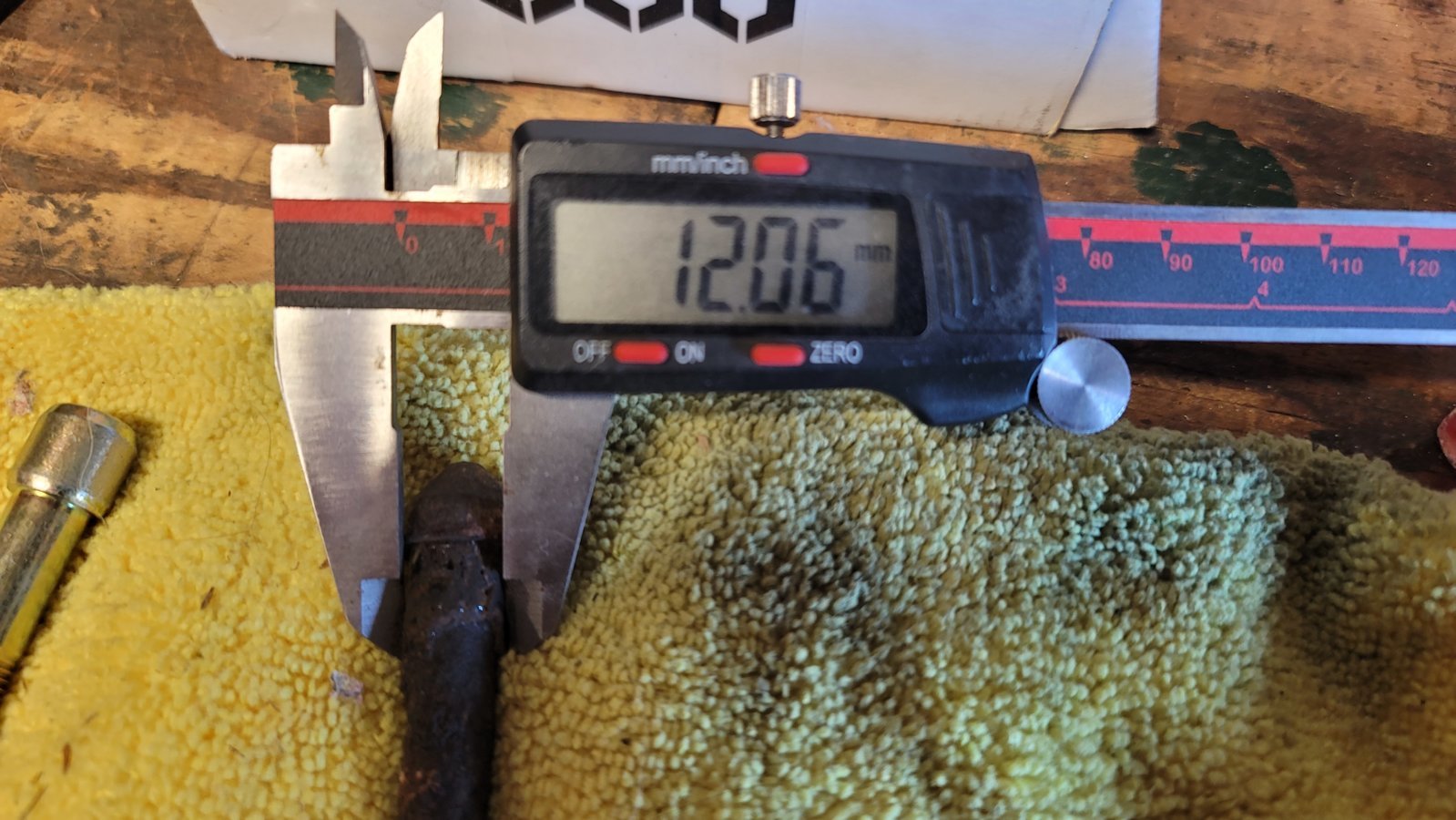

  18. Oct 8, 2023 at 2:48 PM
    #78
    erice
    erice Well-Known Member
    Nov 9, 2014
    #142008
    1,084
    Eric
    San Diego
    Now thats some sexy French.
    @Kwikvette me next?!

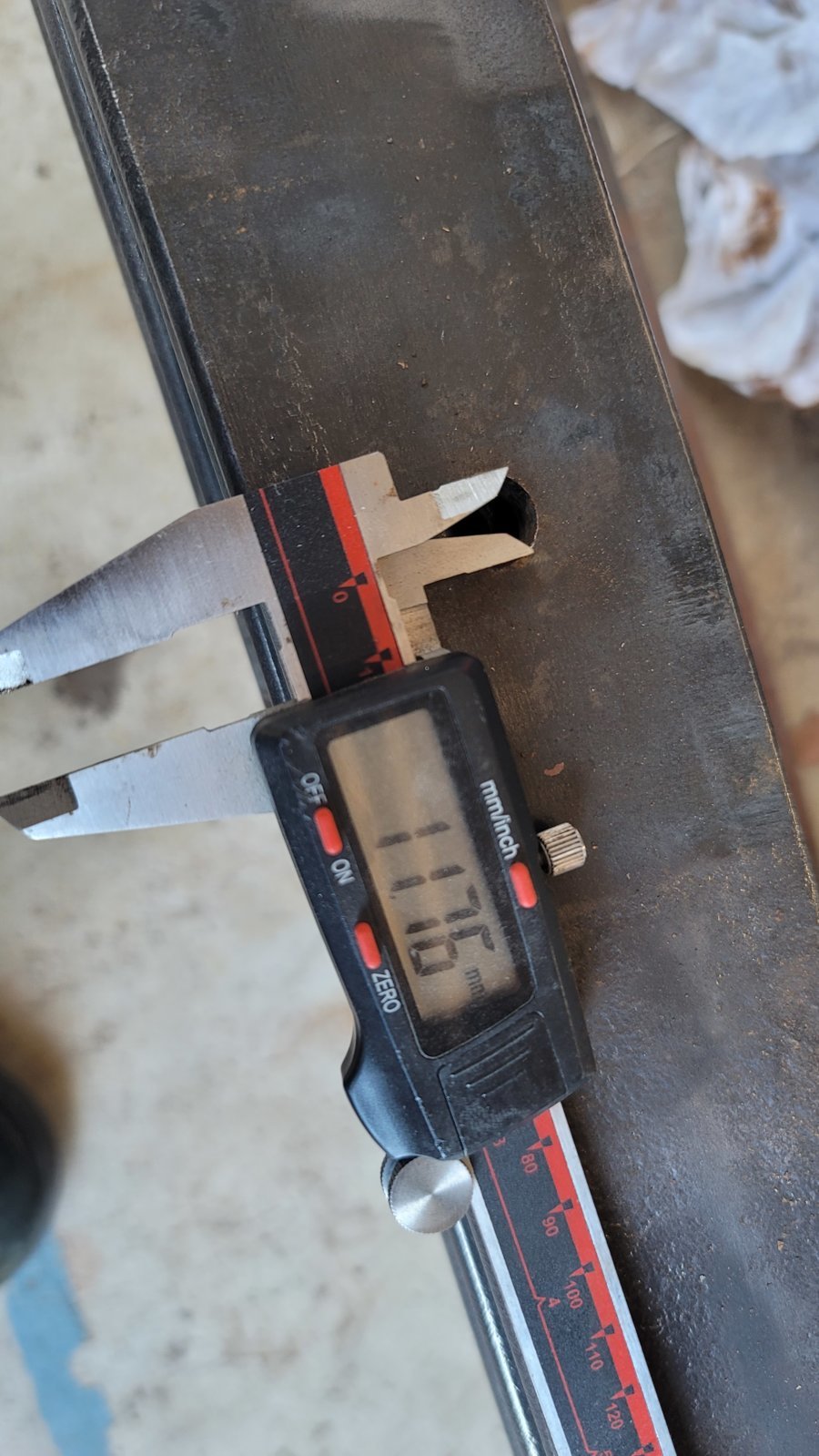

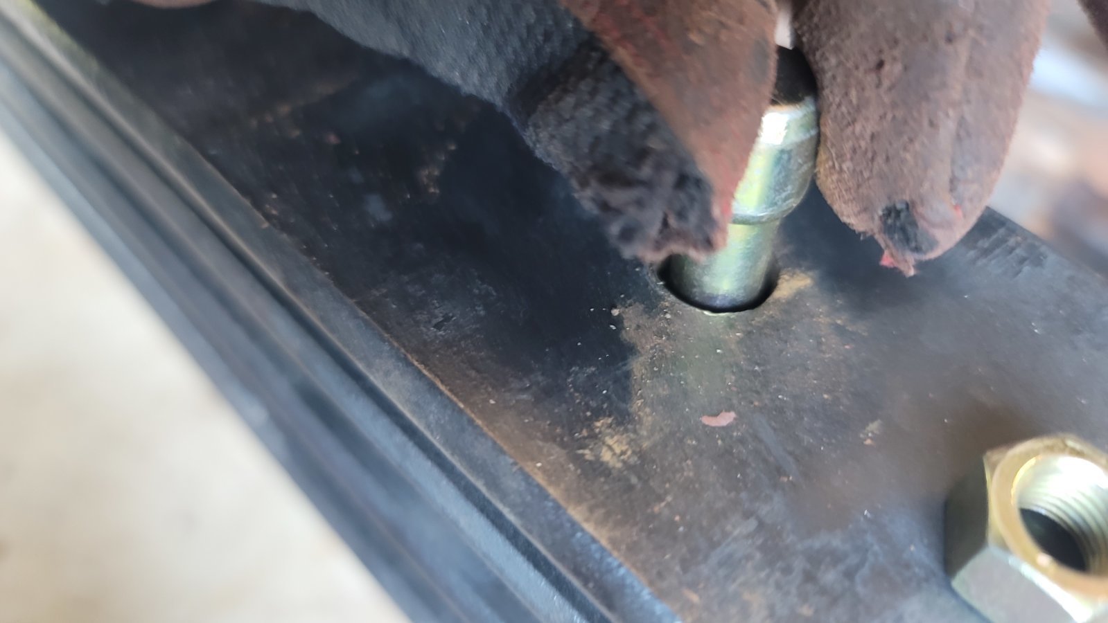

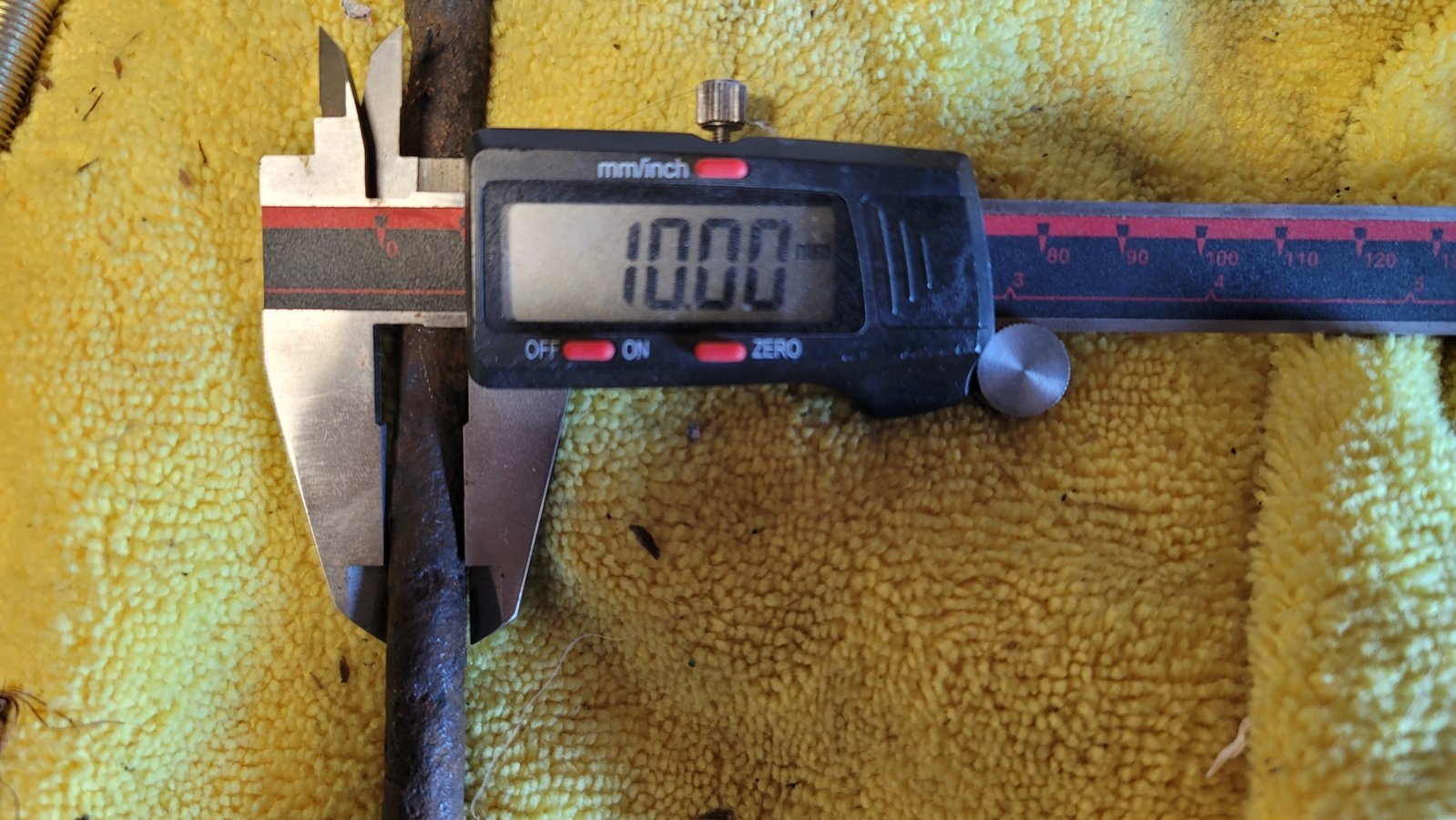

    These center pins you linked above seem a smidge small.
    How did the fit go with your pack?
    Should there be wiggle room?
    20231008_143849.jpg 20231008_144335.jpg 20231008_143834.jpg 20231008_143858.jpg 20231008_143409.jpg

  20. Oct 11, 2023 at 9:21 AM
    #80
    Speedytech7
    Feb 20, 2014
    #123587
    58,149
    FCQM+VG Cheney, Washington
    It's less Tacoma and more mod
    I got the 3/8" center pins from Oriellys, can just ask for them by name, they have em in the back. Yours look like they may have had 1/2 center pins which are uncommon and won't fit in the axle perches.
