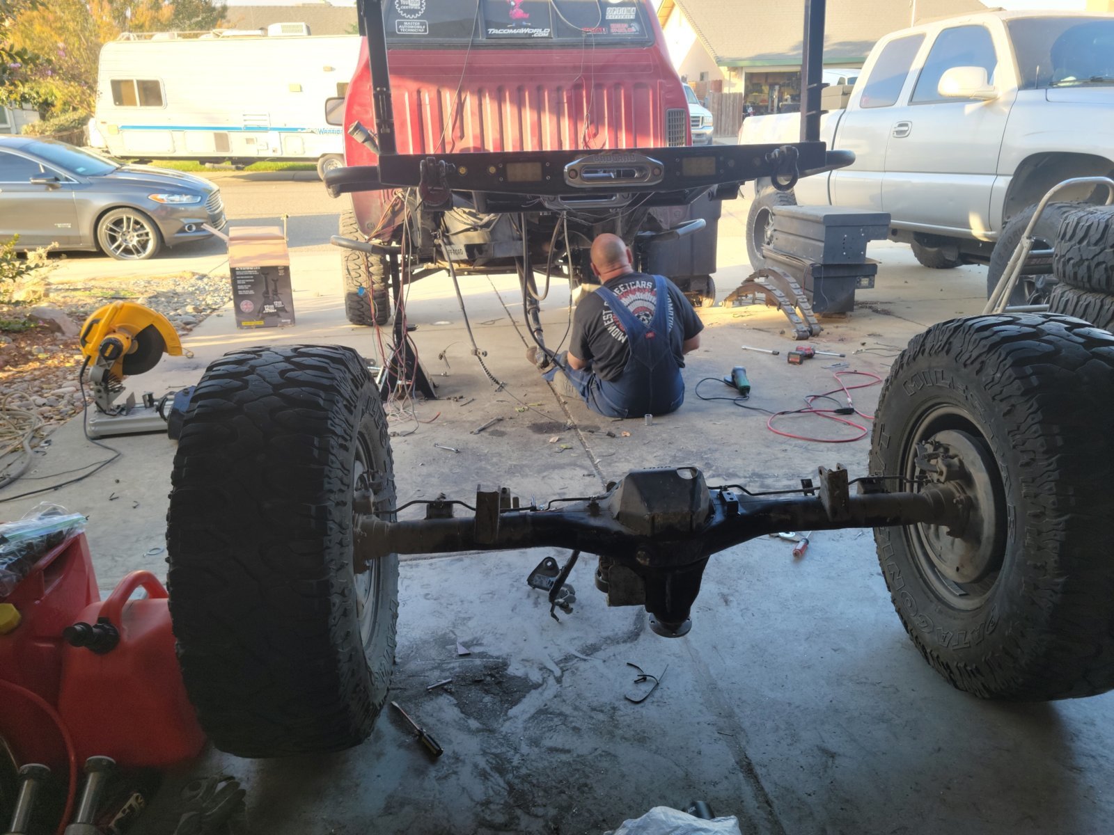

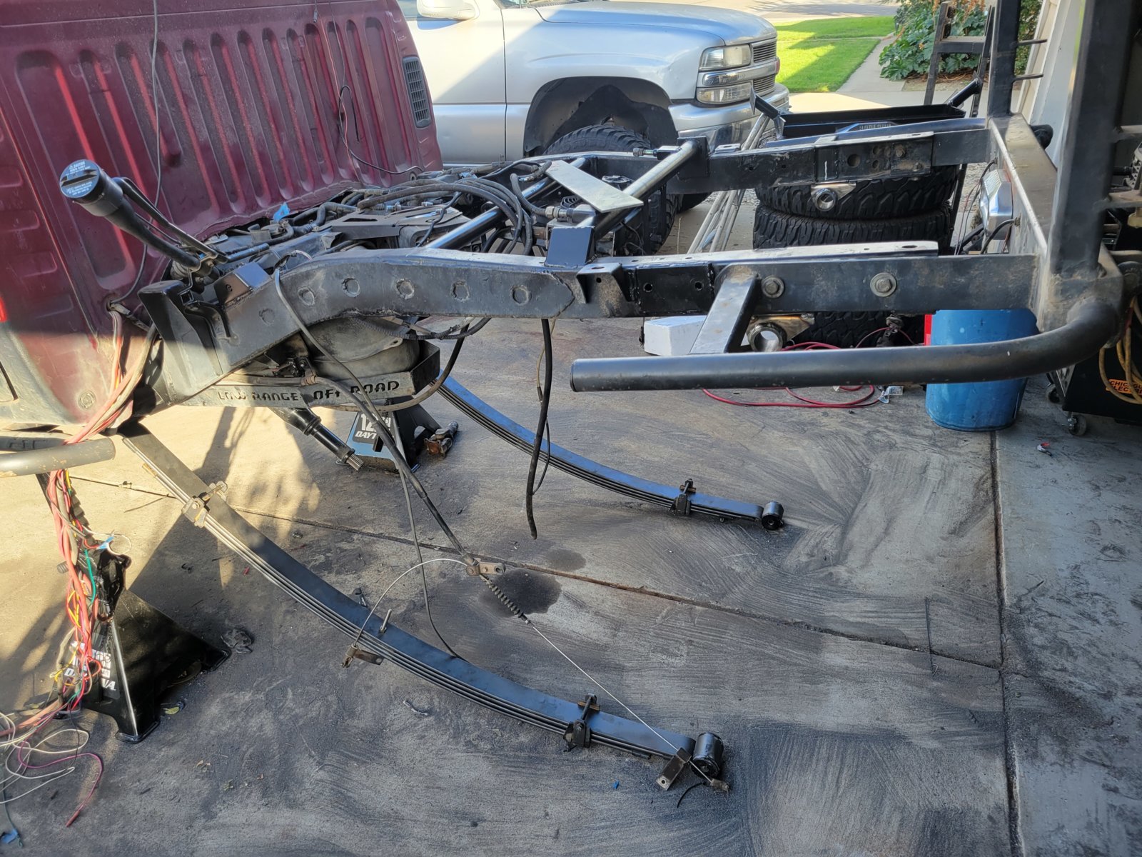

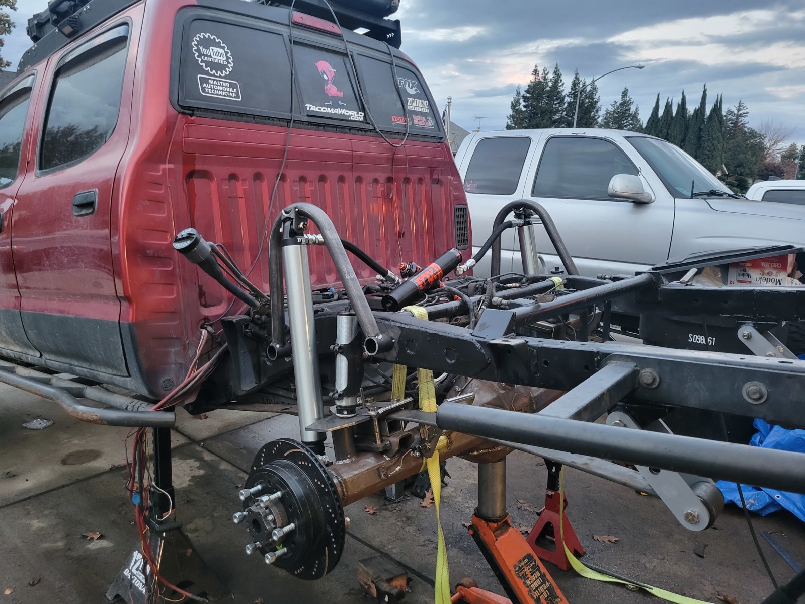

    Cut all the perches out.
    Tacked in the rear perches and started hanging the leafs.
    Out with the old
    About ready to be in with the new.

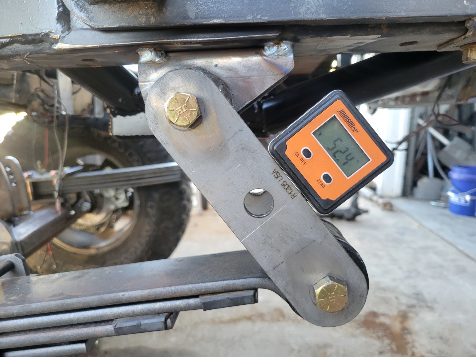

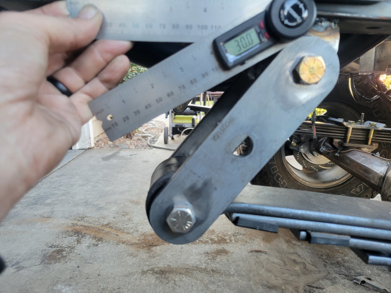

    So, they didn't sag at all. And with this "full load" on the truck I still have a little over 1/2 inch more between center of axle to bottom of frame. That says my ride height is really, pretty much where I want it.

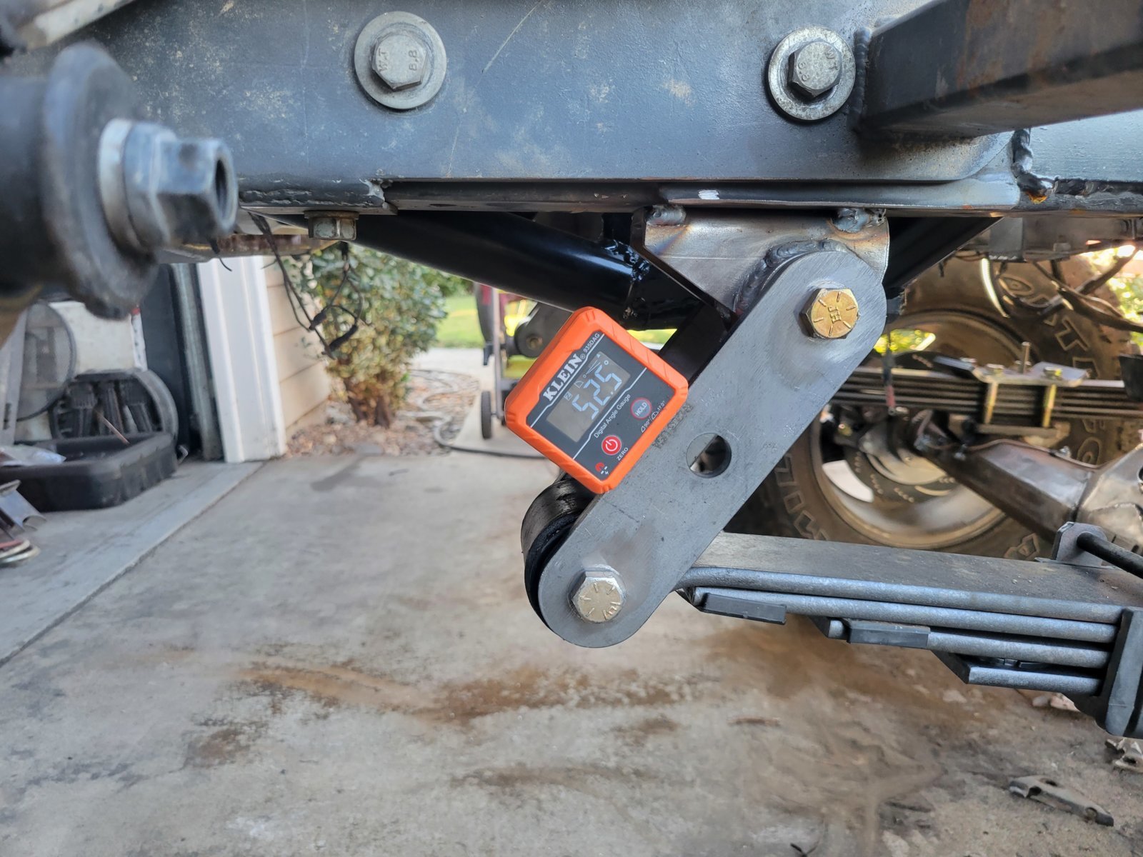

    Now, for shackle angle. I'm reading in a bunch of places that with 63s you want around 30°.
    I thought my shackle angles looked good, but now that I have an angle finder on them it's saying I'm not close to 30°.
    I'd have to be at this angle to be at 30°
    Damn... that's a really shallow shackle angle.
    @Speedytech7 what angle are you running on your shackles? Are you happy with them?

    So... with as flat as these things are at ride height... is up travel just not a thing with 63s or do people just bump them at negative arch?

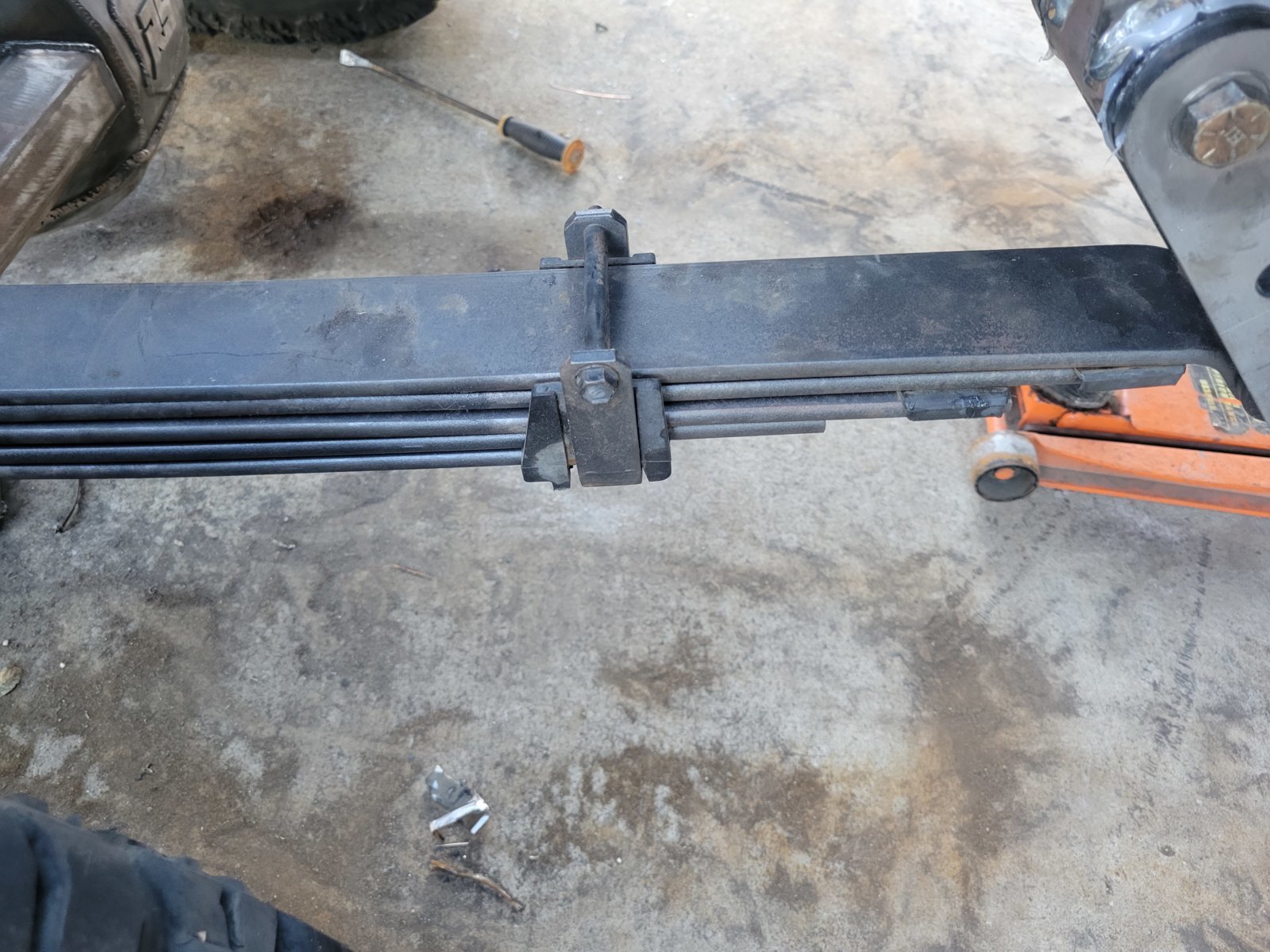

    How bout these bolts? They significantly reduce droop. Are people running these? Removing these? Modifying them ?

    Aren't those riveted to the bottom leaf on your pack?

    The bracket is. I'm talking about just running them without the bolt. (Leaving the bracket in place). Or welding some flat stock on them to raise up the bolt to give me droop.

    oh, interesting. Mine are flipped and it bolts to the bottom.
    Would it mess with the steel if you welded to them or heated them up? Thinking i might want to reverse mine to reflect yours (without having to go pull another pair of packs)

    I'd be welding on those brackets, not the leaf it's self. Heating the leafs like that would probably make the leaf brittle.

    Kind of what i figured as well. Looks like i might wind up going your route and modifying or extending that bracket. My alcans currently have a bit of space on them.

    With some thinking you should be able to come up with a design the boxes the shackles and allows them to flex as needed but to just slide over any rocks that they could easily catch on.

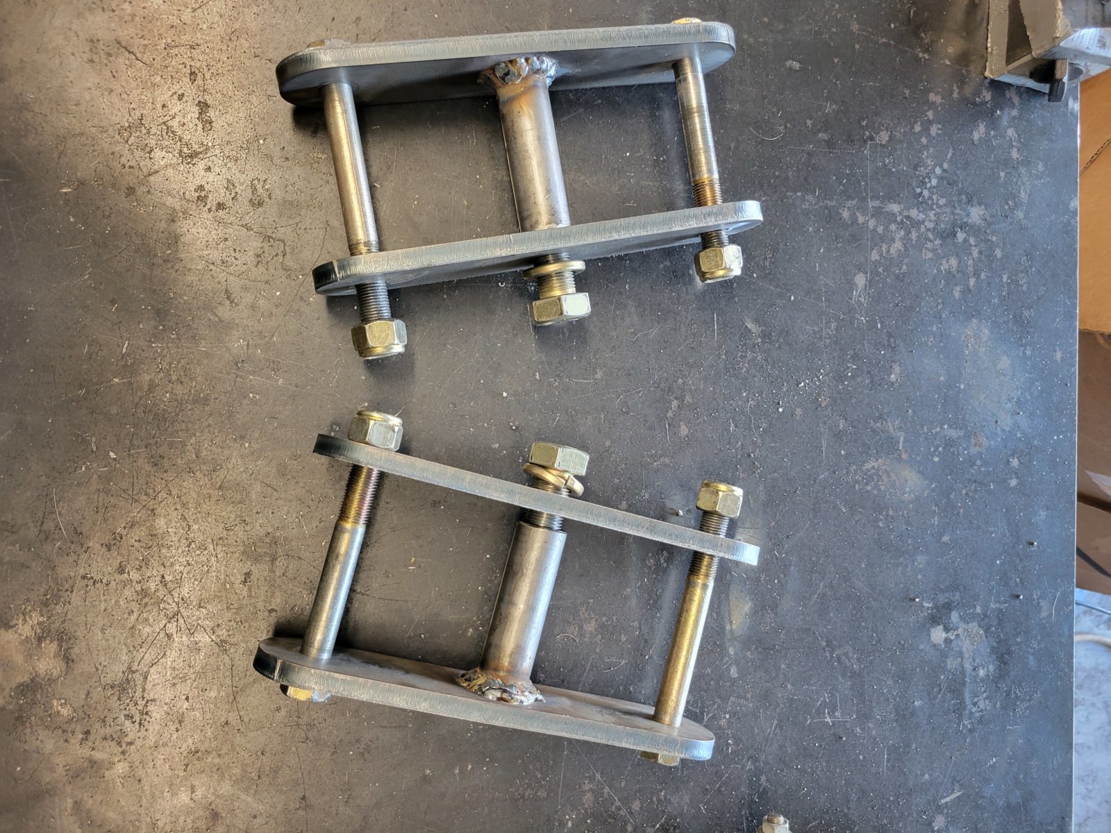

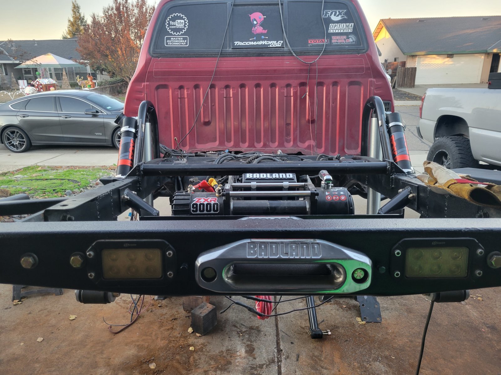

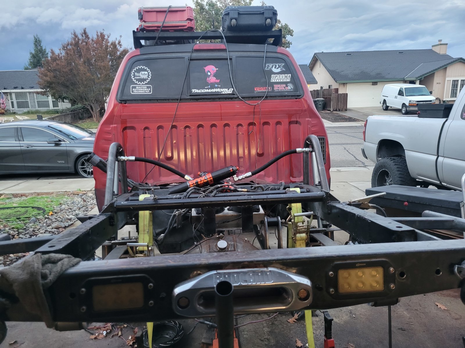

    Figured I'd update this thread a bit.
    Ended up changing the shackle length again. Going with a 7 inch shackle at about 35° at ride height.
    I added a center tube to stiffen up the shackles, and also space them out so I don't over tighten on the bushings. (I've read a lot of people end up over tightening the shackles and bind their travel a bit.
    The 7 inch shackles get close the straight up and down at full droop, which gives me a bit more droop (over the 5 or 6 inch shackles).
    erice likes this.

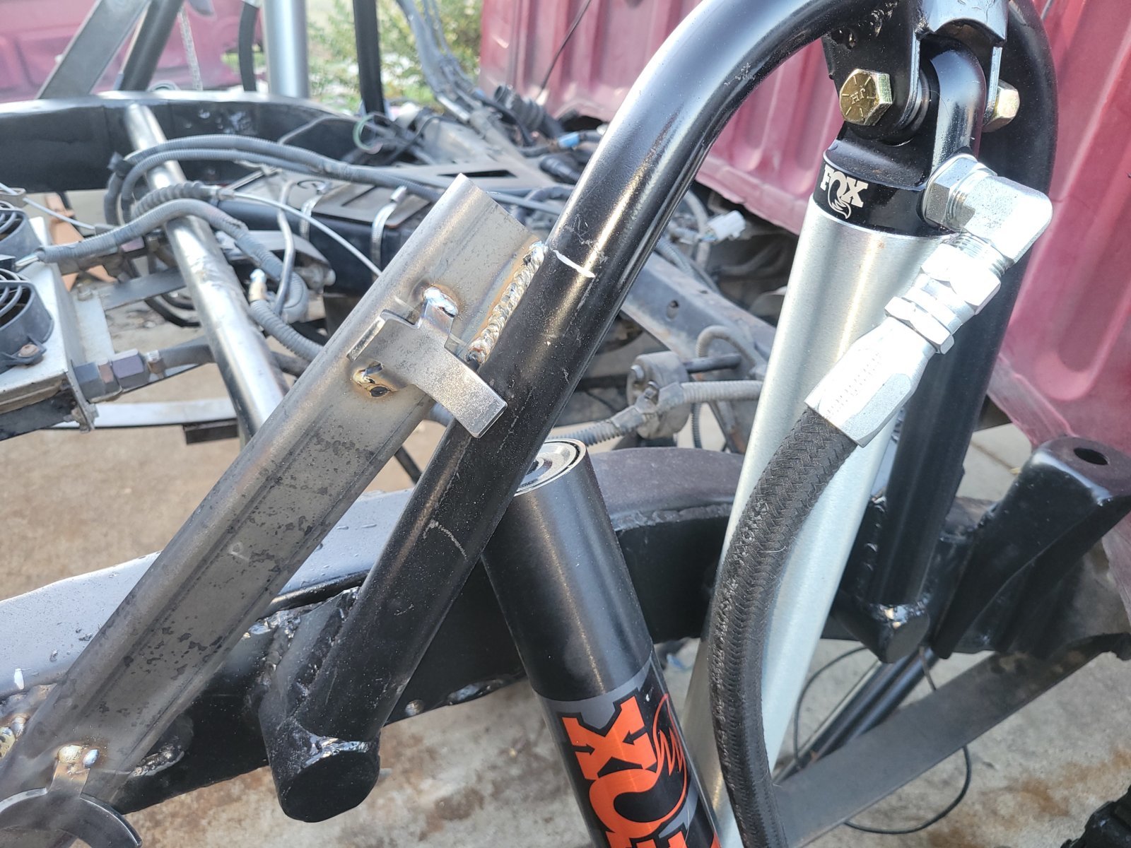

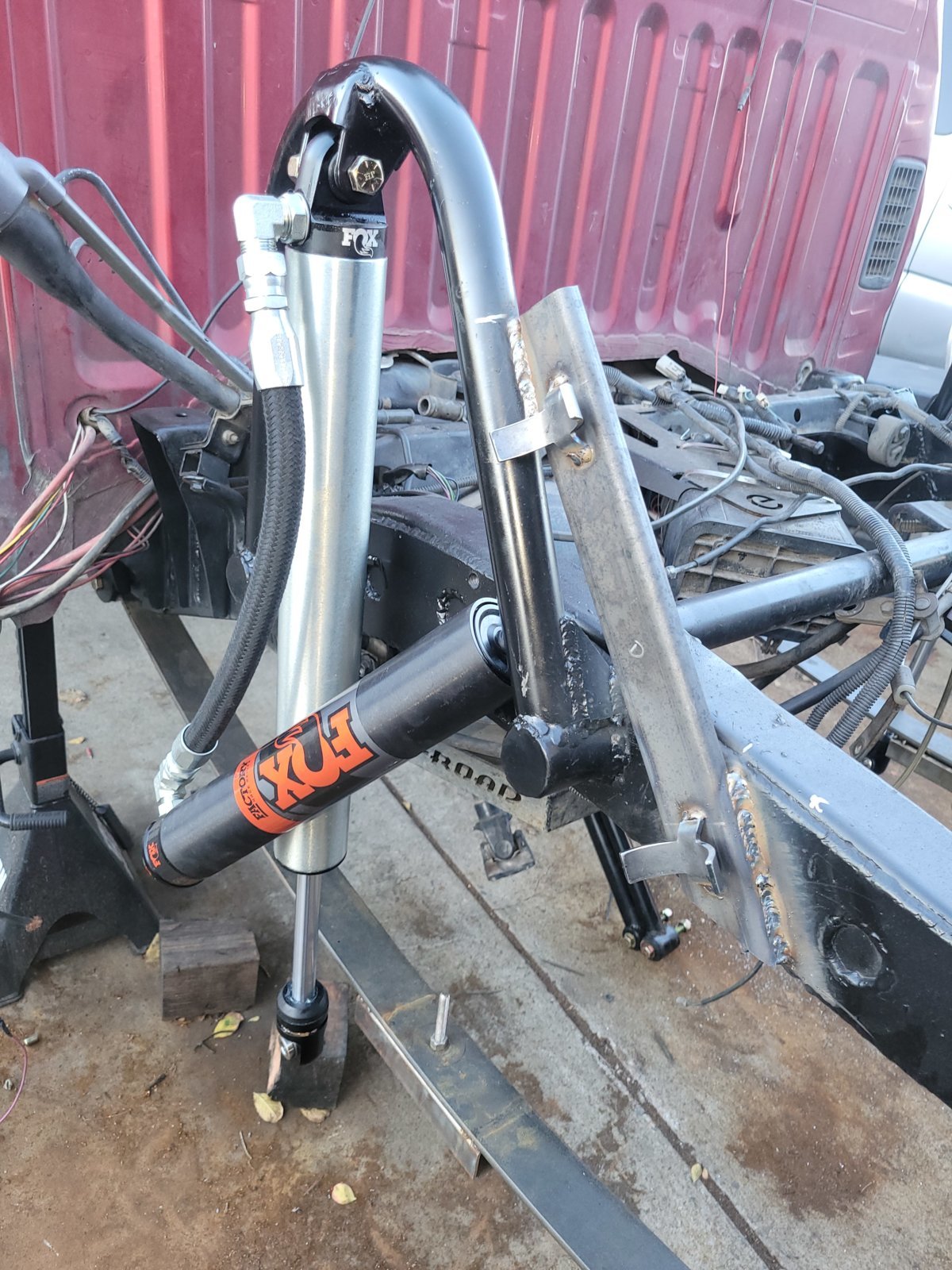

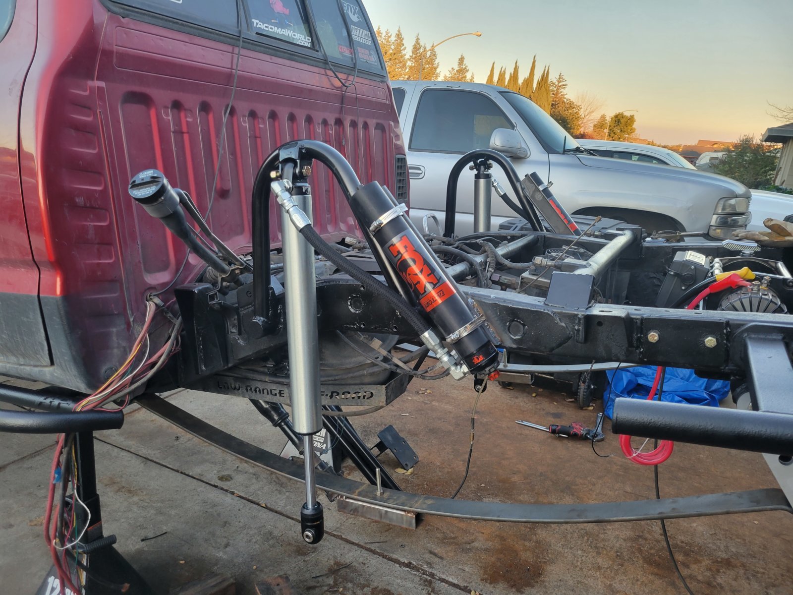

    I fitted up the shocks. (FOX 2.5 - 14 inch)
    Had to order elbows so I could route the resis the way I want them.

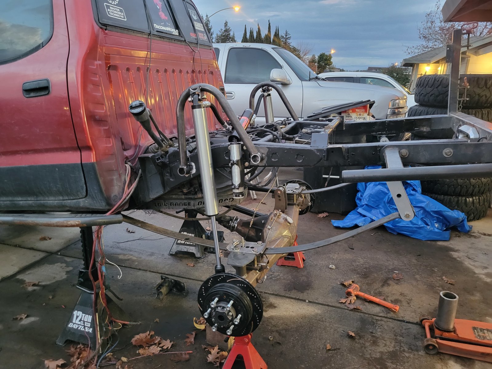

    20231124_161452.jpg 20231124_161512.jpg 20231124_163153.jpg 20231124_163203.jpg
    The elbows arrived so I could fit up the resi mounting brackets.
