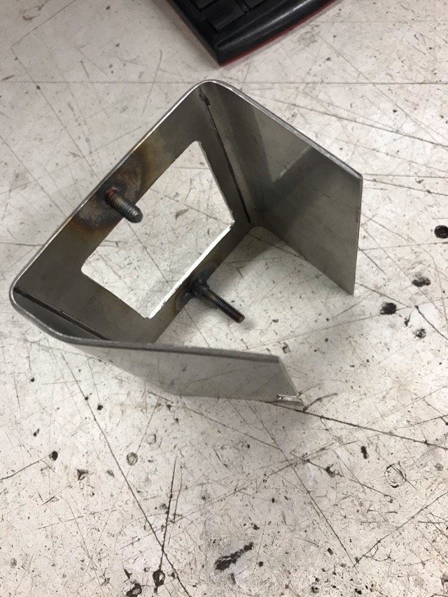

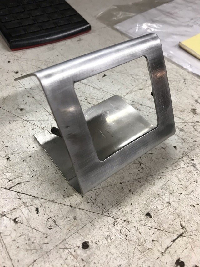

    I am tired of not being able to see the factory clock since the steering wheel is in the way. I don't really want to move the steering wheel so thought I would try and move the clock. I started building a stainless steel holder for the clock.

    What are your plans for it?

    I am gonna move it to in front of the gear shift, no I haven't seen any of the other threads on it.

    Got the hole cut and studs welded on.

    Looks damn near professionally made. I bet you could start selling these.

    How did you weld the stud so perfectly? I don’t even see a puddle.

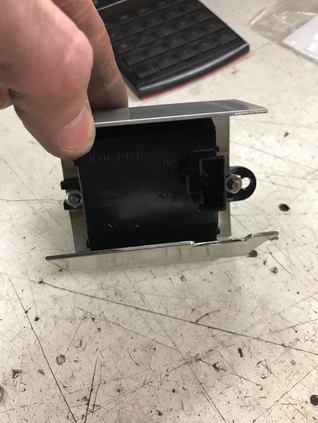

    The short one I drilled and tapped the plate, welded it then ground it off. The other is just a socket head bolt welded to the inside. I have to make the sides and weld them on next. I've got a lot of grinding and polishing to do as well.

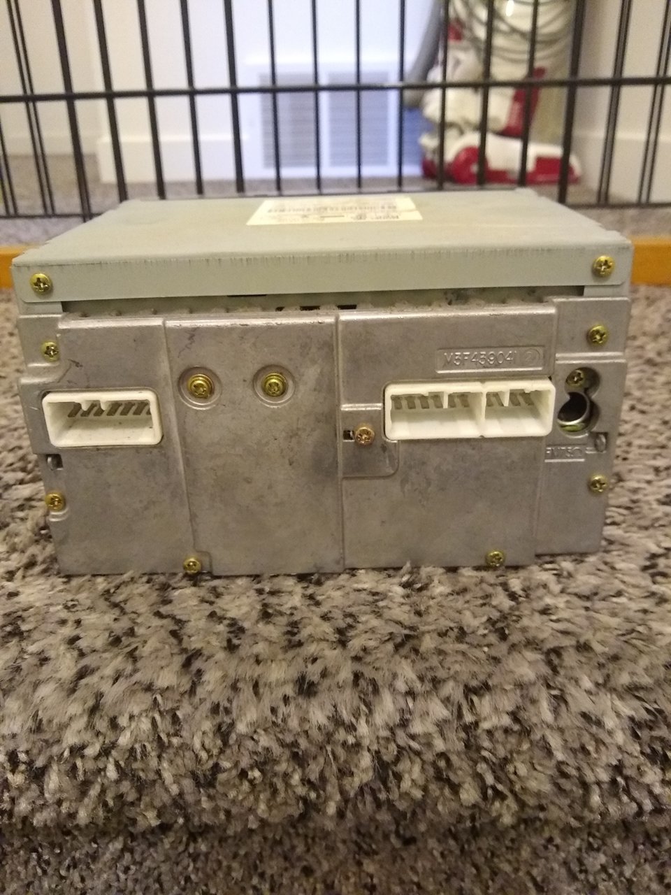

    Yeah the solder joints start to seperate. Dude on ebay I think sells them for 50 bucks and you send him your core.
    I wouldn't pay anything for one or to fix but if I got bored enough I might pull the clock and resolder those connections. Prolly just needs a drop added in a couple spots. But there are plenty of other ways to get the time:cool:
    Look what I grabbed out of storage :D
