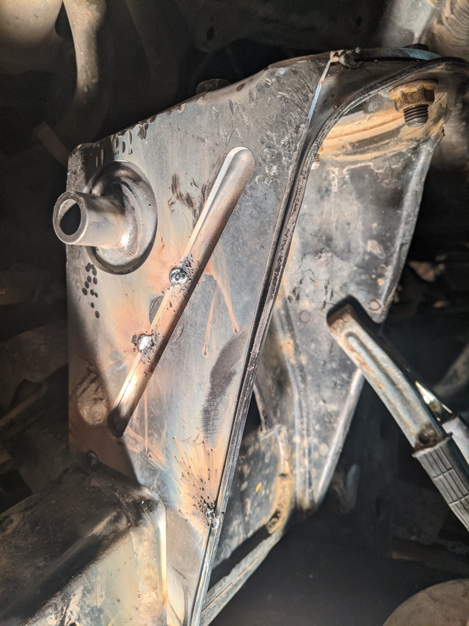

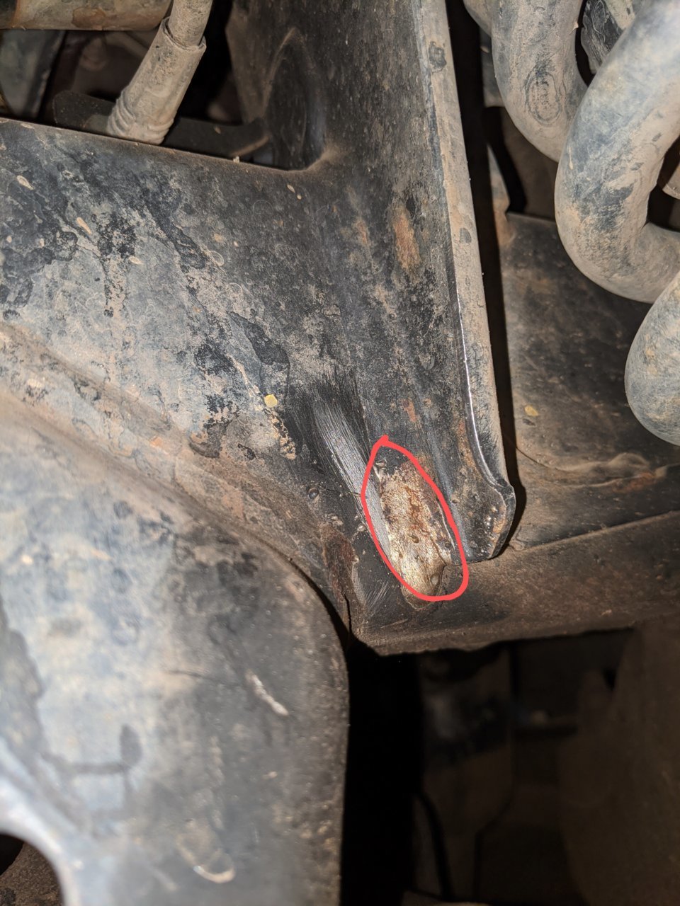

    Looking for 5 individuals to give feedback on the fitment of these before officially releasing them. They will be sold to you at what it costs me to have them cut, around $125. This will increase once I'm confident fitment is correct. I've only had the chance to install them on my truck and @m3bassman has a set and has taken a slightly different approach to my design.
    Problem

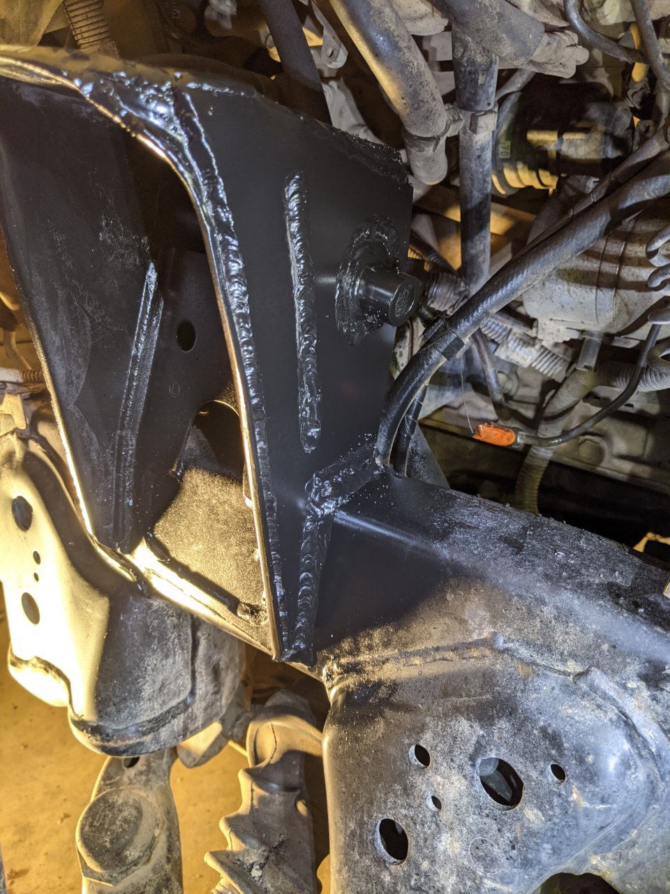

    Solution

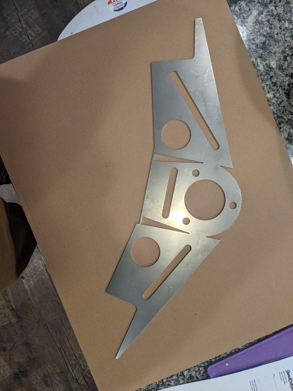

    They are made from 10 gauge mild steel and will be shipped flat, straight from the laser cutter to your door.
    Tools:
    Welder
    Grinder
    Wire wheel
    Dremel or 2" die grinder with cutoff wheel.
    10mm flare wrench
    14mm
    19mm
    C clamp
    Hammer

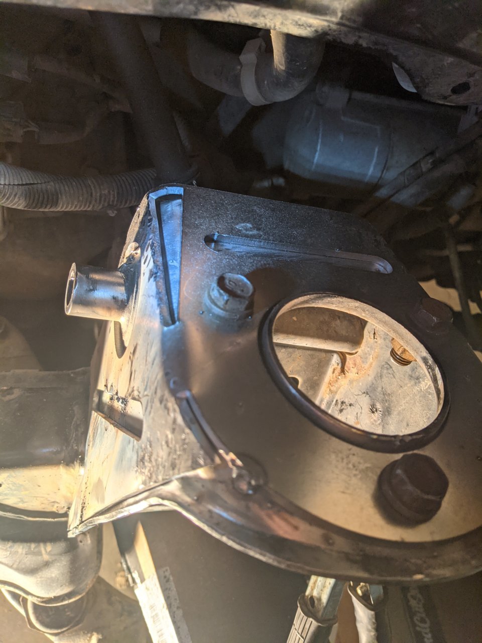

    Instructions:
    1. Remove coilover.
    2. Disconnect UBJ from UCA, remove the UCA
    3. Disconnect brake line at the L bracket.
    4. Cut off L bracket at the welds. This will be welded back over the gussets when done.
    5. Prep coilbucket for welding.
    6. Bend gussets to approximately 45° on a bench. Line the edge of the bench up with the tangent of the semi circle and the center of the bridge. Make sure you have the correct orientation and not upside down. The longer leg goes to the front of the truck.
    7. Set gusset on top of the coilbucket and use 3 bolts to cinch the top down flush. Manipulating the "legs" may be necessary to get past the frame while tightening the bolts.
    8. Bend the legs the rest of the way. Use a C-clamp and hammer to close up any gaps.
    9. Tac weld all around the weld it up.
    10. Weld brake line L bracket back on.
    11. Paint and reinstall UCA, coilover and brakeline.

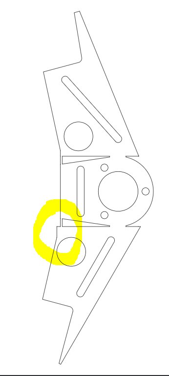

    If for some reason your bucket is wider or you would just like an easier install these can be cut into 3 pieces and welded from there. So far, a regular cab had a wider bucket.
    The passenger side has the difference on it. Oddly Toyota did not seem to make an exact mirror from side to side of the manufacturing tolerances are pretty loose.
    PXL_20210206_015929969.jpg PXL_20210206_015914091.jpg PXL_20210206_014434272.jpg
    First 5 to comment below saying they are interested gets one of these spots. The usual turn around time is a week from the time the order is confirmed with the laser cutter to them showing up at your door.
    Orders
    1. @Jiveydude - In Progress
    2. @jubei - Ordered
    3. @drr - Complete
    4. @robblacktpre03 Ordered
    5. @ToyotaDriver Received
    Note:
    *Modifications will likely need to be made to fit with the Total Chaos gussets.
    **Will not fit 3rd Gen 4runner (The bolt holes are clocked differently.)
    Disclaimer: I am not to be held responsible for modifications you choose to do to your vehicle, do at your own risk.
