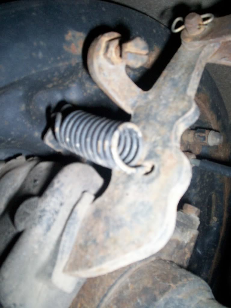

    Wait. I remember one now that it's gettin into the teens here in sc.
    My emergency brake light stays on for quite some time when it's really cold. Anyone else have this?

    My 98 did this. It was the clevis on the driverside rear drum. I removed it, cleaned the rust up and re-installed. It was fine ever since.

    Whats a TC? And I cleaned everything up when I did my powertrax install. It's still doing it. I just turned 75k, replaced the front brakes about 2k ago. Maybe it just needs adjusted.

    Definitely got the brake light thing going on, any further info you can give to fix it, I didn't understand your brief description.

    This piece here. Remove the boot and you will find a pin that holds it in. Drive the pin out and remove the clevis. They are two disimilar metals (aluminum vs. steel) which caused the rust from the steel to bound with the aluminum. I sanded both surfaces. applied white lithium grease and reassembled.
    Cmack had a similar issue, butit was the spring that was seized. I will see if he can chime in.
