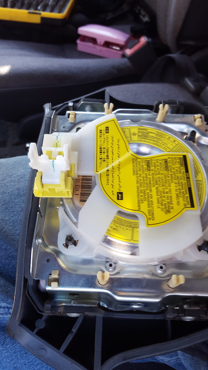

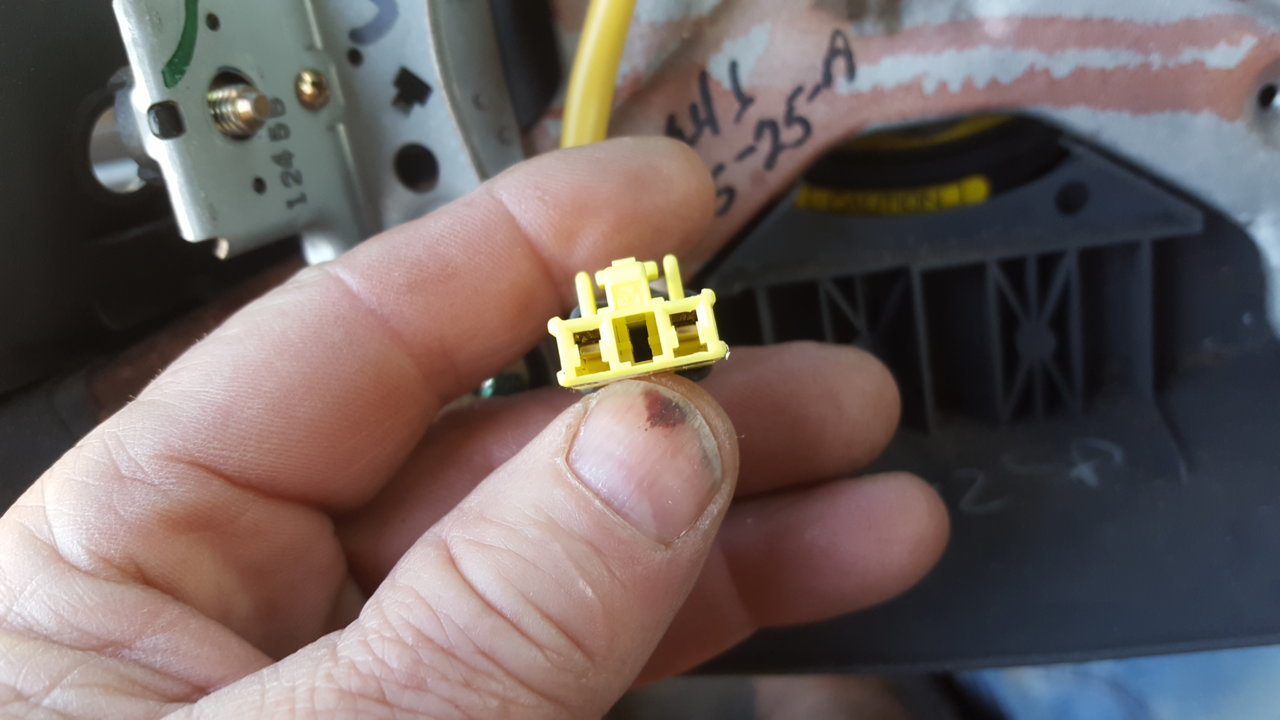

    HOWEVER, the airbag squibs and charges did change. We will have the single stage airbag charge which Toyota phased out in the early 2000’s. As long as you match the airbag plug to the clockspring it’ll work.

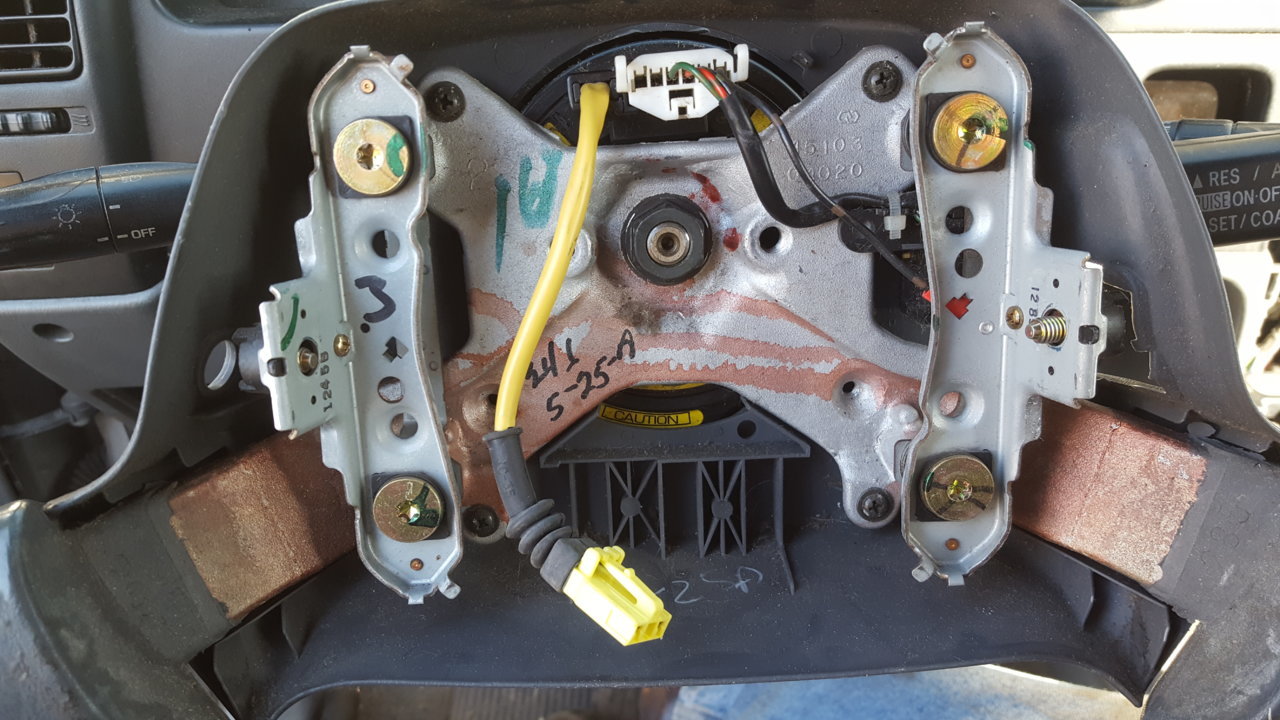

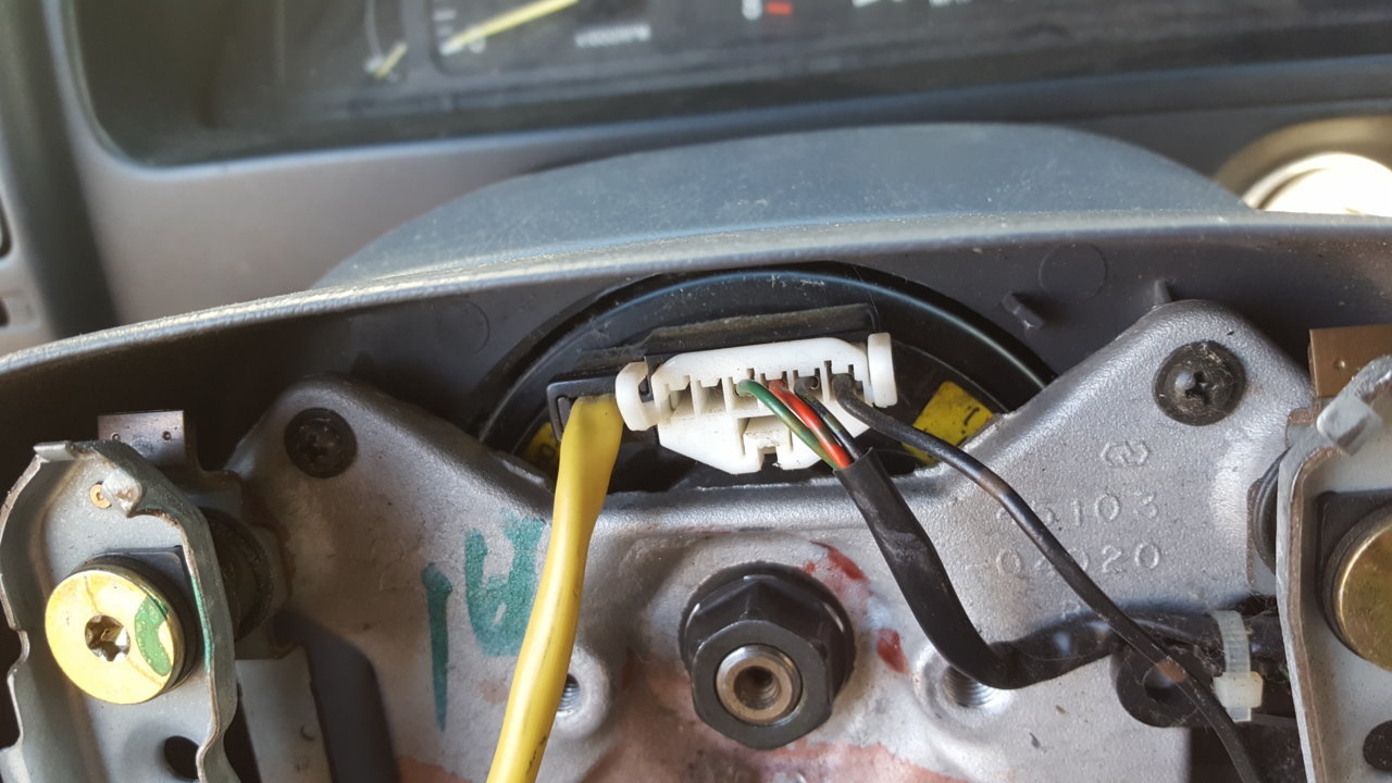

    FYI, had the wheel off one of the 95s, so I took a few pics for you.
    You can see the part number in the upper RH corner 45103-04020. This is with cruise. Edit: nut is 19mm.

    Anyone hip to switching out this CC to a later 4 spoke w/o radio controls?
    I'm getting to think the difference is in the column, not at these plugs.
    I really thought since I had essentially 2 '99s (Taco is 2000 but wheel clearly says '99) I was plug and play. Air bags seem fine.
