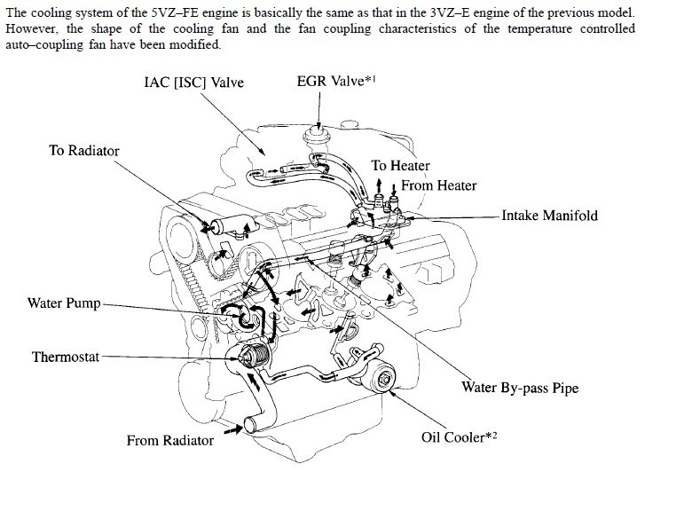

    It is on the very back of the Cylinder Head. It is a PITA to get to with the engine installed. The other sensor (single pin) is indeed in the water outlet pipe on Passenger Side Cylinder head and hose connects to the top inlet of the radiator. Sorry for the picture being off-centered. It was taken of the coolant lines/Intake side as I put the harness back on before dropping in the truck.

    Thanks for the pic man! This helps! Would it be easier to get to it from the top or bottom of the engine since its soo close to the firewall?

    Going from the bottom would be quite the chore im sure...

    Top passenger side is your only option if you don't want to pull the head. Definitely remove/move both of the heater core hoses to give you some space. you could remove the wiring harness from the cab and lay it on the block as well, but it probably isn't necessary.
