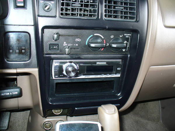

    Is the dash different in a 01-04 from a 2000? I can get a pic of my 00 dash with my Pioneer HU in it.

    You have to use the OEM brackets that are attached to the OEM stereo, you actually screw the bracket to the plastic sorage bin and the stereo so it becomes one unit. Very easy install.

    So you are done installing everything? Looks nice

    Yep, all done with the installation, I did it a few months back. It came out great, minus the fingerprints and smudges all over everything in the pic...
    Word of advice if you do a speaker replacement... When replacing the door speakers, you will have to get spacers for the speakers or the magnets will hit the window tracks. I bought my Infinity speakers from Crutchfield and they gave me the adapters free. The rear speakers are really easy, and require no spacers.

    Looks good. Thanks for posting.
