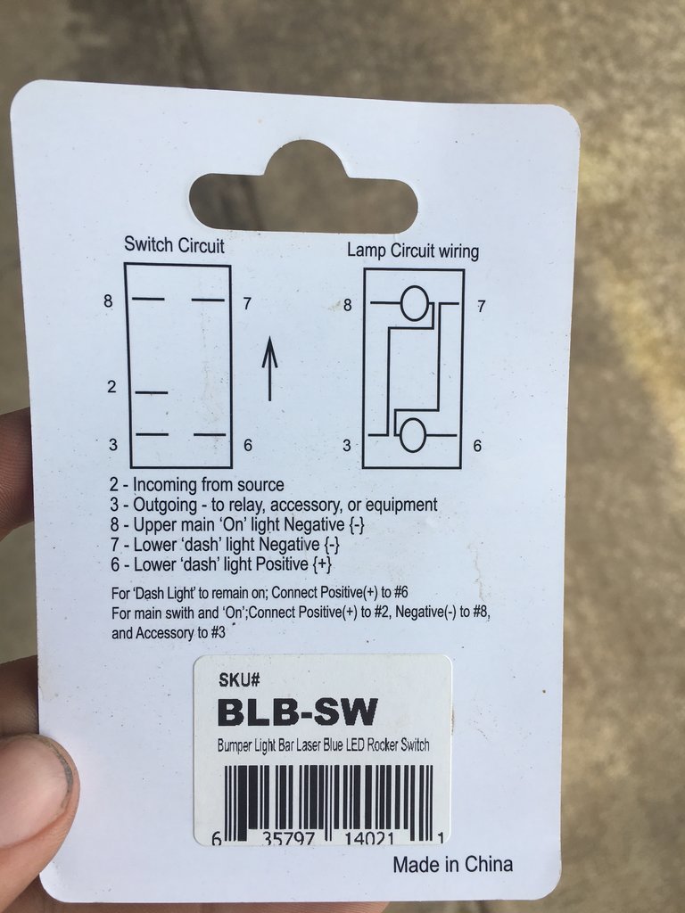

  17. Jul 9, 2017 at 7:33 PM
    #17
    MAUIAUSTIN
    MAUIAUSTIN [OP] Well-Known Member
    May 27, 2016
    #188067
    90
    Austin
    Maui, Hawaii
    1995 Ext. Cab 4x4 SR5
    Sway A Way 2.5 Coilovers JBA Upper Control Arms Old Man Emu CS019R Leaf Springs Old Man Emu Stock Length Greasable Shackles 10" Travel Bilstein 5125 17" DX4 Terrain Wheels 265/70 R17 Falken Wildpeak AT3
    Here's the diagram it came with
  18. Jul 9, 2017 at 7:34 PM
    #18
    MAUIAUSTIN
    May 27, 2016
    #188067
    90
    Austin
    Maui, Hawaii
    By intups you mean the positives?

  20. Jul 10, 2017 at 1:17 AM
    #20
    RysiuM
    RysiuM Well-Known Member
    Oct 18, 2015
    #167004
    2,709
    Rysiu
    Was Golden State, now Poland EU
    1995 4x4 LX Ext Cab, I4 2.7, MT, 335K miles
    DD Deck+backup camera, LED DRL, All LED except H4 Hella
    Thanks for the diagram. So you need to connect:
    6 - green/red from rheostat
    7 - green/white from rheostat (for lower Led to dim). Or ground for lower Led not to dim)
    2 - battery + (fused of course)
    3 - accessory in (relay coil plus)
    8 - ground (upper Led not dimmable)
    Might work or not if 8 connected to rheostat green/white for upper led to be dimmable.
