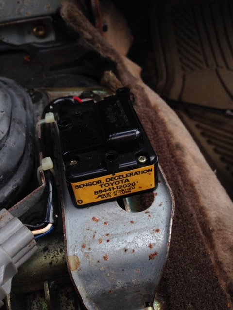

    Anybody figure out where this sensor is and can share a description or picture?

    Looks like it's under the center bezel just to the right of the shifter, found a thread here about it.
    imageuploadedbyih8mud-forum1418510696-71_0c10749e5efb7d9f6acc777dbf0065cbff1e7e0b.jpg
