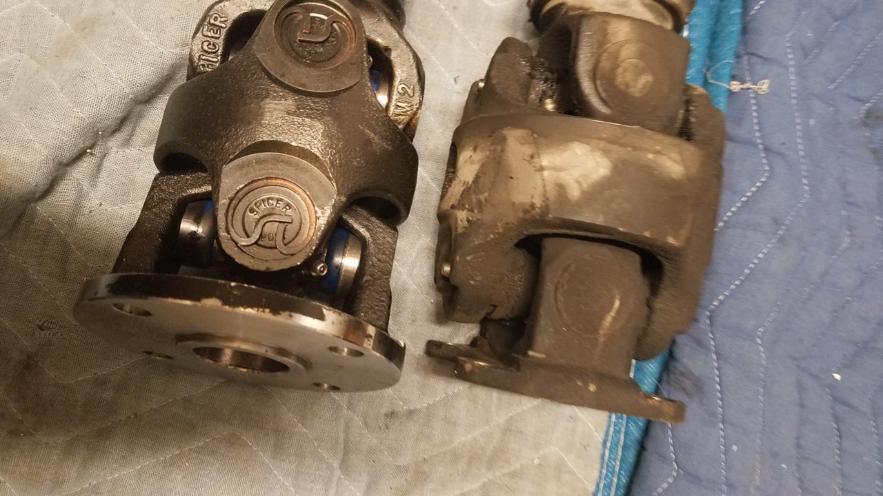

    Anyone know of a 1st gen 3.4l 4x4 u-joint DIY guide? Or anyone have some tips? Is there an order to disassembling the 2 u joints at the transmission? I’m having trouble getting it all apart:frusty:

    Toyota didn’t make these Double Cardon Joints to be rebuilt. Even if you get it apart it will
    be a problem to balance because of the design. Your better off having a drive shaft company install
    a Spicer Double Cardon Joint that is designed to be rebuilt if needed to your driveshaft or get a completely new driveshaft with Spicer components.
    Depending on the miles your splines might be worn out too and be better to buy
    a completely new shaft.

    I bought a new one from that website and I'm totally happy with it, Spicer U joints are all replaceable no issues

    thanks for the tip, just ordered a new driveshaft from there, now I will be able to replace all the joints!

    This will what the new joint will look like and is actually a little bit beefier

    Absolutely, mine was 480.00 shipped, a heck of a deal for everything “NEW”

    Hey do I need to put this new driveshaft on any certain kind of way for balancing or anything?
    I assume I just bolt her on and maybe I’ll need to take her somewhere to have it balanced on the truck?

    It’s pre balanced, all you need is to bolt it in, nothing else.
    I have zero issues and zero vibrations all the way up the speedo
