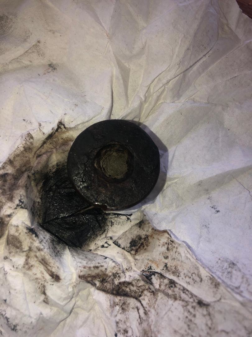

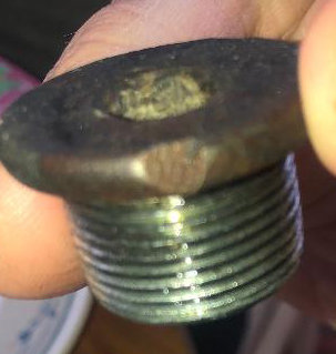

    This video covers what you need. In the video description there's a list of times so you can jump to the area of the video you want. The video was done on a 3rd Gen 4runner but it's the same as a 1st Gen Tacoma. Be careful with the front differential drain plug. They are known to get really locked on there. If you find that the 10mm allen head plug is fighting you, don't strip it. Apply some heat with a butane torch and try again. If you have to resort to a 2 foot long breaker bar, there's a good chance you're going to strip the head of the plug. Keep applying more heat until you can break it free with no more than an 18 inch breaker bar or ratchet.
    https://www.youtube.com/embed/a81i1Cayf_I
    If you didn't heed my warning and end up stripping the front diff drain plug, the video below will give you some ideas of how to get it off.
    https://www.youtube.com/embed/hFnOejt3VIU

    stripped like this at a dealer mechanic :notsure:
    part of a complete 30k mile package!!!
