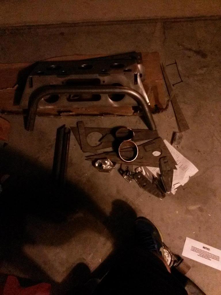

    This pile of steel showed up at my house and the fun begins.

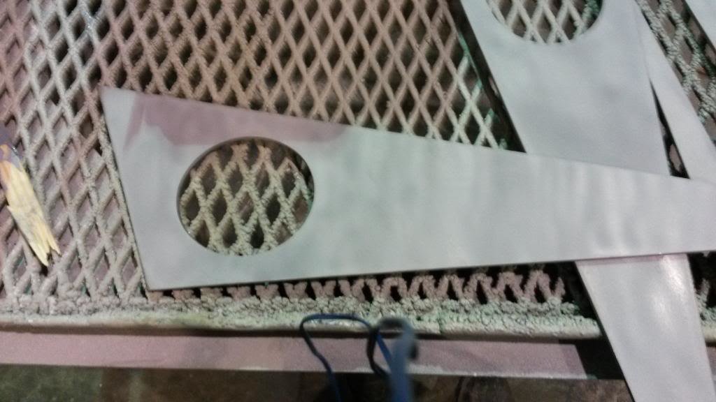

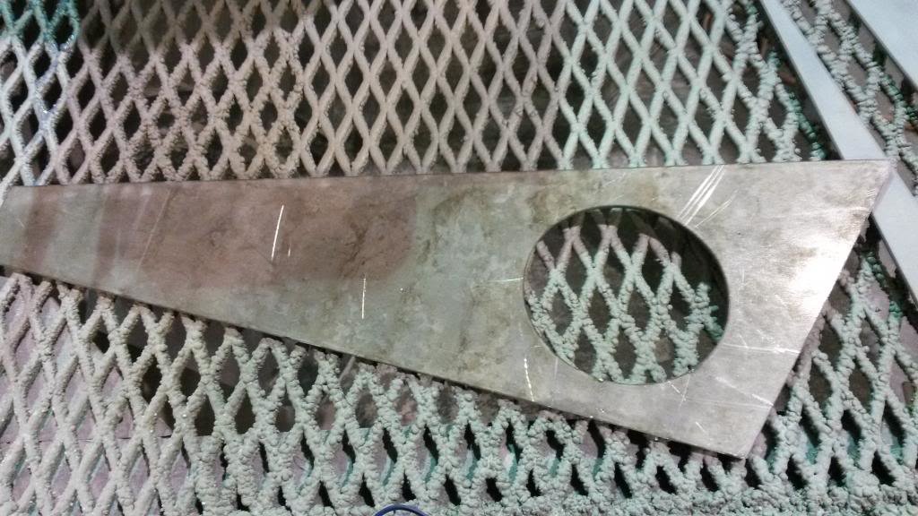

    The first thing I did was sand blasted everything. Its not necessary but I did it beacuse I have access to it and it will make prep before painting easier.
    Before:
    After:

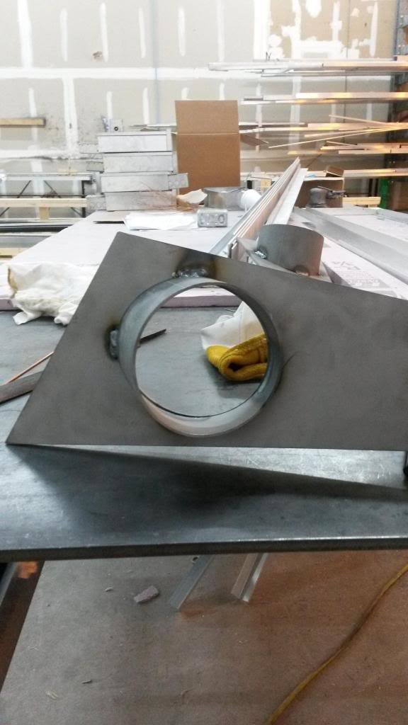

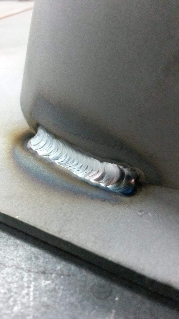

    The next thing I did was weld the fog lights up, its recommend to do it as one of the last things but I wanted to do it while it was laying on the bench.
    Im gonna try and tig as much as i can on this bumper :]

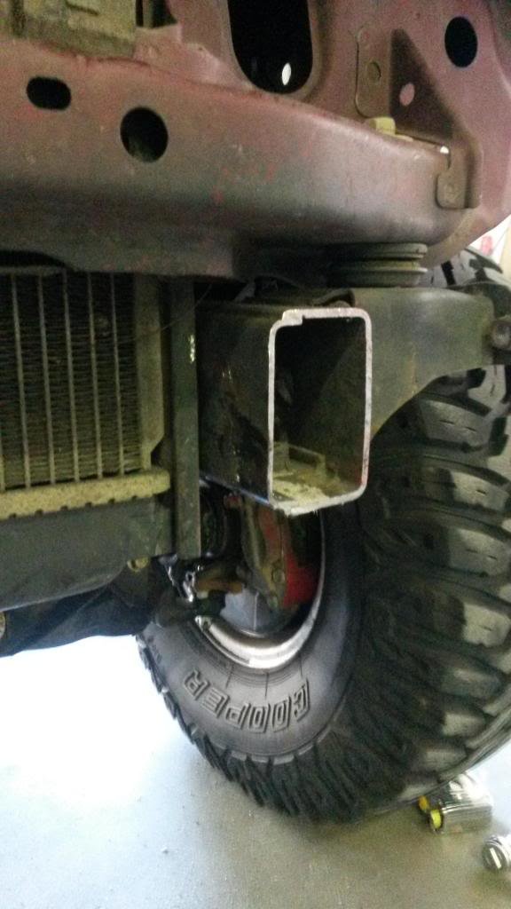

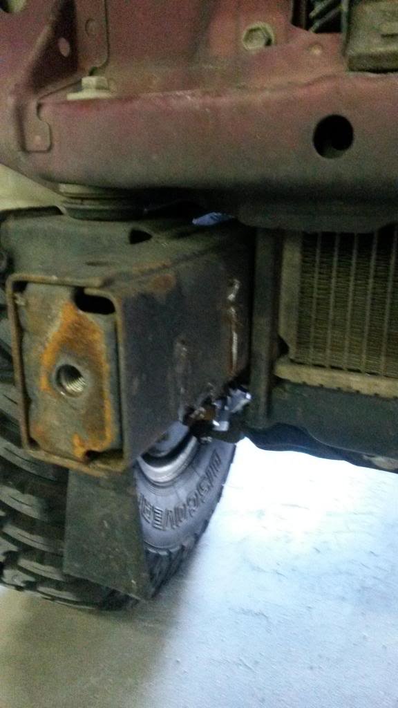

    Next on the list was to prep my frame, keep in mind i have a 98 so i have to cut my frame as well as my skid plate mounts and weld in new mounting plates.
    Took the frame caps off with a 17mm socket and cut the skid plate mount off. be extremely carefully cutting off the skid plate bracket if you are using a reciprocating saw, you dont wanna punch a hole in your radiator. You can see a small gap between the frame and the radiator support, that is where i aimed the end of the saw blade. I used an 8" blade for this but thats all i had and it worked perfect.
    I also cut the front of these things off just so it was easier to cut the frame.
    Measure 3" back from the front and mark your line and start cutting. I used the 8" blade again but i think a 12" would have made it a lot easier to get the saw in there

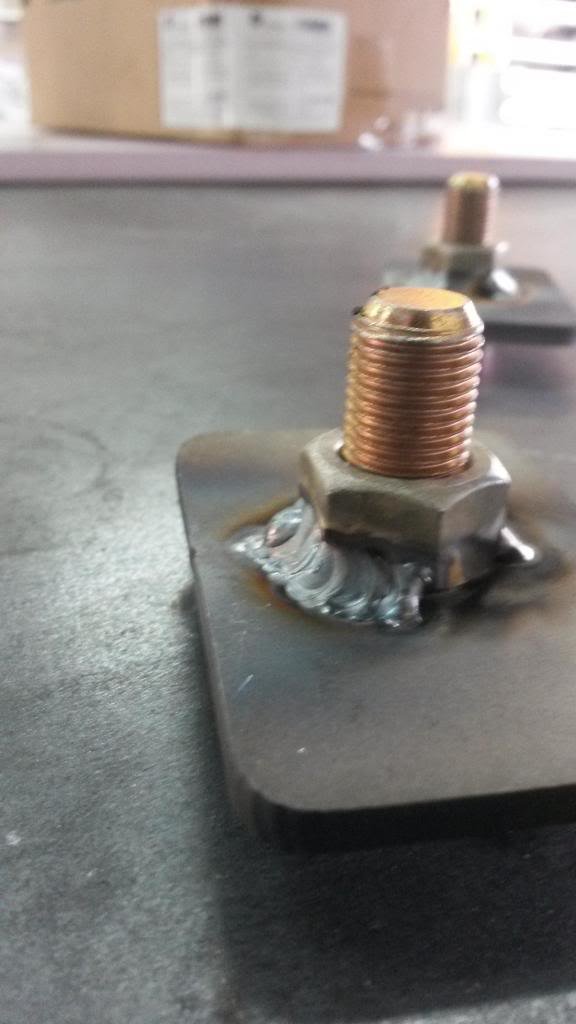

    Then i welded the 1/2"x20 nuts on to the back of the frame plates (98-00 Only)
