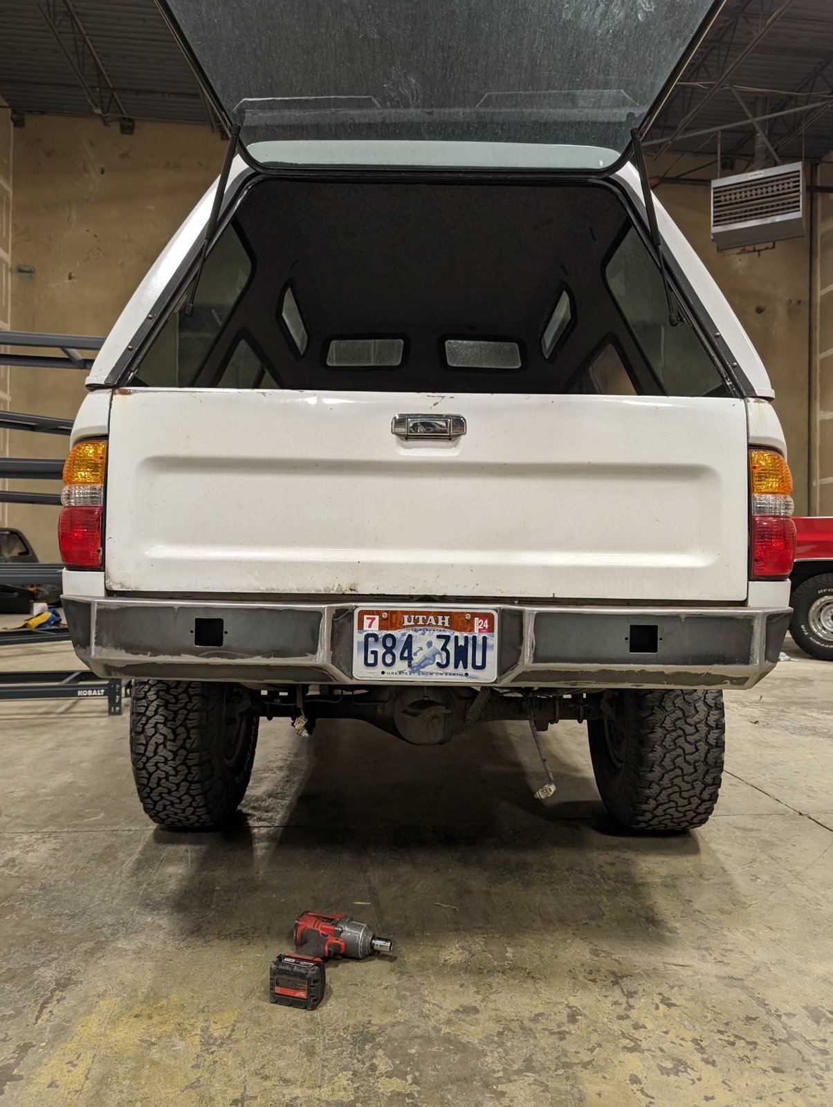

    Hey guys! Here's a little DIY bumper I'm thinking of bringing the market. I'm not a huge fan of the high clearance bumpers that require cutting the sides of your bed. These will be laser cut out of 3\16 hrpo so they will be ready to weld out of the box.
    This is verison one that I will be making changes too, especially cleaning up the sides. I think they will look really good with a swingout as well! I'm really open to ideas or changes so please let me know! Not sure on pricing yet, but it will be the most affordable diy bumper on the market.

    I'd buy one. That looks great

    Looks pretty close to 4x Innovation's with pod cutouts, but I'm all for cheaper!

    Very clean. I like that....a lot....doggone it.

    Looks great!
    All about that DIY. Can you still get the spare tire tool in there? Yours looks tight, when I built mine I barely left room to get the spare tire tool through the back. French in some shackle points and it looks good to go. Very clean and simple.

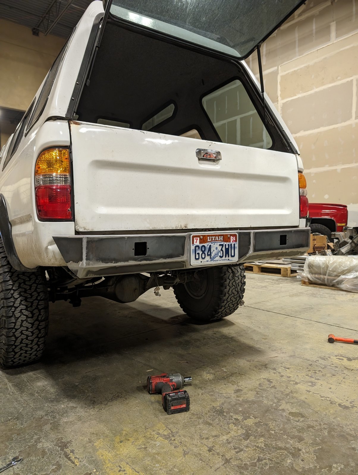

    Where did you get that tailgate? That does not look like the original

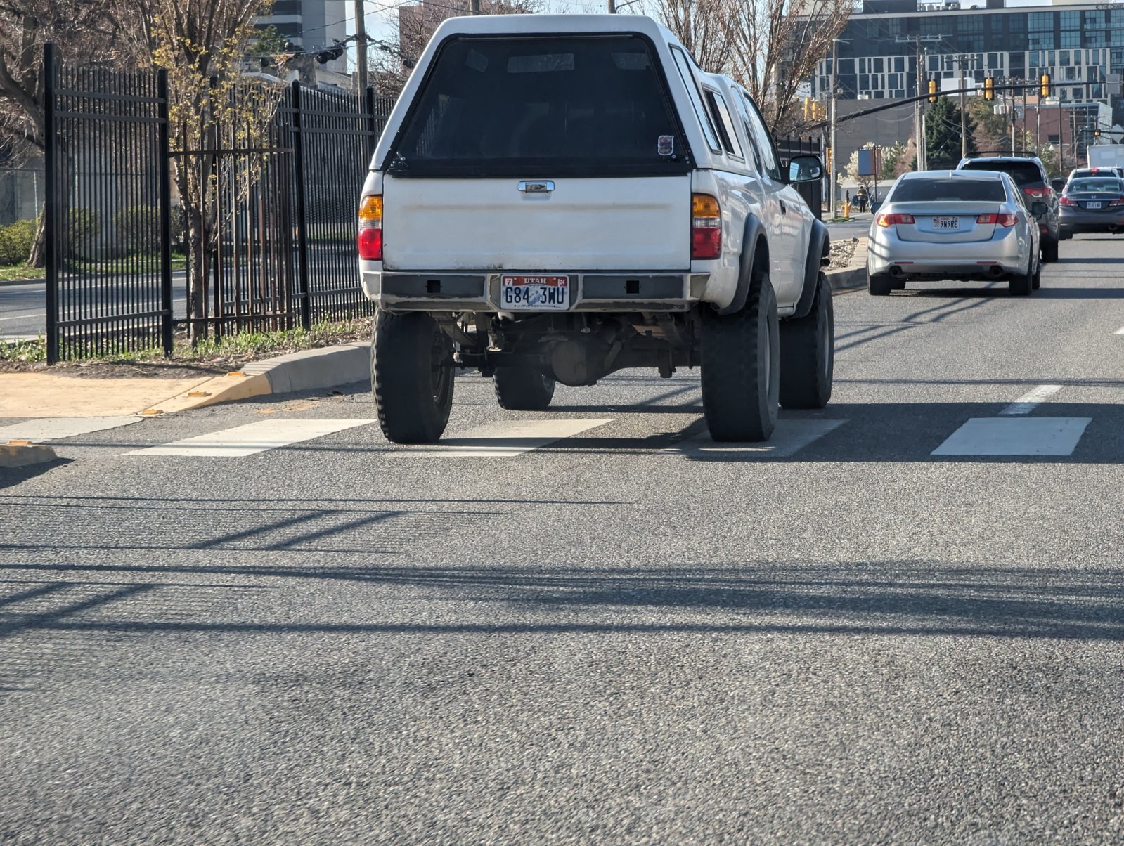

    It looks like its a tailgate off of the 89-95 Toyota pickup. I didn't know they fit but they look really good.

    Awesome!! I'm hoping to list them at a base price of $475. That will get you what you see there. I'll probably also throw in provisions for a trailer hitch, and D rings. Still have to figure out tire swing outs, so that will drive the price up accordingly.

    Yeah I got this truck with that tailgate. It fits okay
