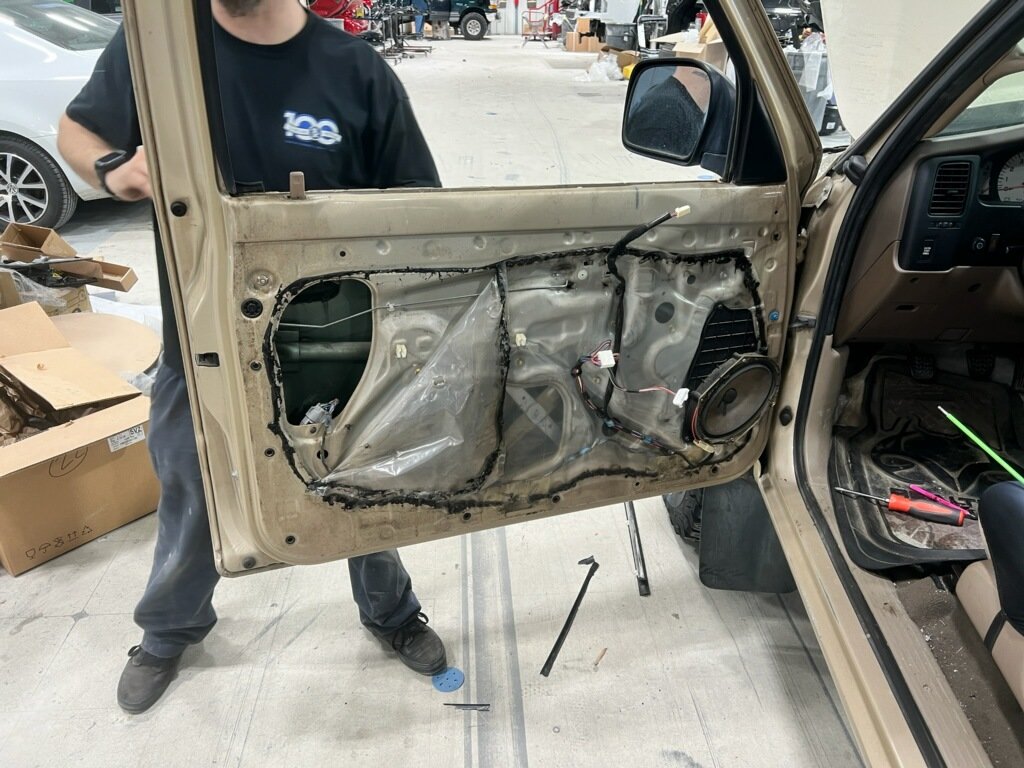

    This is the only photo he sent me. I told him I need to see behind the plastic. His neighbor believes he needs a a new locking assembly. Is that basically where the key inserts into?

    Okay, I guess he has a bad actuator. Problem solved.

    I hope it solves the problem! unless your using actuator in the wrong fashion.
    The mechanical linkage should always unlock the door.

    Thank you @Bivouac @Lil Puke @Gen1TacoLady for the responses. He's going to order an aftermarket one and have his neighbor help him install it. I'll update this thread once he does and let you know of any further updates. I wish I were there to help him.
