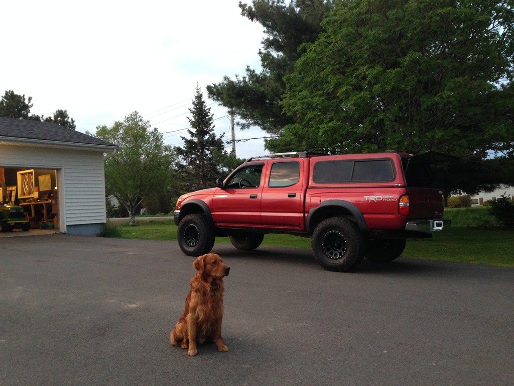

    Thanks a lot! theyre wonderful dogs aren't they? this guy is only almost 2, still just a pup!
    but I'm sorry to hear about that, it never is easy losing such a good friend!!

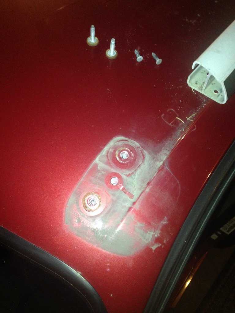

    Post some pics when you pull the rack. I'm curious how it's bolted on and if the trucks with roof racks have additional reinforcement plates in the roof.

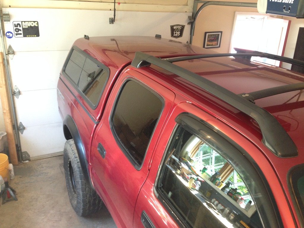

    DC72FD23-1D3B-467C-99FD-F2528D2516DB_zps_632cdec933c45b1084a0cd5e4ec64d9237ad529a.jpg
    from what i read yesterday the roof skin is different and reinforced.

    7681A8C6-277A-48AB-BA73-BA3867792CF1_zps_5cbda296d94cd10606d437a920dbb50a704a189f.jpg all painted and back on!
    ran out of paint so I didn't get to paint the rear third cross piece... gonna drive and see if its loud without it, never really liked it anyways

    Yeah. I've been waiting for someone to drop the headliner in one of these to see how they are reinforced. A good welder could add some plates on the inside.
    The harder part might be finding someone selling an OEM roof rack.

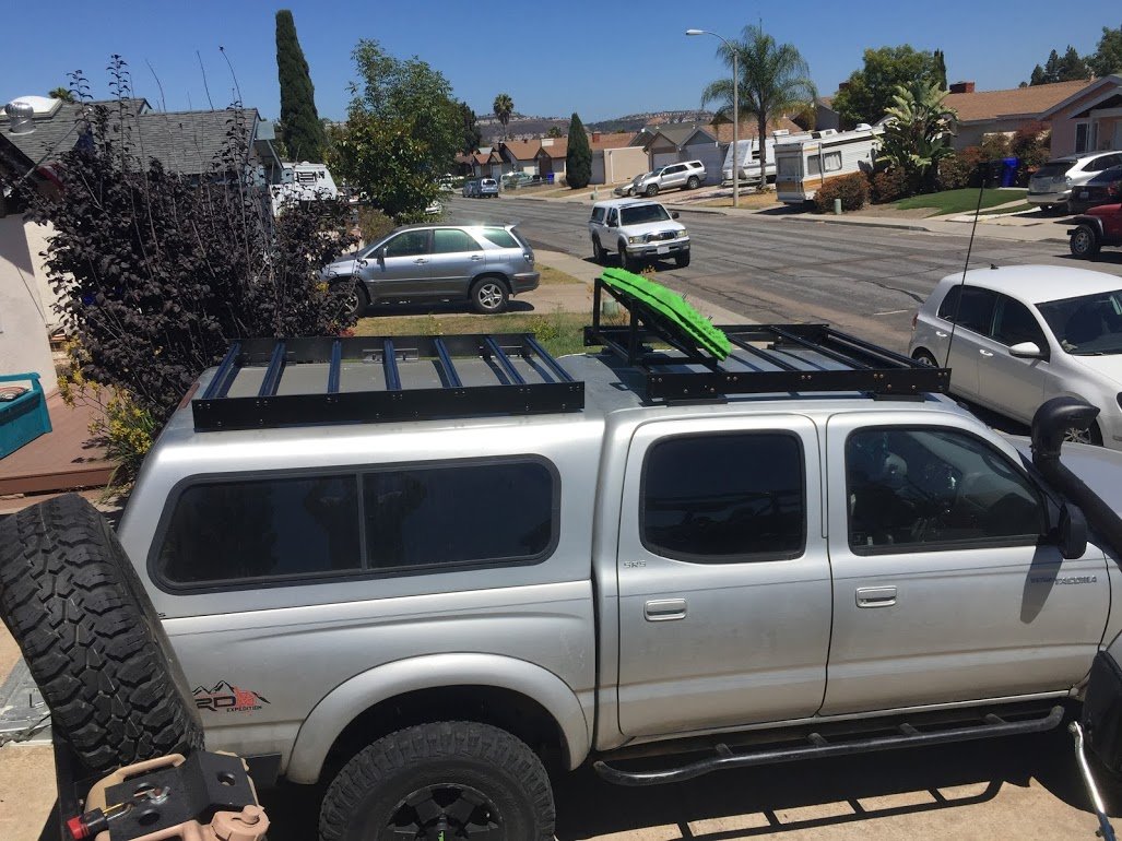

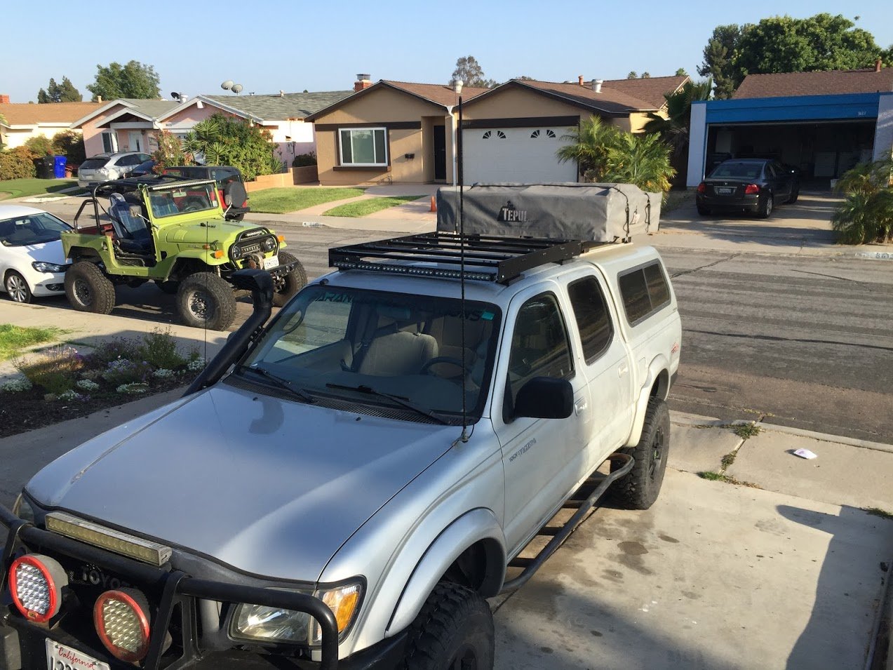

    i made the front one the other day. need to make a matching rear one later.
    FUGKPDgyOKSjP27JAM2CdvysBv9zHLCGCC9_XHeN_e707a266fc25ec7f3391f77ccc56f1775d966a31.jpg

    Do you have any pics of how you mounted it?

    14 double cab taco

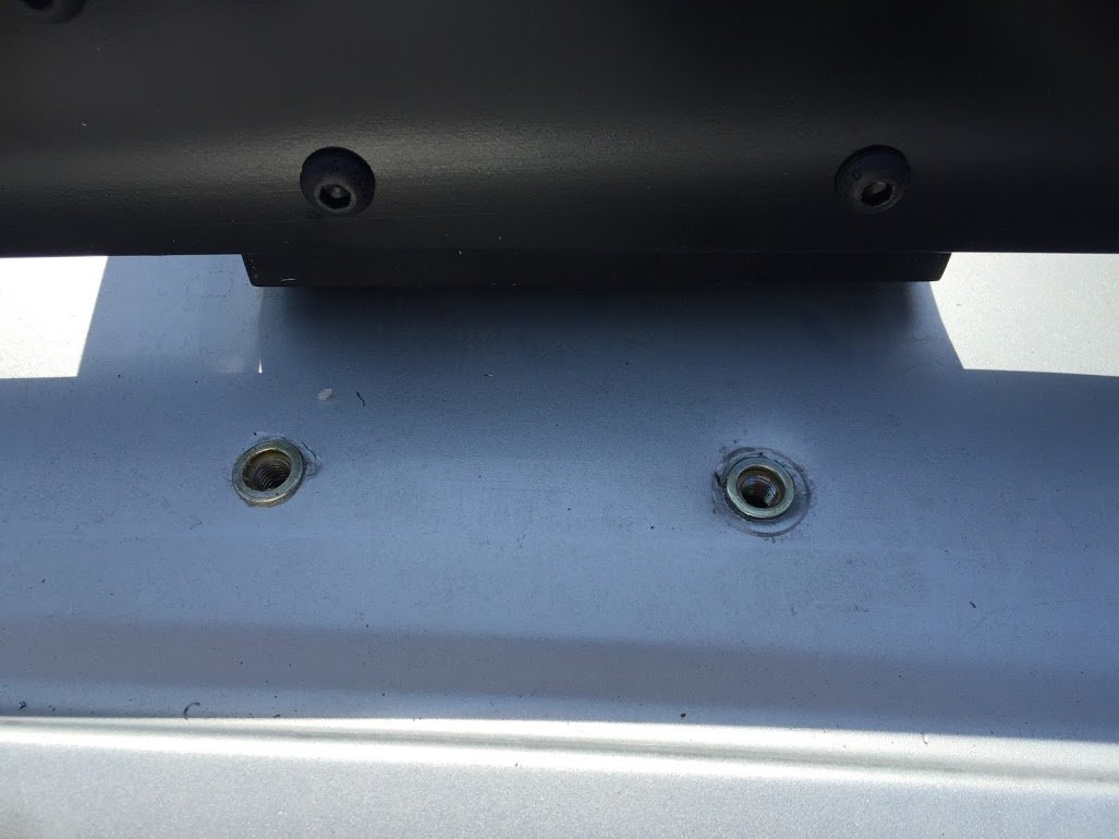

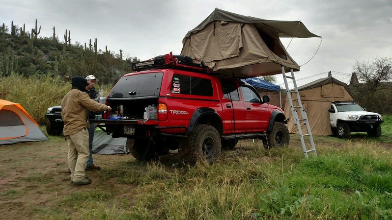

    sure, i also made up the rear one :D
    FMEfnYhogDuTQrY9CoSGFaXzQas3ZXrkJ0JGwQgk_88dda0d49e4b05aa6e2aca6fd3ac97a6c7735f24.jpg
    for the front, i made up some feet out of HDPE plastic to match the roof
    Bk-_PApMahhNgNzn0eGSz8_NnUATJbE-iE1wm_E-_fd7aeda2e7e7a5f44143780cc7451eee59d8b00b.jpg
    then installed riv nuts into the roof.
    jeUH1nMGTKCiXEb-Ms3C-rUjTiHuyGNuYYQejNBB_178c06c51f5f6e9d68d8d79d5357dbf212a84ba6.jpg

    How did you do those cross bars? That looks like a simpler version of the Prinsu rack. I would be interested in a write-up of how you made the rear one? Is that also mounted with riv nuts/plusnuts?

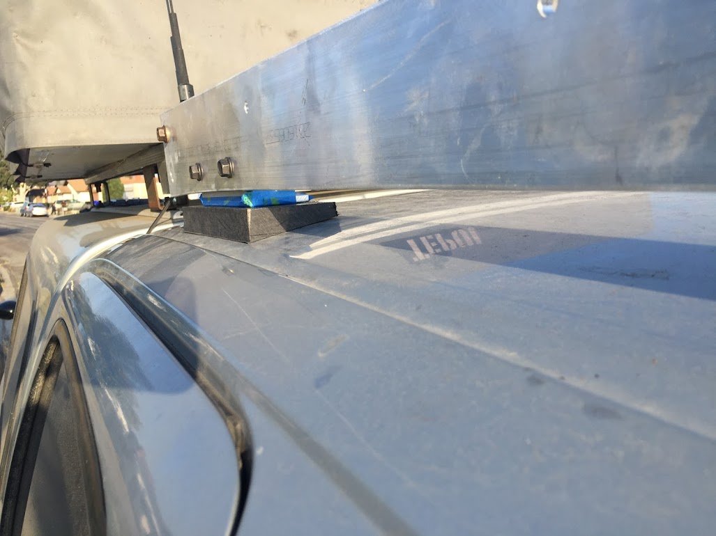

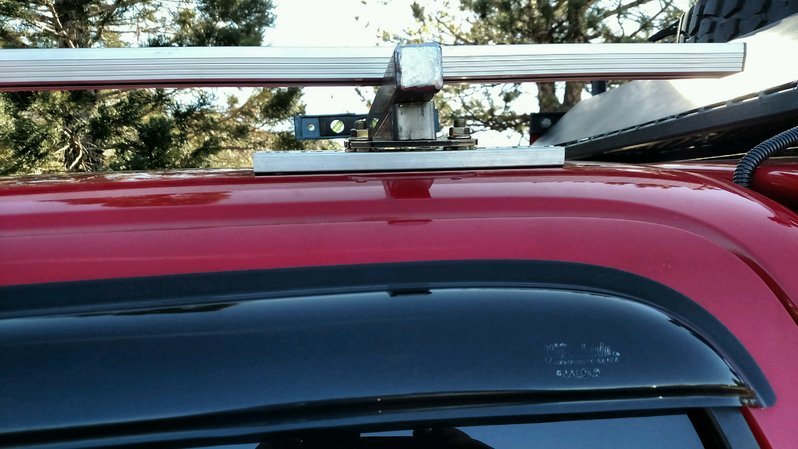

    Hey I know it's been awhile but I'm looking to redo my cap and cab roofracks to look a little more like you're set up and a Prinsu rack. Just wondering if you have the specs of the materials you used (crossbars, side panels, etc). Thanks in advance!

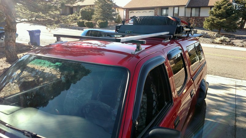

    Made a simple set of crossbars for the cab using L track and 1 1/4"x .120" square tubing for the new RTT. It holds up fairly well but with two people up top the roof sheet metal does flex a little. I plan to move the tent over my ARE Z series and make a new front rack for gear.
