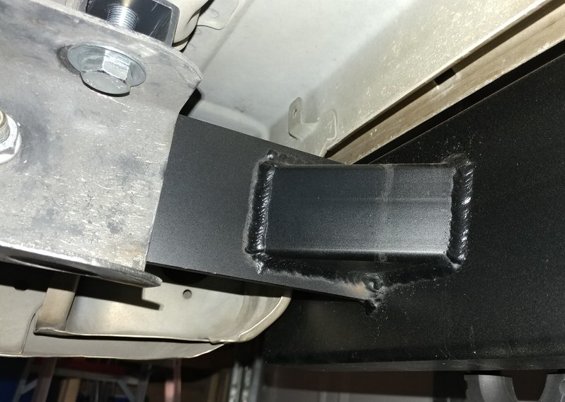

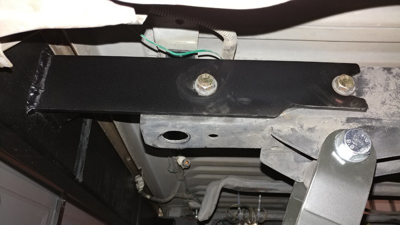

    Are there only two bolts per side holding this bumper on?
    If so, I wouldn't pull anything significant with it..even the factory hitch has like 4 bolts on each side.
    Edit: also, the second slotted bolt wouldn't hold much weight during a pull..

    Funny thing is I believe my new brackets that we made are the same exact footprint as the factory brackets just not angled upwards. Slotted and all. So yes 2 bolts I guess.

    My trucks in my shop right now, but let me see if I can find a picture of the brackets. During a recovery, say someone pulling your truck out of a mud hole, that bumper could EASILY become a projectile. You technically only have two bolts that need to shear to release the bumper and any energy stored in a tow/recovery strap.

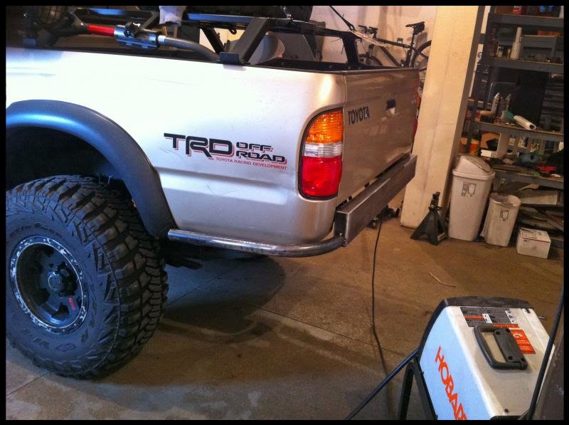

    And the bumper is not complete. Got .120 wall DOM bent for the sides that are going to have a brace running underneath and bolt to the frame. Similar to Box Rockets old truck thats pictured here. Just waiting for my welder to get some free time. Rock sliders are going on too.
