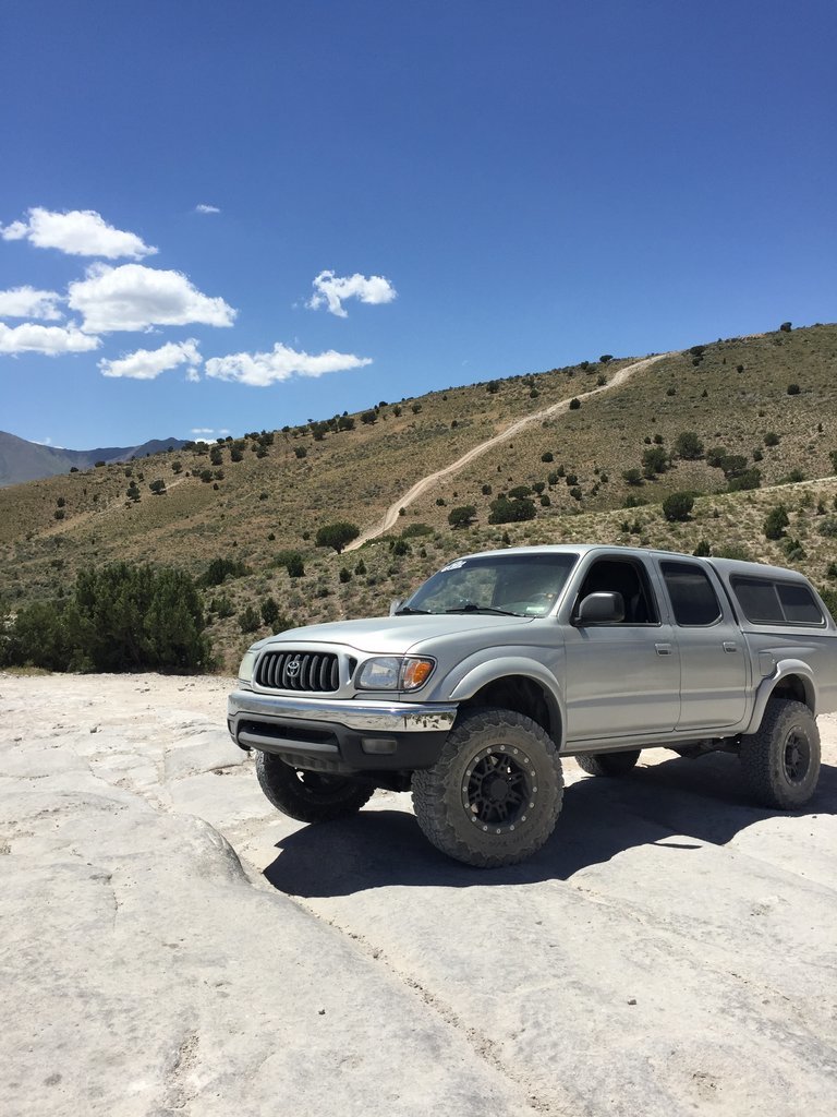

    What are you all doing for roof racks?

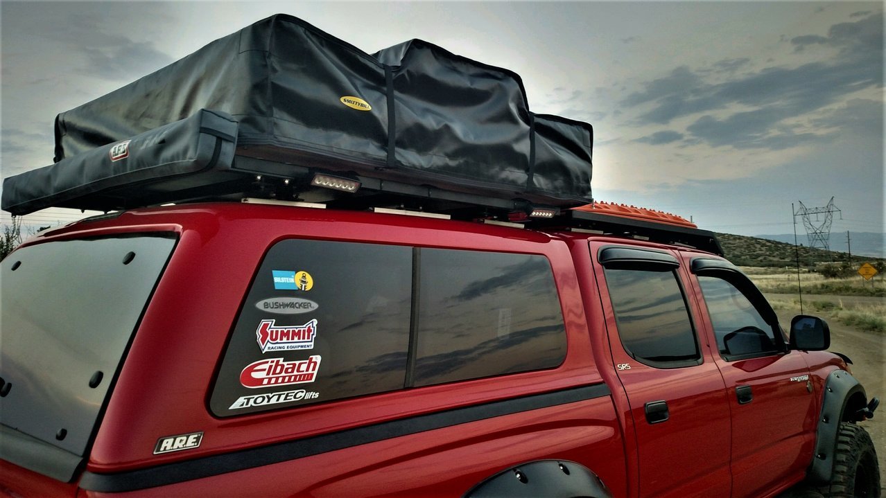

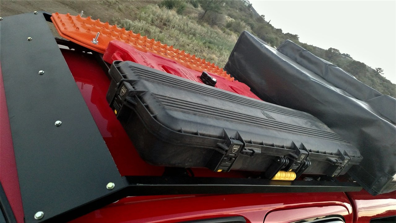

    Homemade here

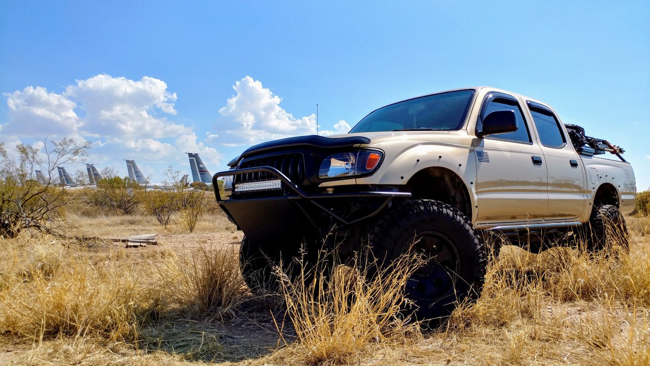

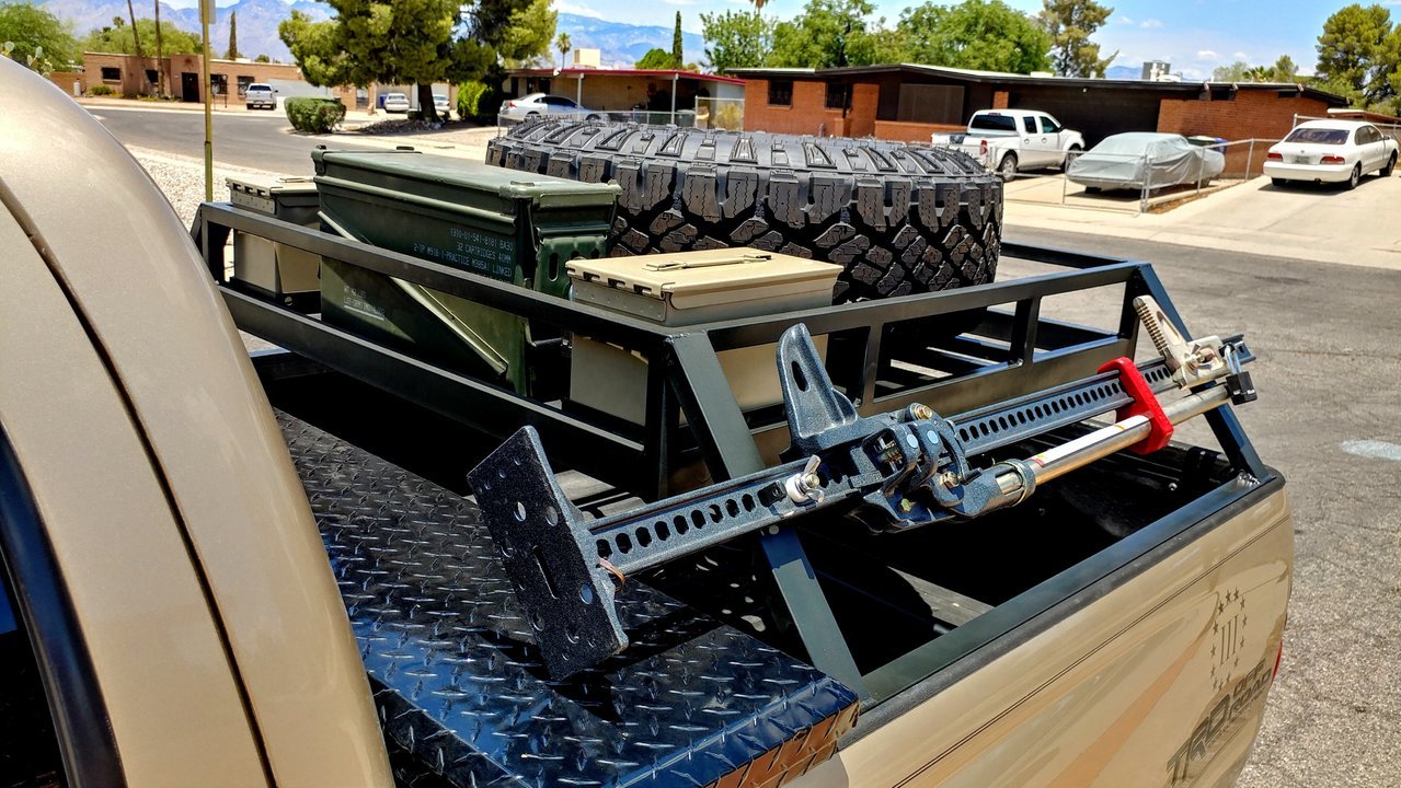

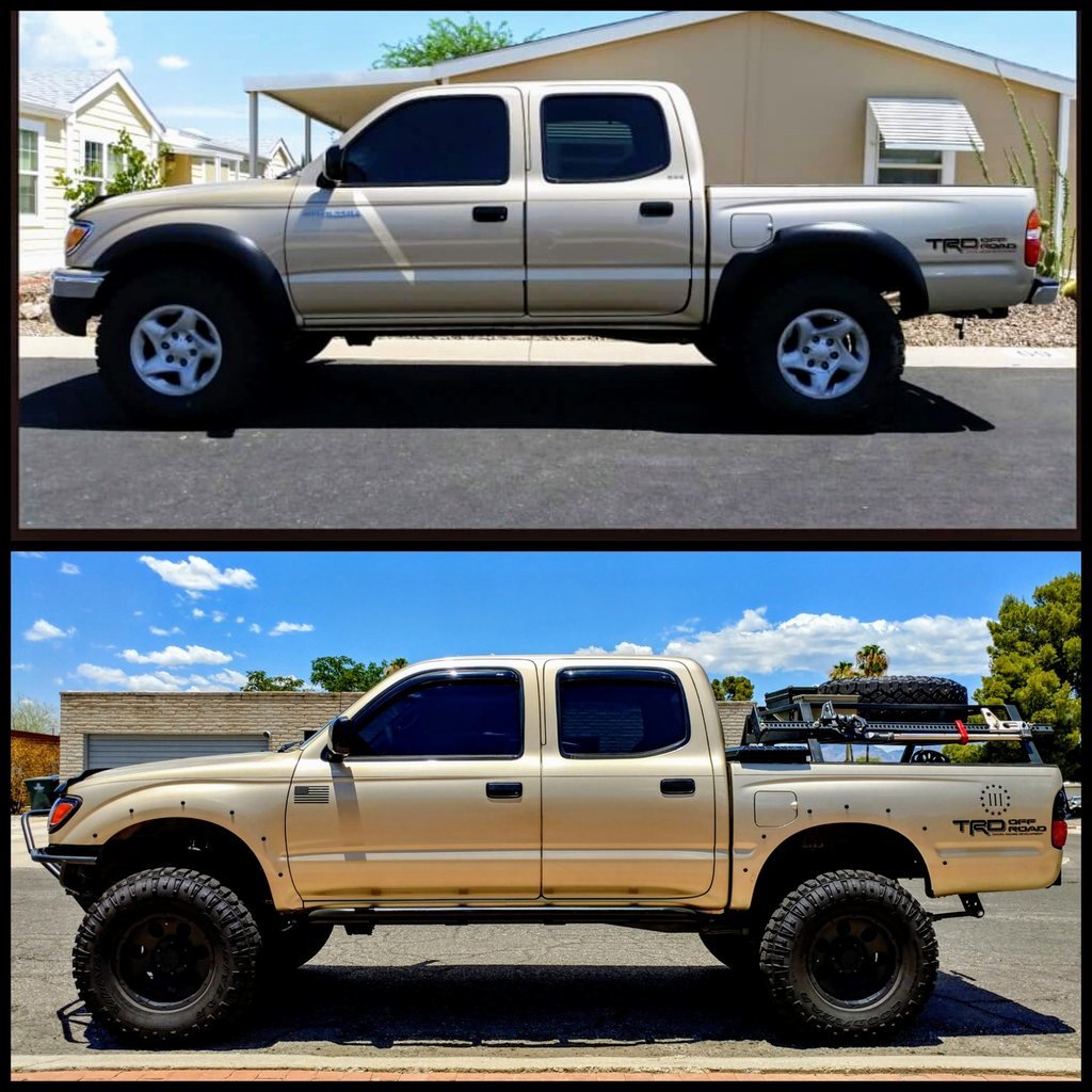

    Thx!!! Unfortunately I do not. Here's a before and after/most recent pic though! And a few desert shots.

    What camper shell is that? Looks dangerously like mine!

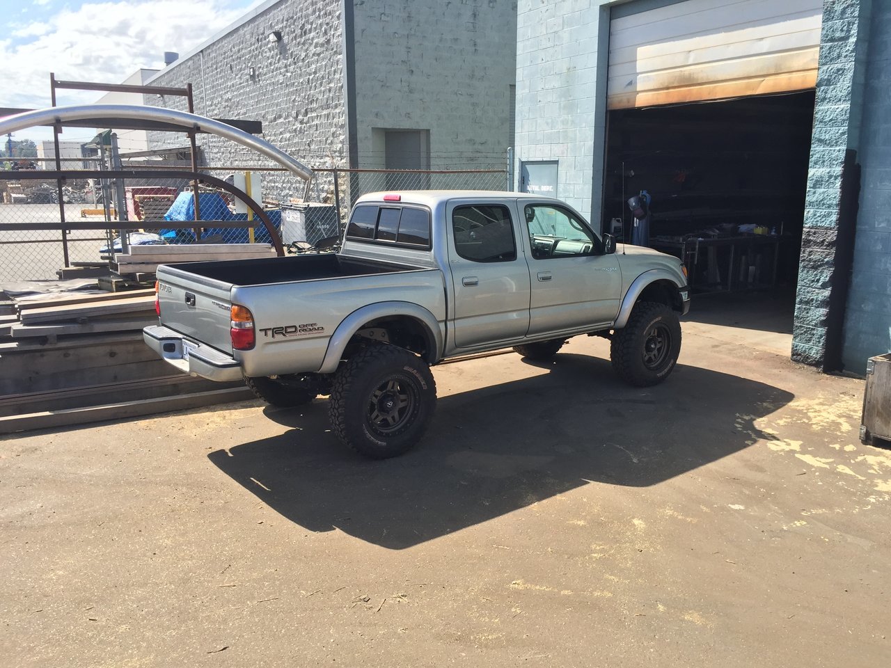

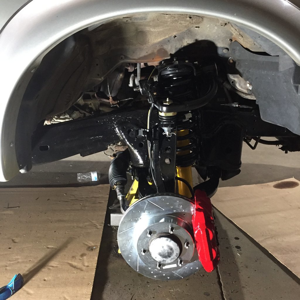

    Just finished painting the frame and installing a lift on mine. Frame was not rotten luckily but the whole thing was surface rust
    OME lift with 883s and add a leafs.
    Reinforced the rear frame and the front rear spring mounts, did the Tundra brake swap and replaced all the exhaust. Needs some bumpers now

    Nice. I'm looking at the brake swap now. My brakes are on their way out. What calipers did you go with? One thing that has been on my mind about this operation is what to do with the old calipers? Do places accept those as a core return?

    This is the power shot kit from Rockauto. They do take cores back but since im in Canada I won't bother. The rotors and calipers are huge

    what body lift did you use? thoughts?

    It's a Daystar lift. Got it from Summit Racing.

    would you say its a good comparison to 4crawlers, seems like the daystar and that one are the best

    I'm not sure. Never looked at 4crawlers kit. I just know I didnt want to go higher than 1".

    did I come with everything you needed? Did you have to adjust anything like the fuel filler hose, radiator, linkages, etc?

    Everything you need. Radiator no. Fuel filler hose yes. Steering linkage spacer yes.

    I've got the 4crawler one inch BL on mine... Removed lower fan shroud, installed steering spacer and bed spacers in between the bed and frame to support weight better.
