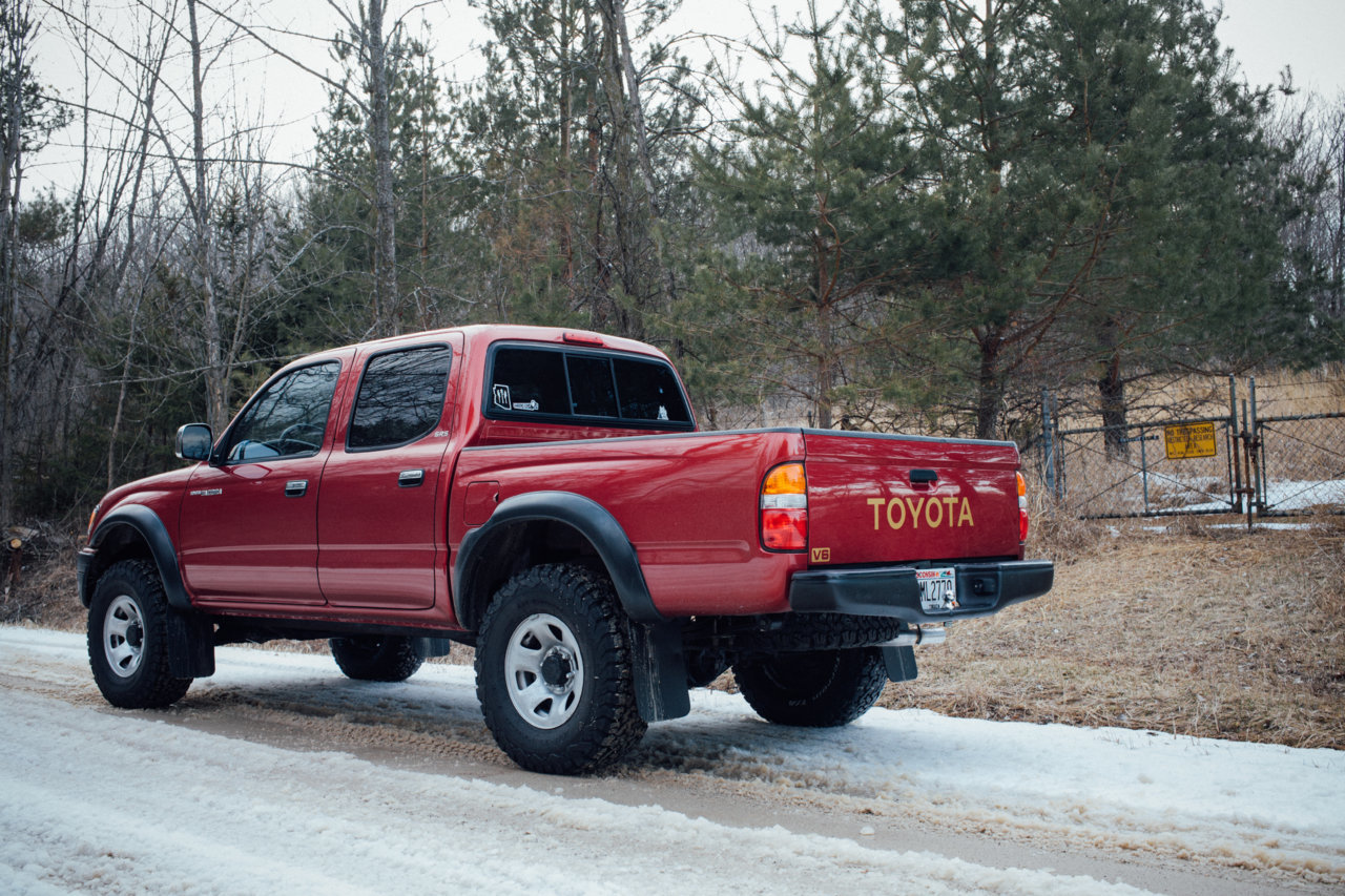

    Yes I believe it's a conversion. I luckily got the truck with them when I got her. :)

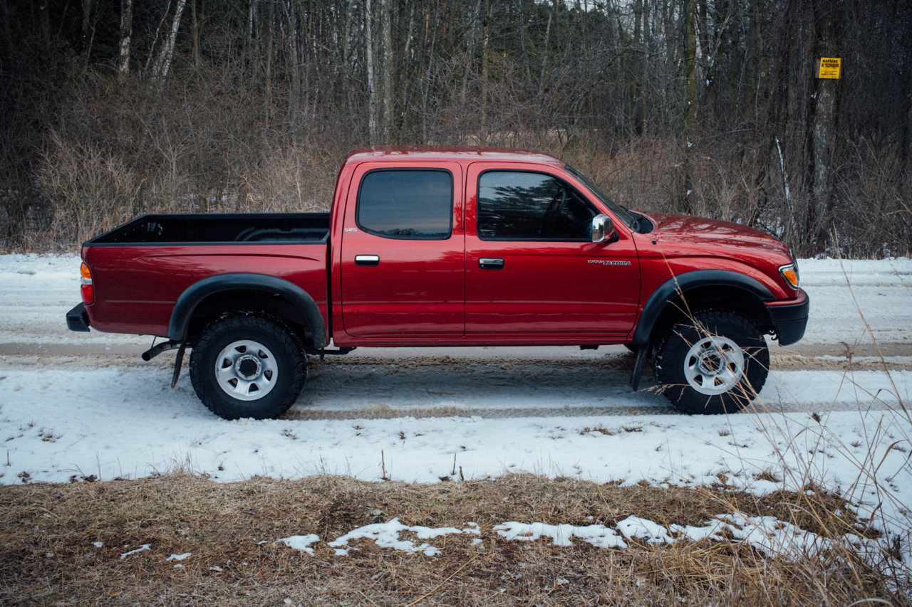

    My 2003 in its current state. Double cabs rule!

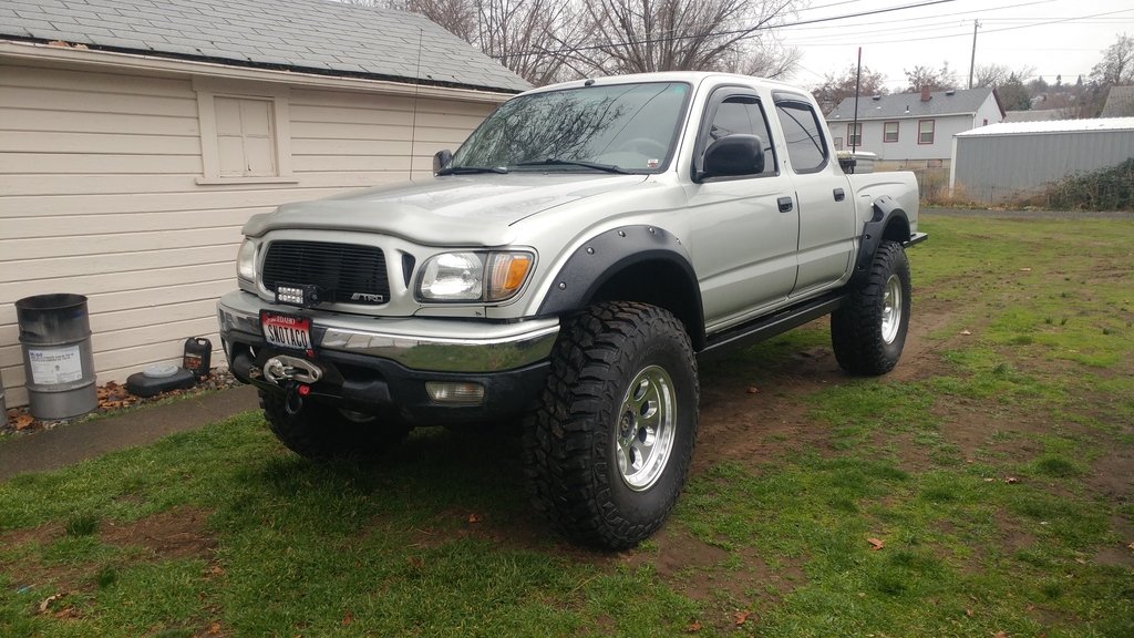

    2003 tacoma double cab, prerunner, 4wd conversion, 5 speed conversion, dual cases with inchworm clockable adapter, toytec ultimate coil overs, trd supercharger with urd 7th injector, 37 inch mastercraft mxt's, arb front locker

    How does it ride with the 37’s?

    Rides great! Been dialing in how much balance beads I need but great so far

    What gears

    stock 4.30 gears. supercharger, 7th injector, and manual trans makes up for it and the dual cases make the gears unnoticeable out wheeling

    I'm running the INCHWORM clockable case kit. I have trail gear 4.7 gears in the front case mated to a stock j shift case clocked flat and then radesigns triple sticks

    Yea they did .That's crazy, it wasnt too long ago I was on there playing around and it was all there. That being said for as much work as it was, and what I gained, I tell people to save the trouble and just get the trail gear kit

    Thankyou sir! I'm pretty happy with it, even if it was supposed to stay a pre runner daily driver that never got wheeled

    How much cab chop required to fit 37?

    Ground it down until the bolt. Rubs on the frame more now and is wheelable. Still need to ideally tub the firewall more and would like to move the cab mount back a inch or two like the second gen guys do
