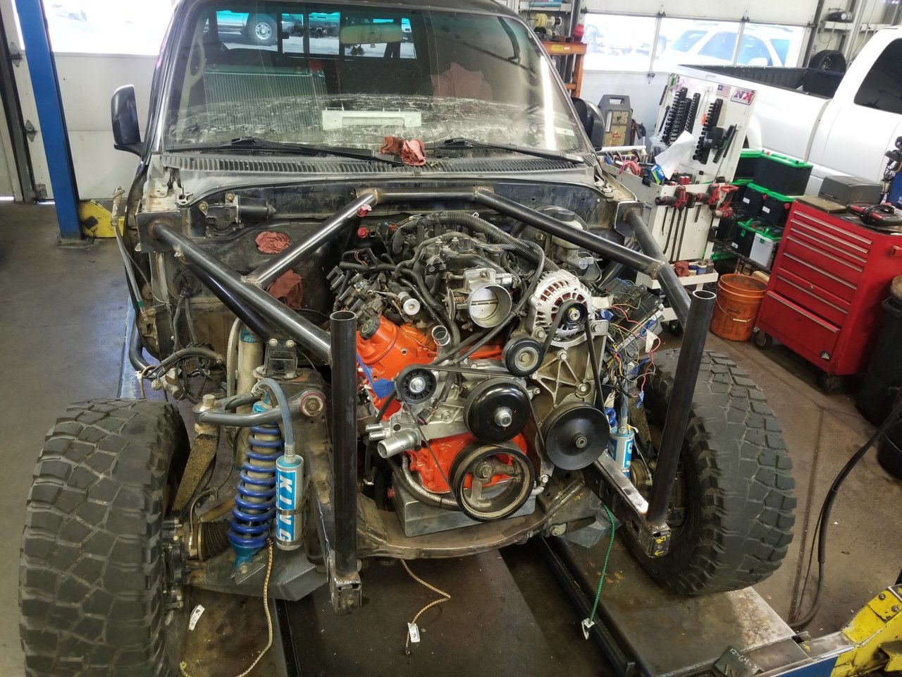

    Biggest pain is headers!!, decided to go with turbo, forward headers. We already installed push rods, dual springs, trunion, cam, new timing/tensioner. Need to install new injectors and project continues.

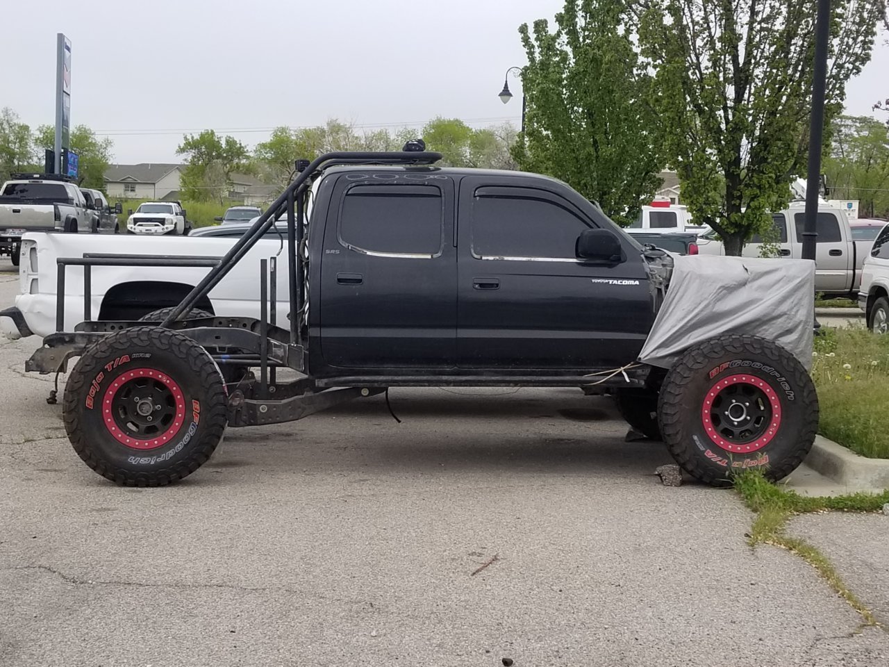

    What engine is this?
