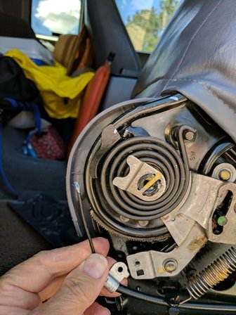

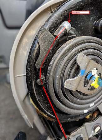

    Now that I have your attention! The ball in question is at the end of the cable that slides the passenger seat forward when you trigger the seat-back forward. I have included a photo of a cable with ball intact. If you still have yours, I am asking someone, anyone, to measure the diameter of the ball with a caliper and let me know the size. Mine is missing and I want to know the right size to replace it with (if I can find it) and attach it to my cable Photo of Cable top end on working cable-for TW.jpg Typical frayed cable with ball end missing for TW.jpg

    Without being so precise, a small washer and standard cable crimp would suffice and provide the function you are looking for.
