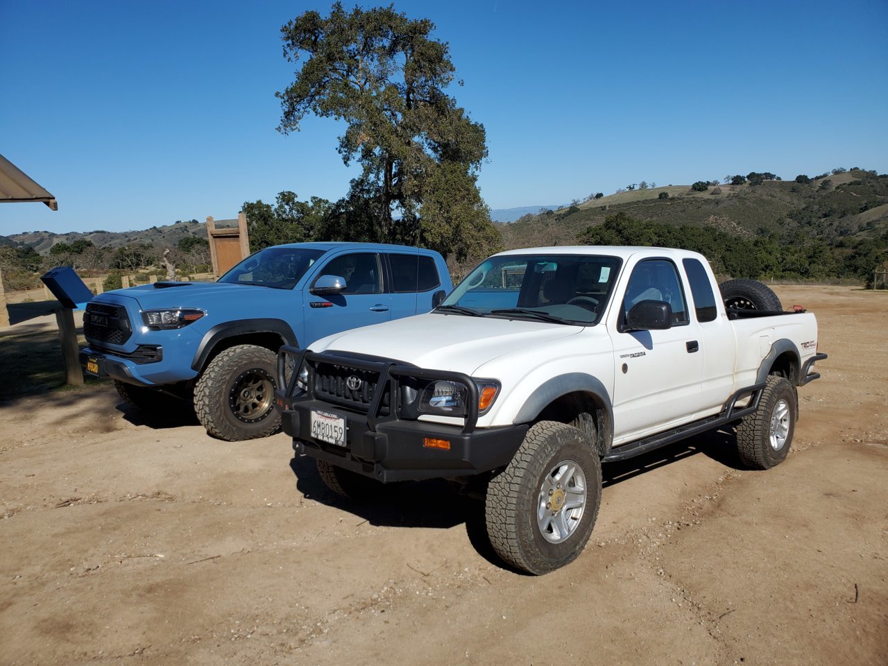

    It only became a bit of an issue for me (personally) when I went offroad and fully loaded up for camping. Even though the Fox are valved to be a lot more stiff (good for off road), they felt amazing when I carried my tiregate, bed rack, and roof top tent.
    Unfortunately though, a seal busted on my rear passenger shock so I installed the Bilstein's once again.
    If you're going to be heavily loaded up, then go ahead and get the Fox 2.0's. If you're going light weight, and want a decent setup for off road while still being able to enjoy long spirited drives on pavement, get the Bilstein 5100's.
    Just ensure you get extended bump stops with either shock.
    As you can see (bed rack and roof top tent uninstalled, in storage), my truck is pretty heavy.
