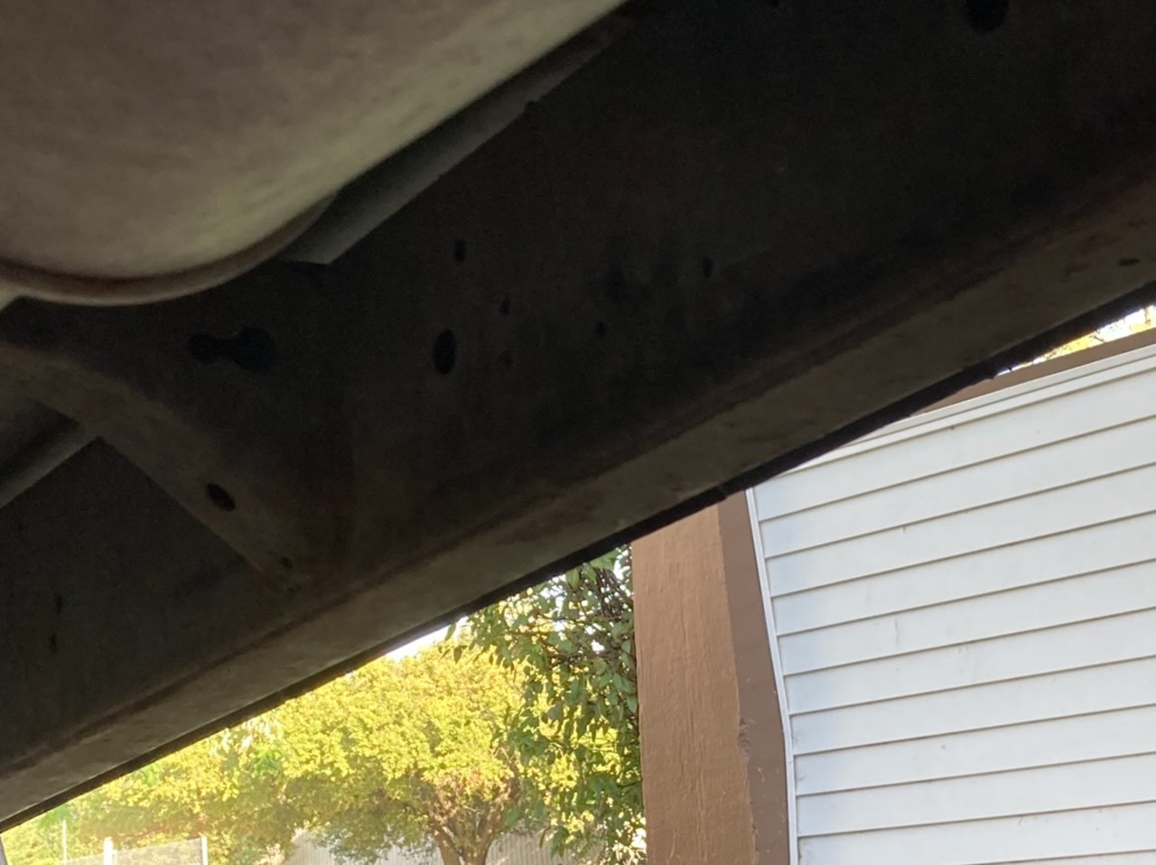

    Frames rot from inside, get a undercoating gun and 360° extension wand to spray Corroseal inside box members after welding is compleated. Hit surface rust with Corroseal and paint. Then Fluid Film entire frame inside and out.IMG_20191008_145233266.jpg

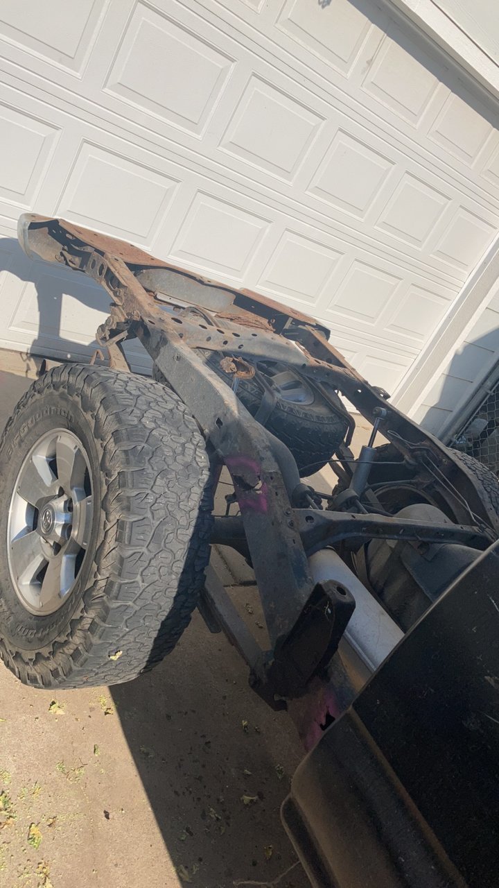

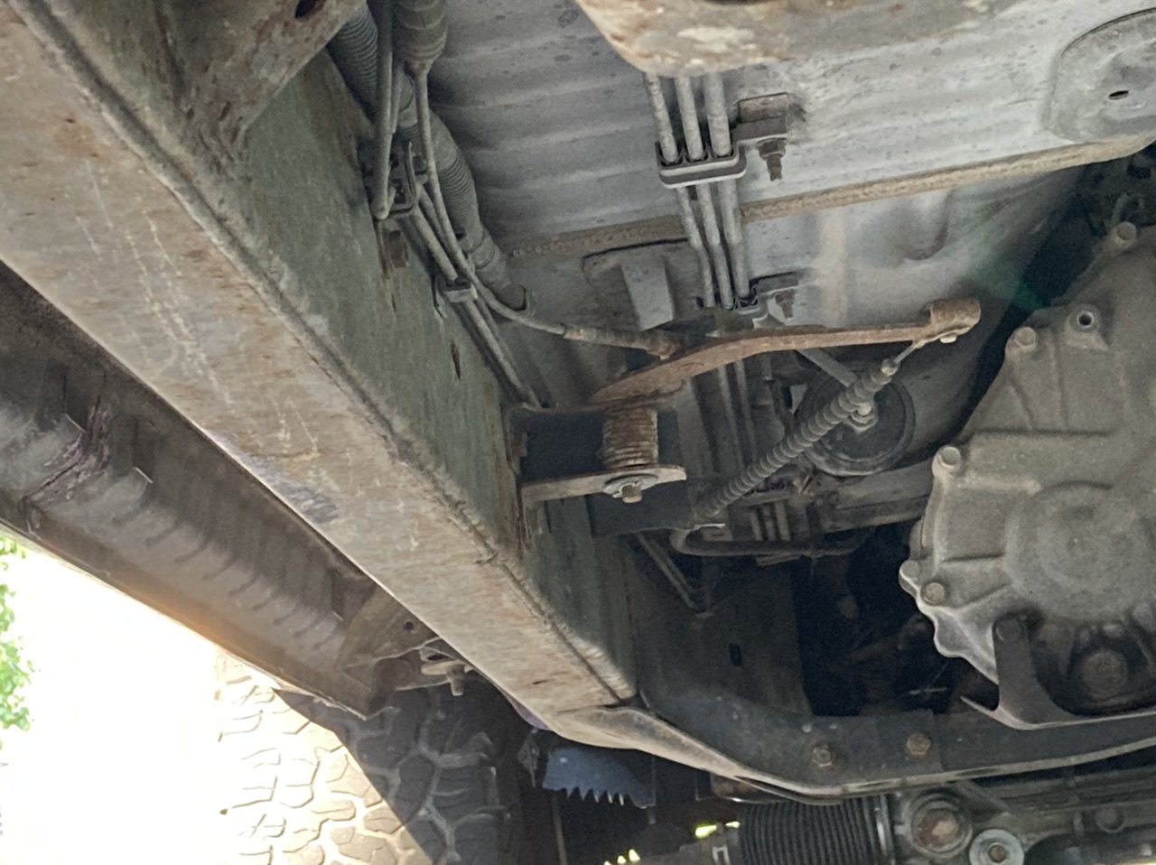

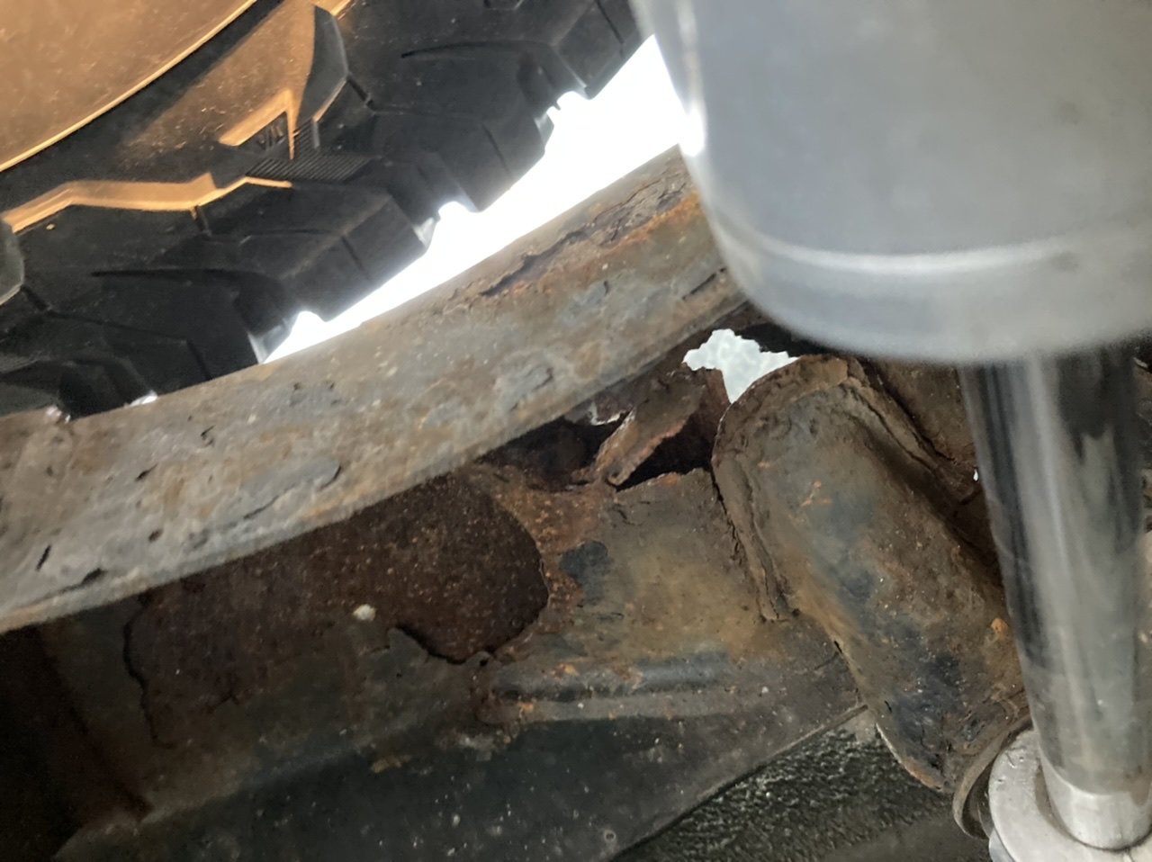

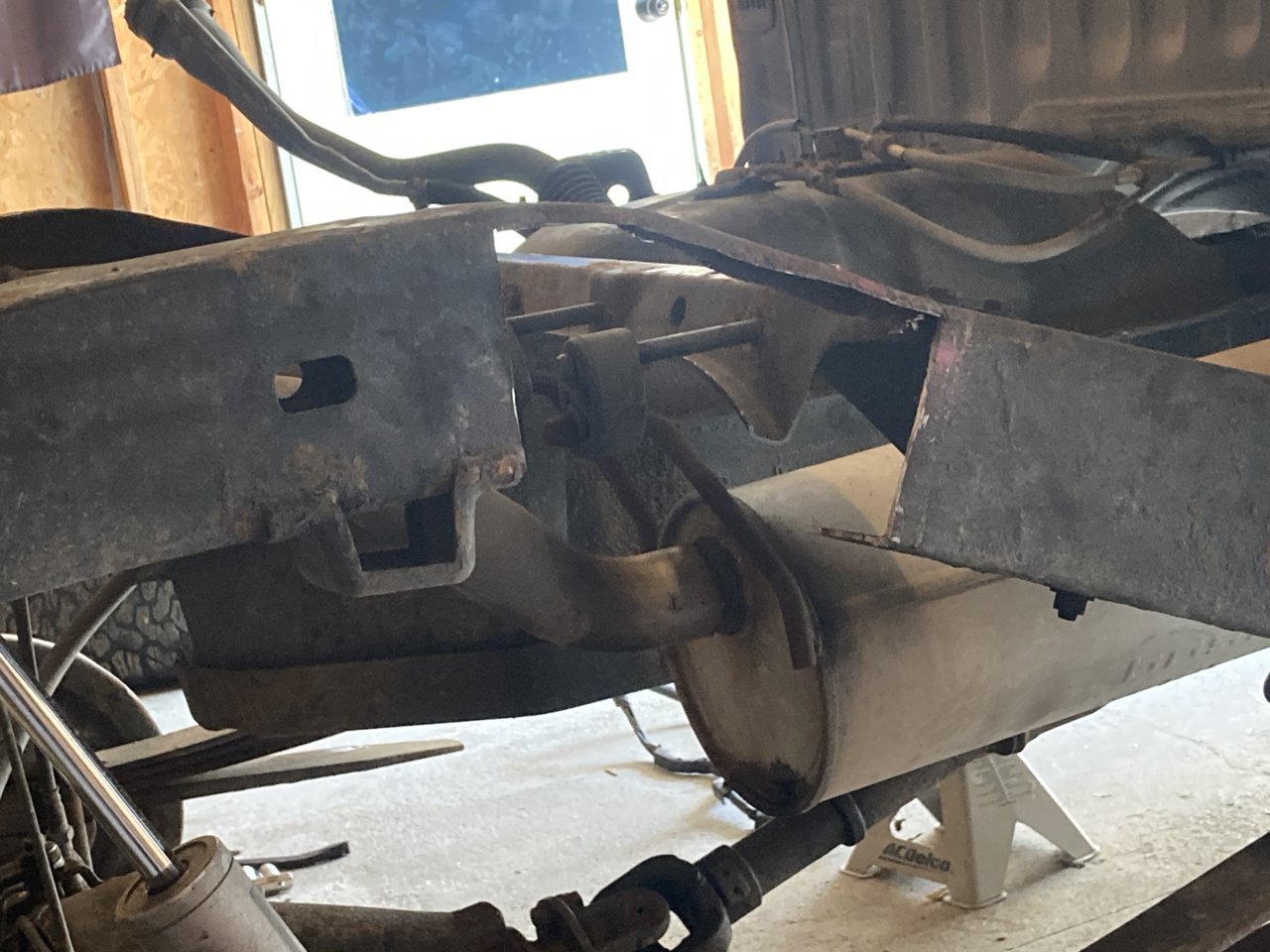

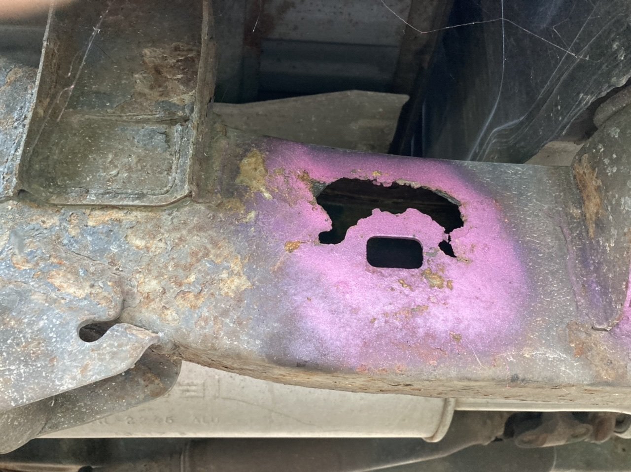

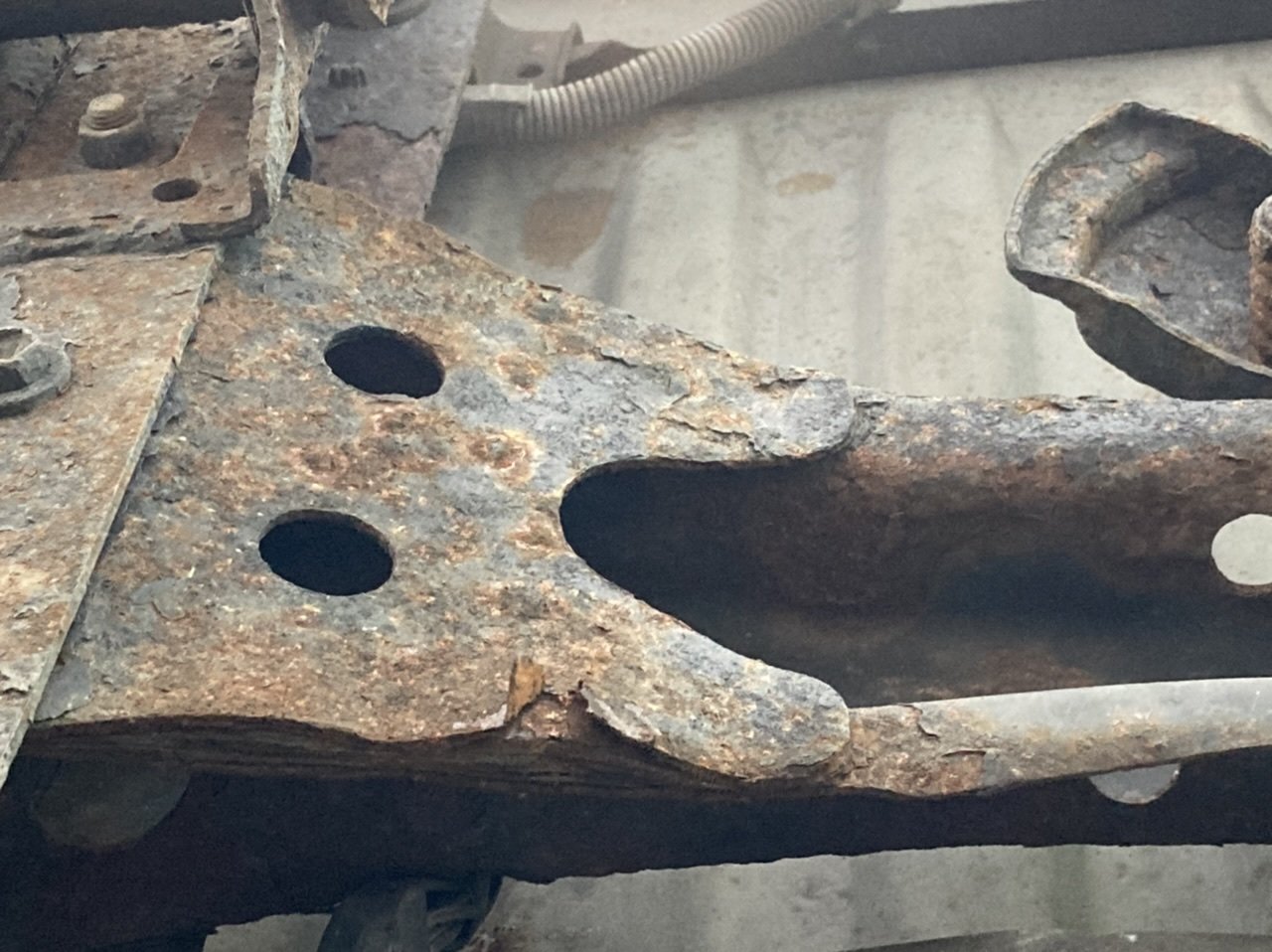

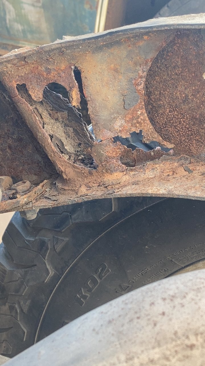

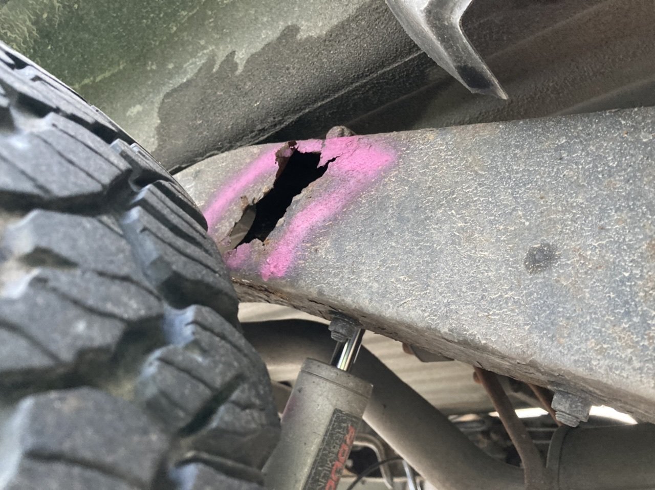

    Here are a few pictures of the spots. Should I even bother with the safe t cap things or should I just cut and weld patches in and make a new shock mount as well as replace the rear most crossmember (it’s not terrible overall but there’s a crack in it). The rest of the frame looks good honestly.

    Did you hit all over with a hammer?
    Sounds scary I know but that's how you find the weak spots by sound or punch through. I would use the cap and shock mount .upload_2020-1-29_20-32-46.jpg

    yes, I did. Those are the only spots. I'm going to buy a cheap boroscope to look in the boxed sections but I wasn't even feeling dirt in there either.

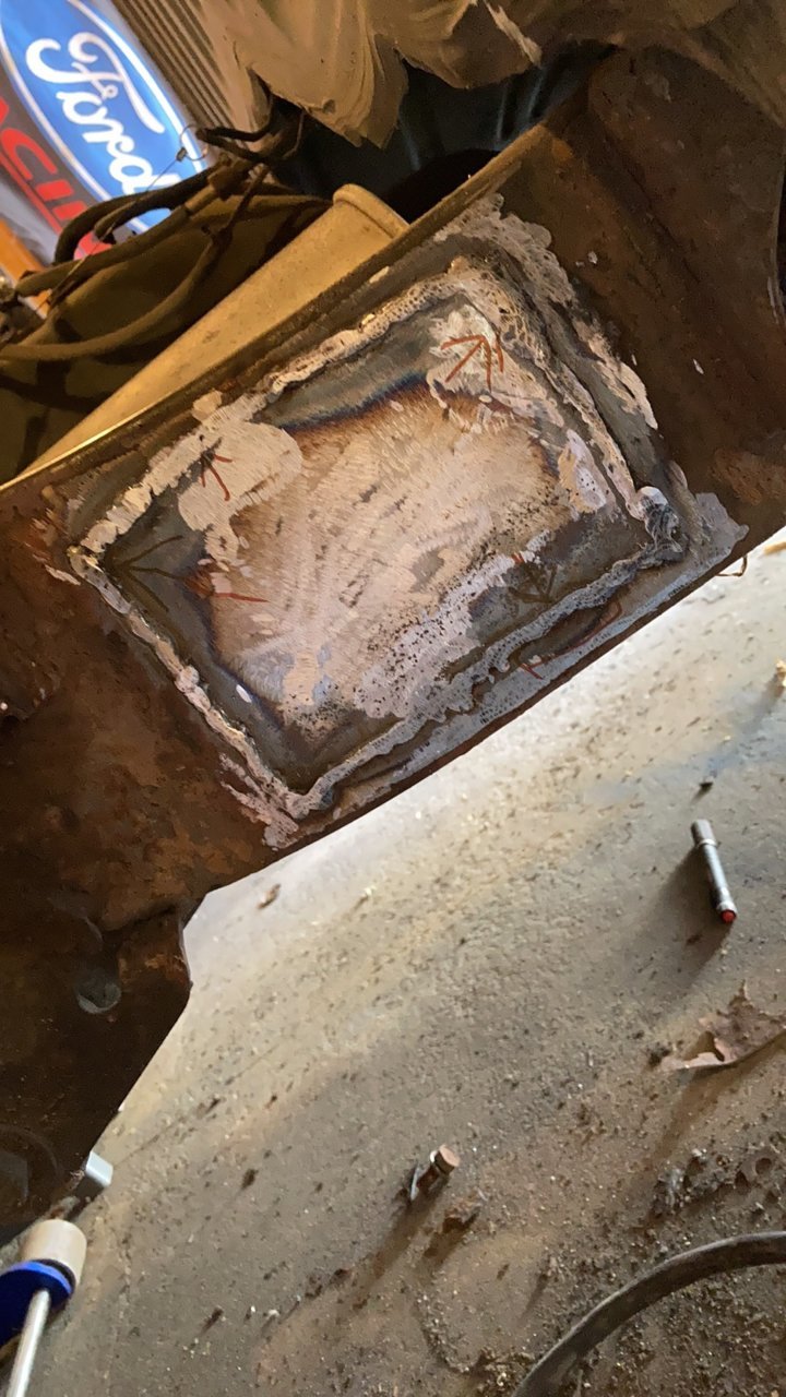

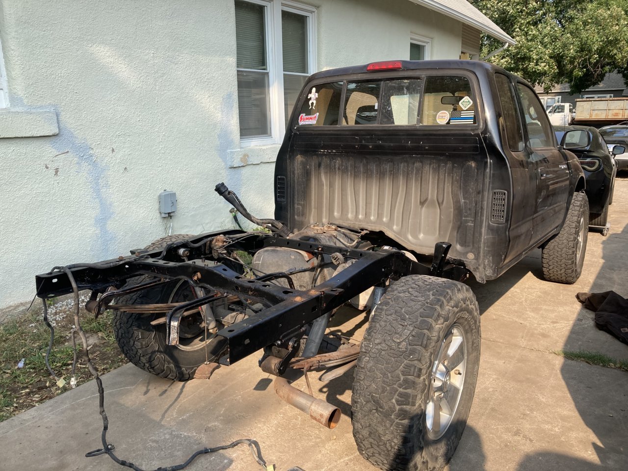

    Sorry for vanishing for a while but life got in the way for a bit. Over the long weekend, I finally got to cutting and welding everything back together.
    I’ll keep you guys posted on results and have more pictures of this repair in my build/project thread.
