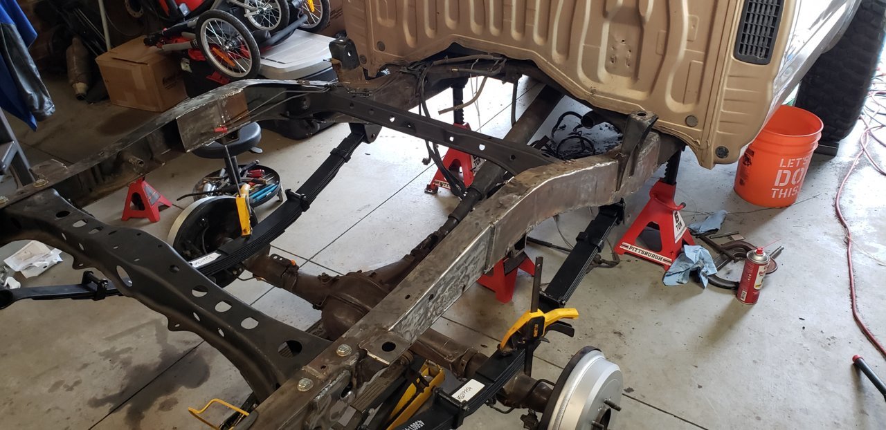

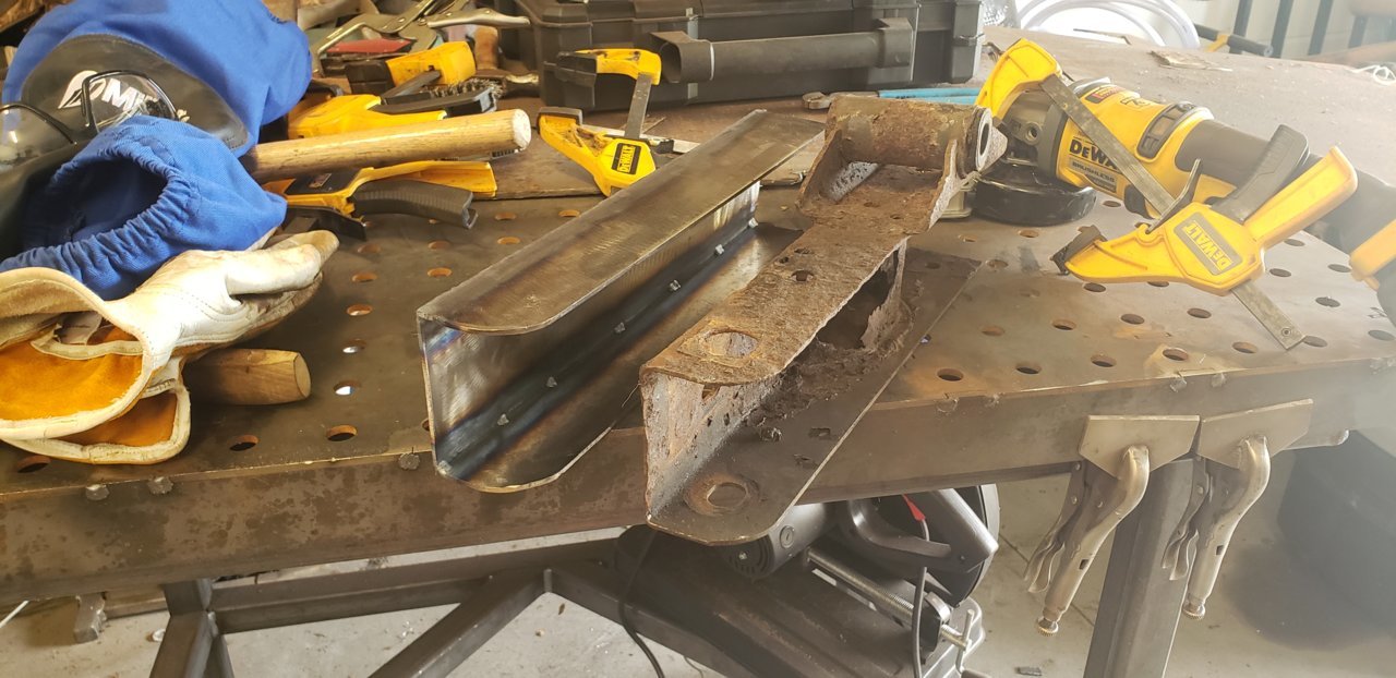

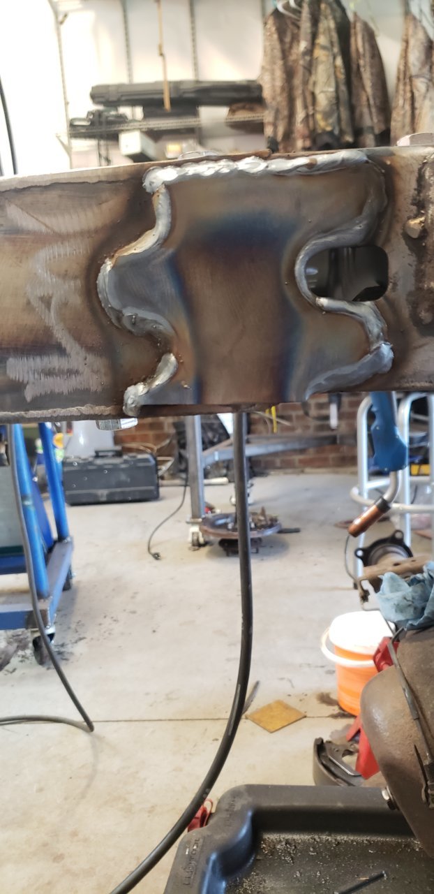

    Decided to tig weld the rear section becuase the fitment was so nice. Also just felt like being in the garage for a bit longer today. I will post pics after its fitted up on the frame. Thanks for following along!

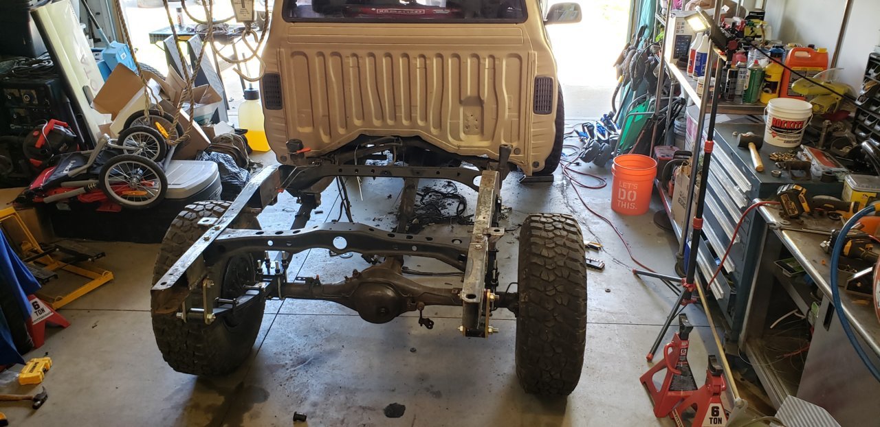

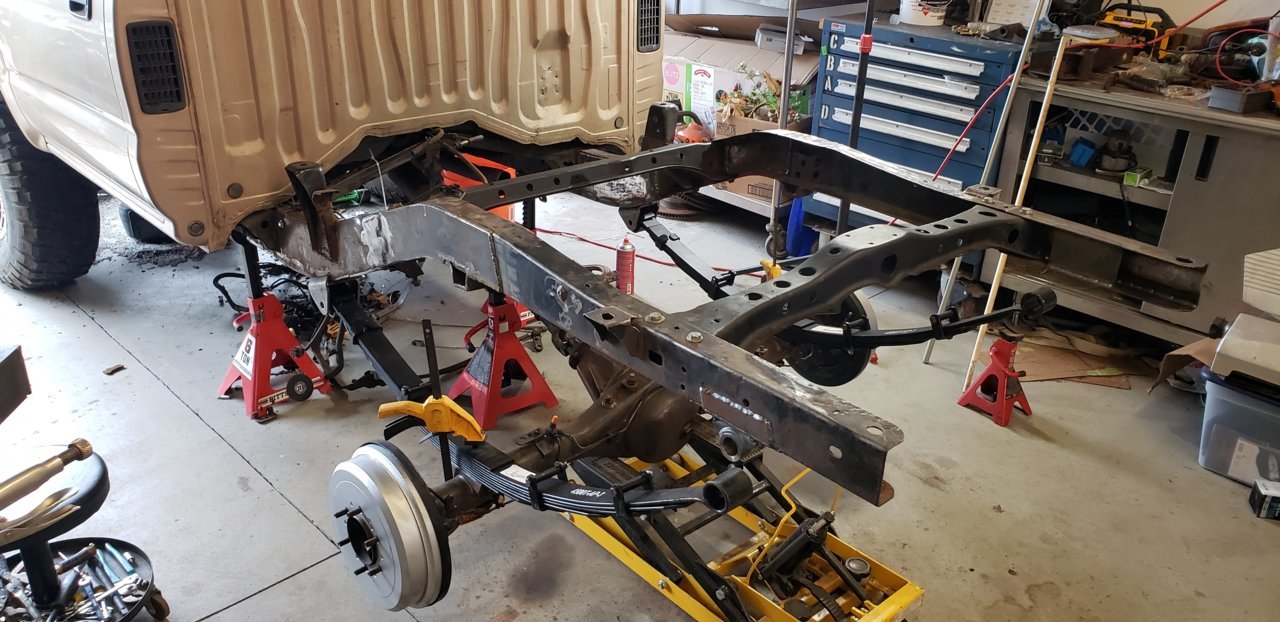

    Finally done with my frame repair. Now just cleaning welds up, stripping old frame paint. I have to replace the backing plates, so bearings and brakes to do after turkey season. Almost there

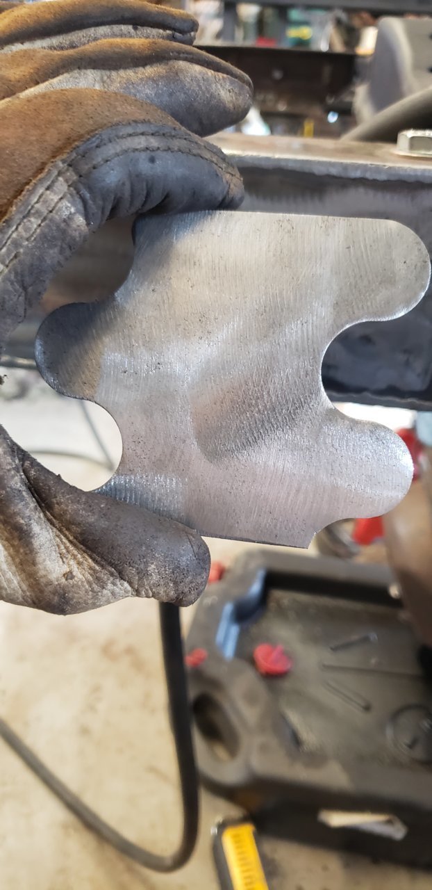

    How hard was it to install the backing plates? Aren’t they pressed on?

    The bearings are not pressed into the backing plates more like a slip fit. The bearing retaining coller has an interference fit I would say of about .0005. Which you can use a pipe to hammer on. If you are trying to save your backing plates I would suggest using a press. But if you are swaping them out for better ones, a grinder is the way to go. I used a roteryfile to cut the bearing coller alnost to the shaft and a chisle to split it. Most of what holds them on is corrosion.

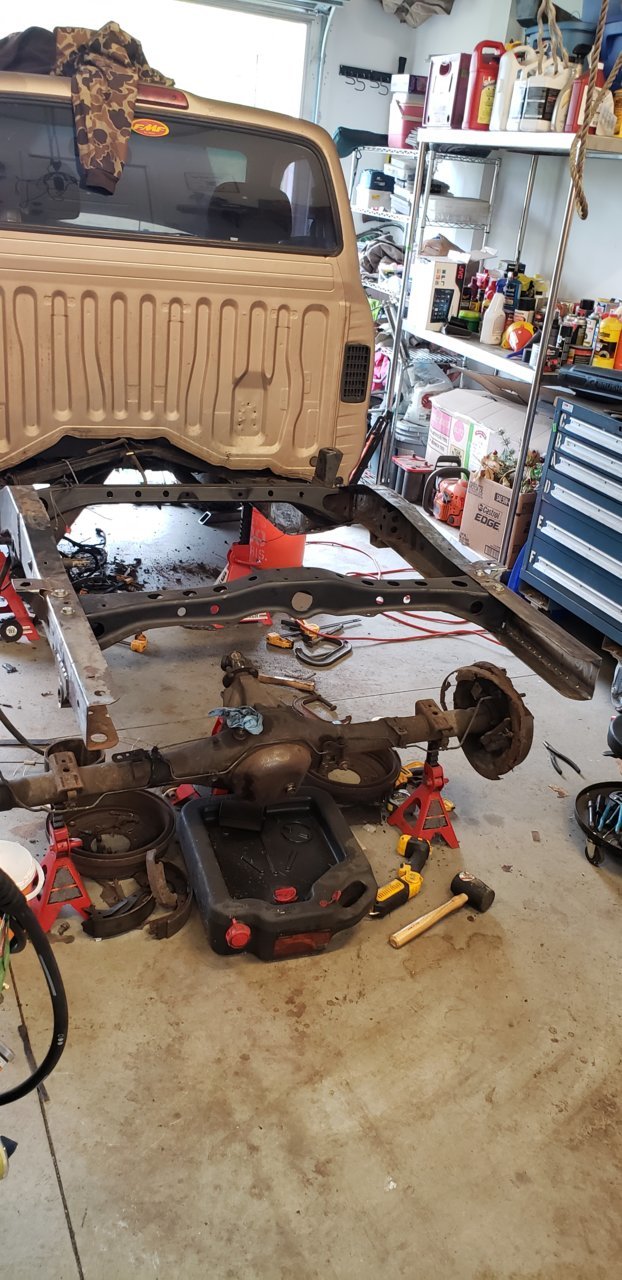

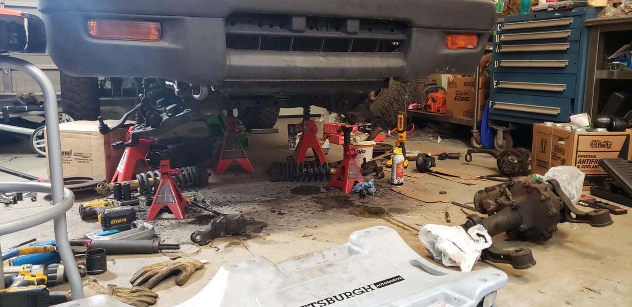

    An absolute bomb went off.... wanted to replace the oil pan gasket. Ended up taking the entire front end off the truck. Now I am going to order all new bushings.... for everything. I had a roller last week, and thought I was almost done with the build. Boy was I wrong. Anyone want to help?
