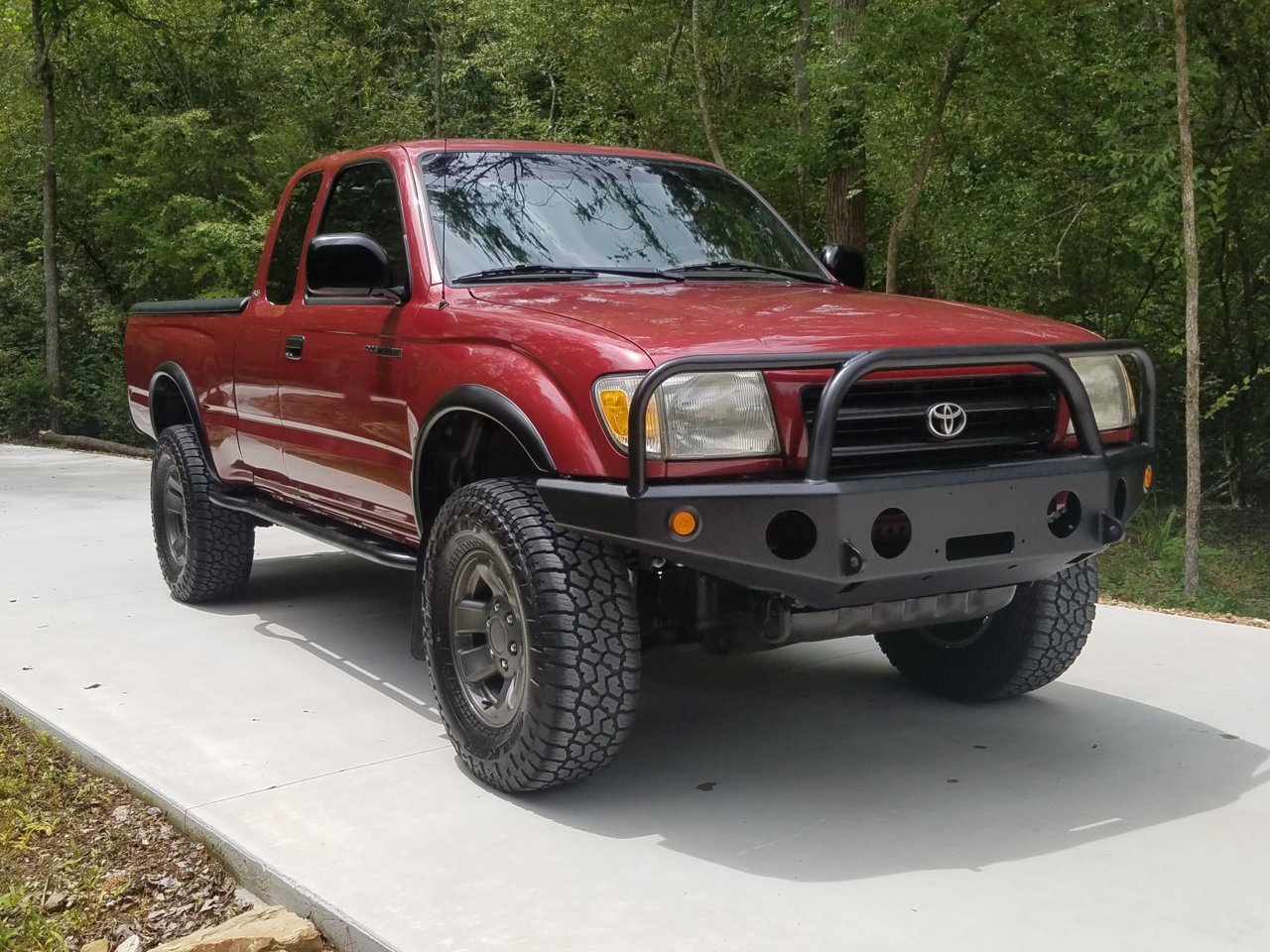

    The bumper for my '00 Tacoma came in today and I'm impressed with the craftsmanship. Everything is very straight and square. The welds are very nice and all of the exterior joints are buffed exceptionally well.

    Got it done. I purchased the hoops separately and fitted them myself; it was a lot of work and gives me appreciation for what Adam and others do. I also machined the hexed into a circles. Primed, two coats Rustoleum truck bed, lightly sand to knock off grit, then two coats of semi-gloss.20200523_134628.jpg

    I ended up selling the bumper and sliders due to the weight they added to the truck. My truck is back to stock but I kept the tad bit of lift. I can say that the paint is likely holding up pretty well because I've used the same treatment on the OEM bumper and it's holding up pretty well. If your planning to do serious off roading when the bumper might contact rocks, paint it because it's easily touched up. If your truck will be a mall crawler, powder coat will likely hold up better.

    IMO, this bumper and paint will work great for your intended use. There is a lot to like about this bumper. Knowing you won't be doing a winch will make the install a little easier. I went the extra mile believing I would install a winch. Check out the link in my sig for more details about how I painted the bumper. If the info in my sig does have it, this link should: https://www.tacomaworld.com/posts/23320910/
    I have 5100's set on 2nd notch and added a two Dakota rear leaf springs to get my lift.
