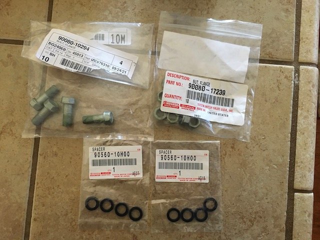

    Looking to finish my 4x4 conversion and can't seem to find the used front differential hardware that I had bought originally.
    Does anyone know the size and threads of the front four bolts that go through the driveshaft to the differential flange?
    Also the thread pitch on the transfer case side of things? Don't have the time or money to deal with the stealership. They wanted $20 just for the washers.

    I just ordered these parts to rebuild the front propellor shaft. The pic shows the parts with numbers I have which fit my 96. Also, the washers come in a four pack so that may be why they were $20, I ended up with eight, 4-packs. Anyway, the bolts are 10mm with a 1.0mm pitch, the bolt shaft is 27mm long and it takes a 14mm socket. The front and rear of the front propellor shaft all take the same, nut so the rear bolts should be the same. Hope that helps.
