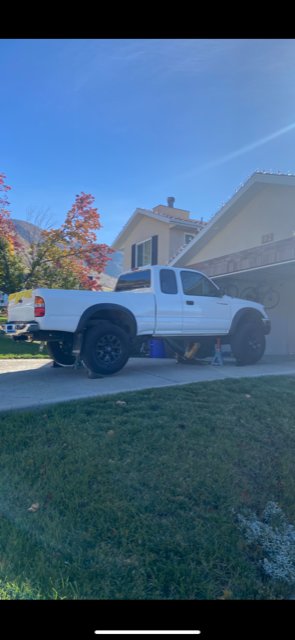

    Hoping to pick some brains that have gone done this route before! A year ago I bought a 2003 Tacoma Access Cab 2.7L 4 Cylinder 201,000 Mile truck. I love it!! In the spring when it warms up I want to go through and redo the suspension and front end.
    The truck drives ok.... Truck feels like it "sails" on the freeway, pretty loose steering. Also doesn't feel like there is much shock dampening happening anymore. As far as I know, all the steering and suspension components are original to the truck.
    Can you all help me spend some money and create a shopping list? During black friday, i purchased: 555's Upper and Lower ball joints, inner/outer tie rods, sway bar end links. I also plan on buying https://www.energysuspensionparts.com/8.18107 and redoing the uca, lca bushings, steering rack bushings, sway bar bushing etc.
    1.) Other then doing Ball joints, tie rods, sway bar end links, UCA/LCA bushings, steering rack bushings, what else should I be touching/replacing while i've got it all torn apart?
    - Do I really need new lca cam bolt set ups etc?
    2.) Suspension Suggestions? I don't really care for a lift, if I get 1" that's fine, but not looking for it. Budget ~$1,200 or less if possible. My 3rd gen had a full set of ADS with clickers, SPC UCA etc. I'm not looking at ever doing that again, the truck sees offroad, but mostly just firebreak type roads to mtb trail/camp sites.
    - I've had my eye on eibach's
    https://www.shocksurplus.com/produc...ing-struts-adjustable-shocks-e60-82-005-02-10
    or
    https://www.shocksurplus.com/products/eibach-pro-truck-shocks-e60-82-005-01-10
    Finding stock OE like springs is impossible, i think i just have to use my stock coil springs.
