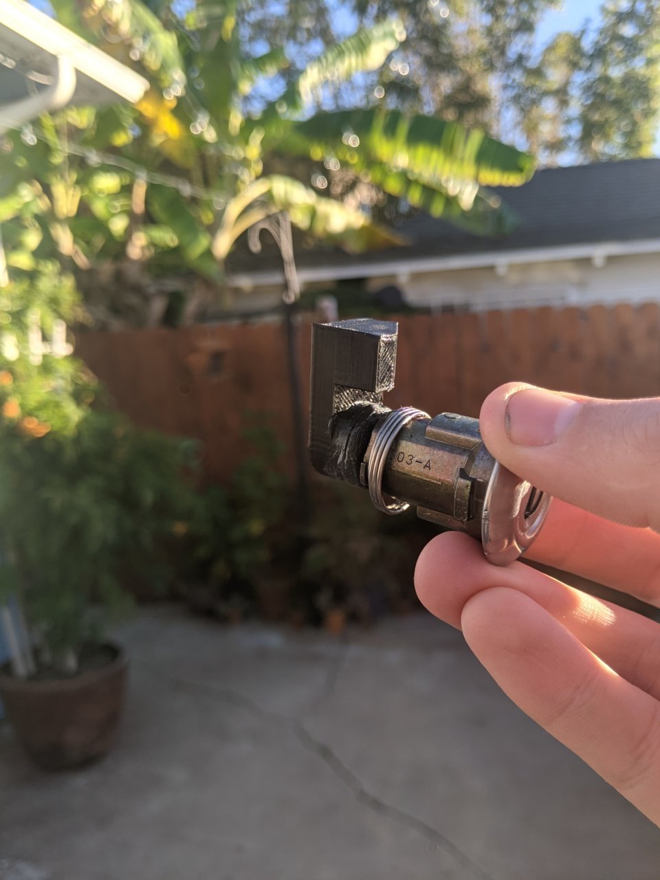

    Thank you so much to OP! Did this last weekend and works perfectly. For San Diego folks, I shopped around and got it printed at the Postal Connections at 4231 Balboa Ave for $7 total (they can only print in ABS plastic). I didn't screw the two pieces together like the OP mentioned (lazy), just JB Weld and let it cure for 24 hrs. I figure it was a $7 repair and it would have been $70 for the parts plus $25 for locksmith to rekey (i.e. $100 w/ tax total) so I could do this 14 more times if it breaks again and it will still pay for itself.
