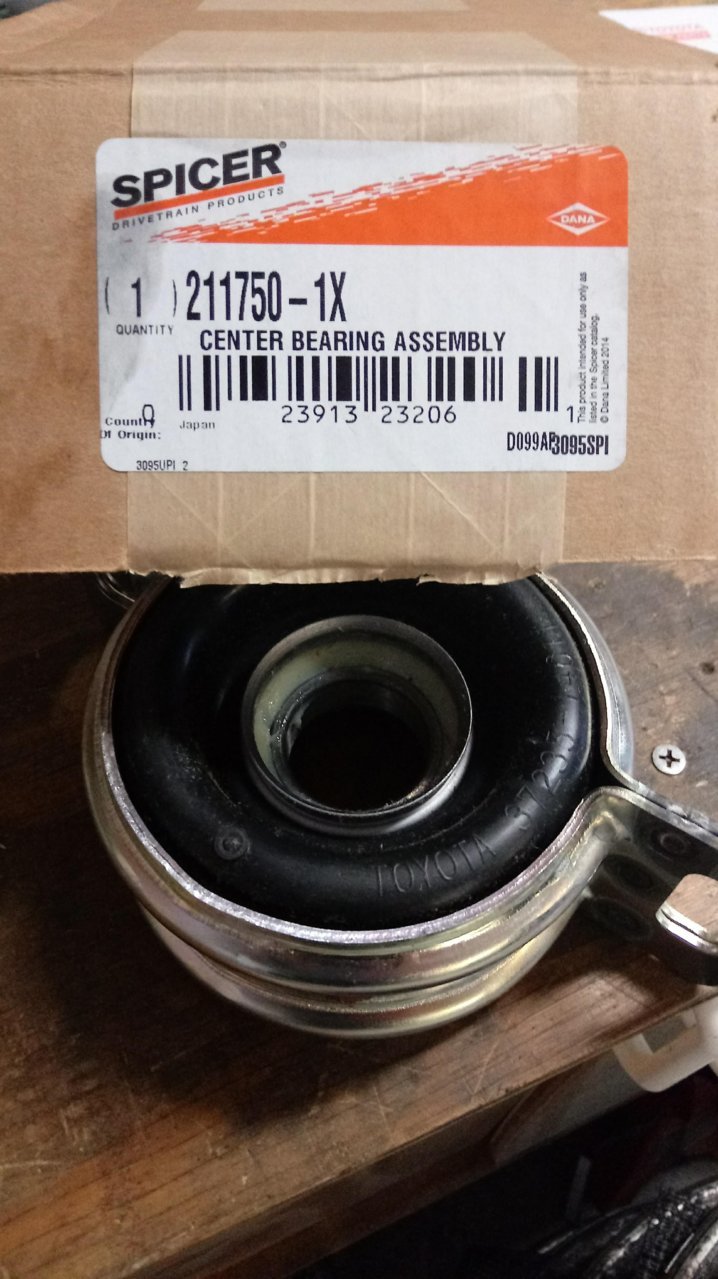

    Logger, Sodom and opteron like this.

    I've seen this exact once recommended on here before, should be legit
    StAndrew [OP] likes this.

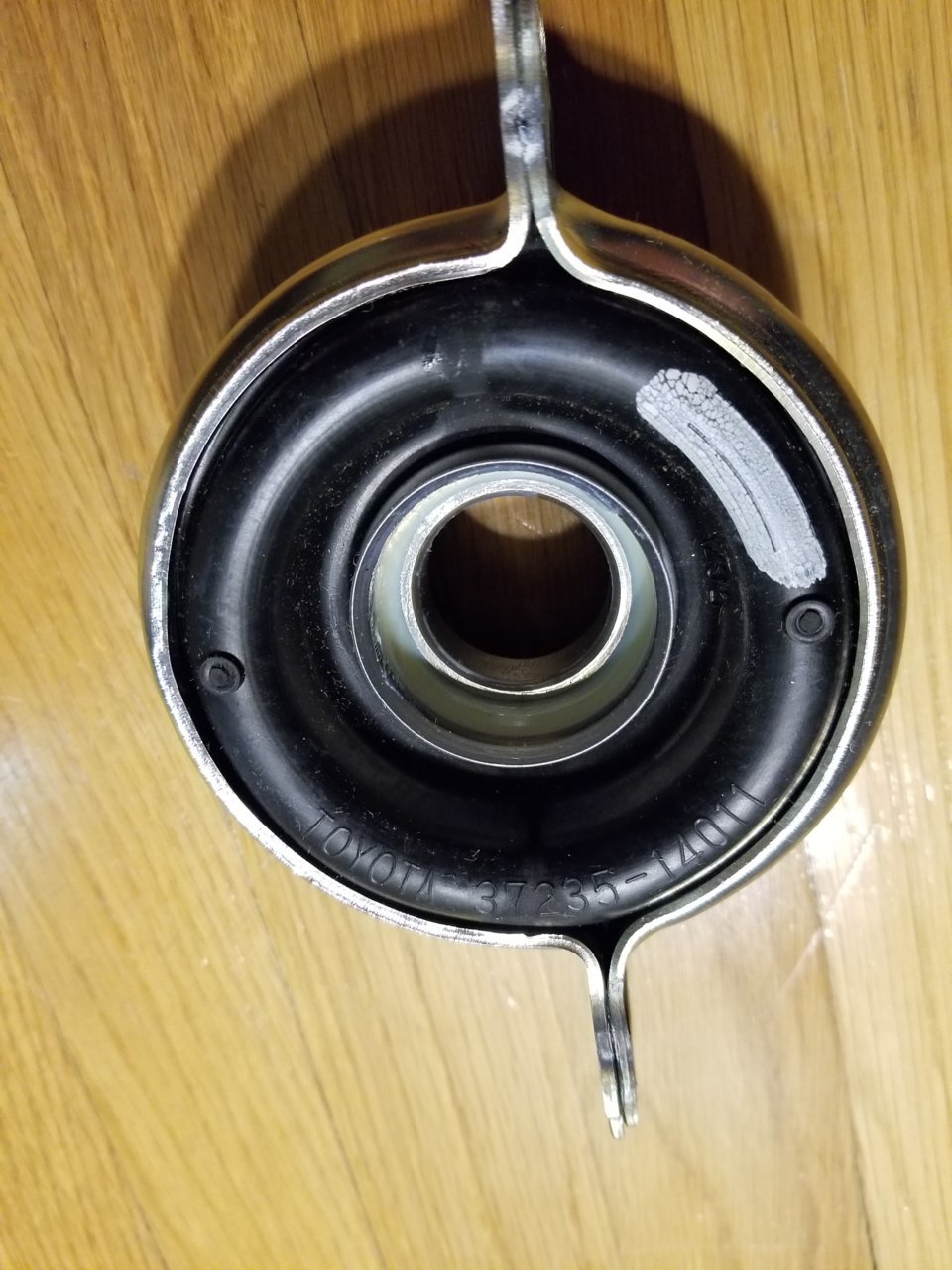

    Part number stamped on it is not the same as the one for a 1st gen though. I think it comes up for a T100 or Tundra. Either way, it fits fine. Going on 4k miles so far on mine.

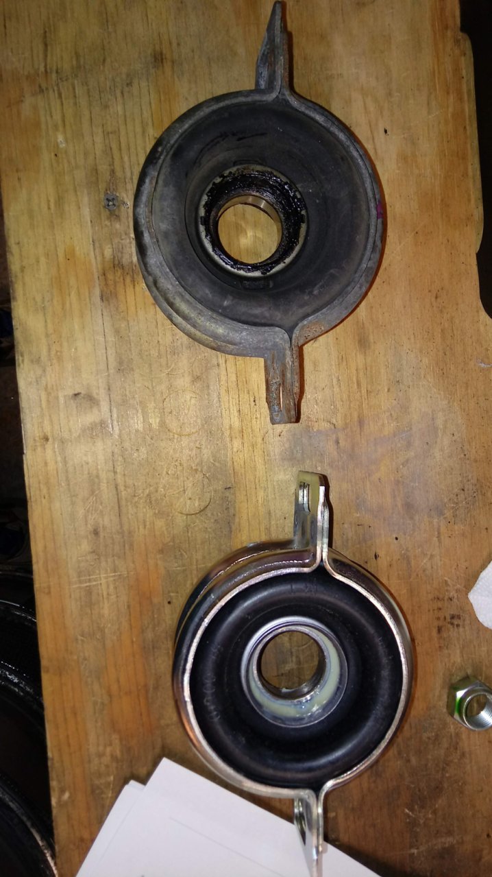

    Intake, exhaust, lift. Typical stuff.

    Only difference I noticed was that there is a dust cap over the white grease on the oem bearing. Kinda doesnt serve a purpose anyways, as its covered by the flanges on both sides.0923181400.jpg
    Did you get a new stake nut? Mine got destroyed taking it off.
