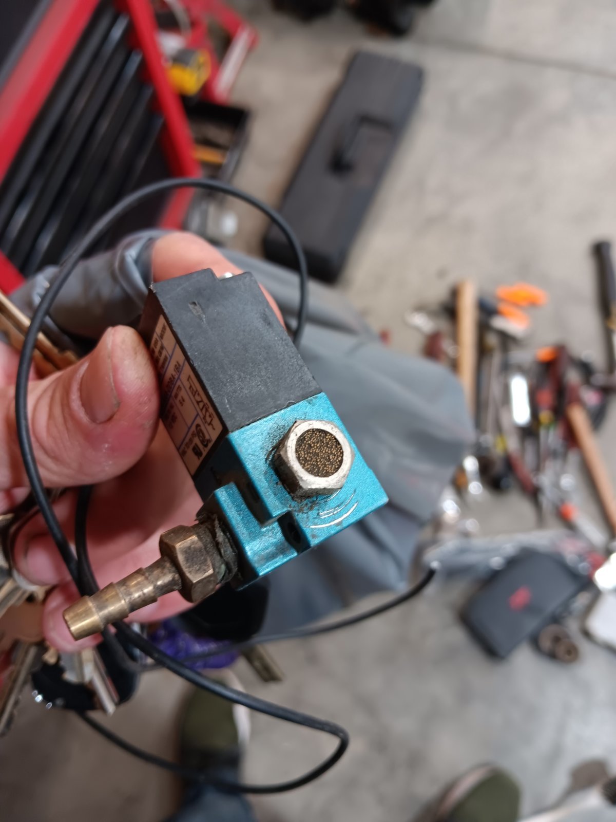

    I really thought that the boost controller was working wonderfully too, Now I'm questioning existence haha. I'll move the ports around before my next drive.
    After making a handful of changes to the target lambda table I went up black ridge again, it ran about 7°f cooler.
    thought I was doing some data logging earlier and realized when I got home the trigger conditions I input didn't save so it didn't record. I guess that's why the tape icon wasn't blue and spinning.
    :jpow:
    I'm making a few more adjustments and might try again tonight if only to break in the fresh oil change.

    The boost controller was giving you all the response! Just not controlled. Forget about boost for now, get everything ironed out, usable and safe. Then add the sauce.

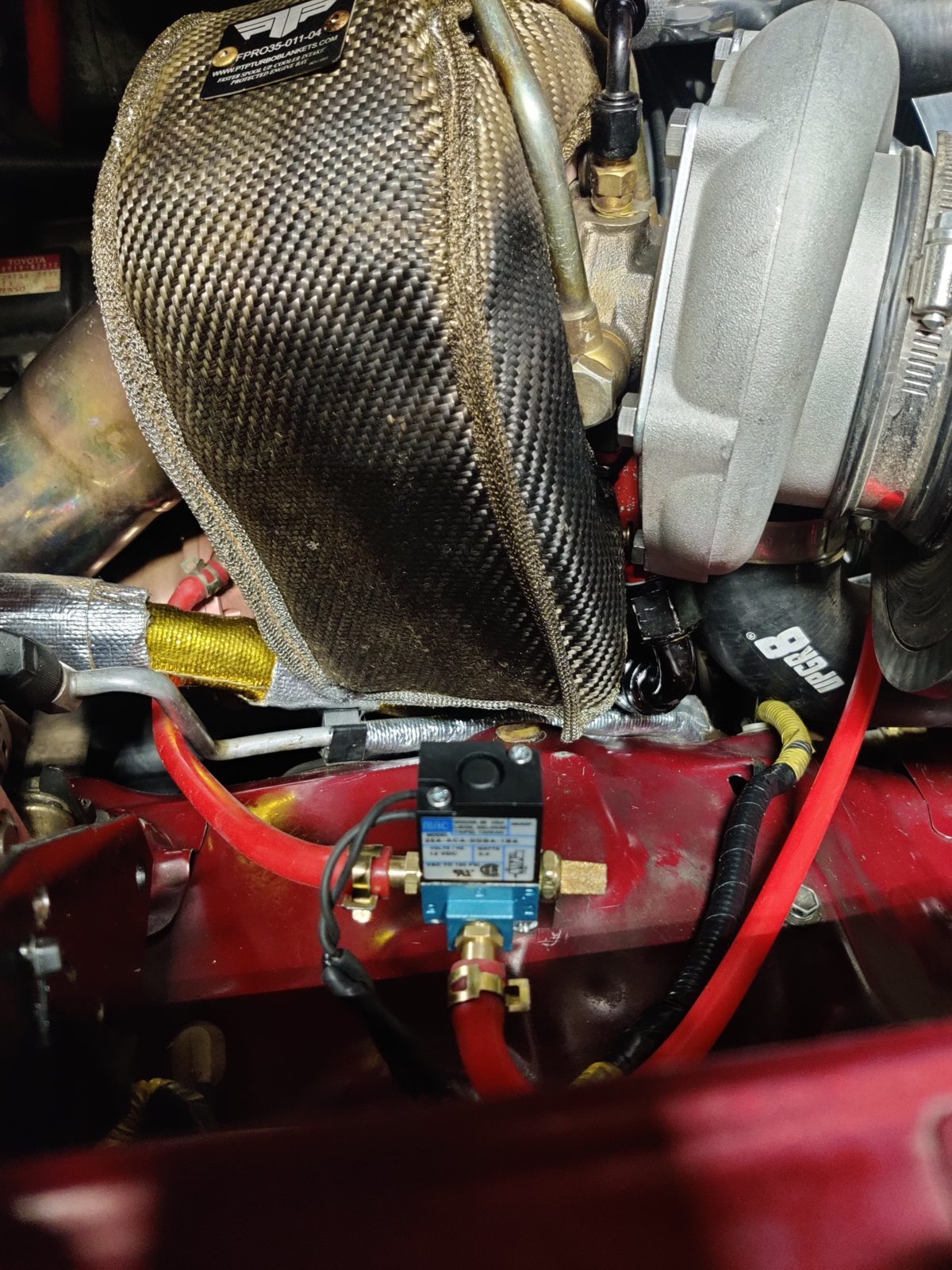

    Boost reference source location? Any charge pipe leaks?

    Boost reference for the MAP is at the FPR. EBC boost reference is on the turbo, That stuff hasn't changed for the last year.
    In the charge pipe I have 3 vacuum ports from the Airaid intake tube that weren't sealed as good as I thought they were but I slapped some JB weld plastic epoxy in them a few days ago so the charge pipes are sealed better than ever.
    I thought my plenum was leaking after I did the injectors but I think that was actually just the injectors being louder than oem. When I pulled it back apart to replace the injector O rings I pinched I had my wife turn the ignition on to pressurize the fuel system and with my head under the hood and I could feel the fuel moving through the line making the noise. I also sprayed the MLS plenum gaskets with the copper stuff just to be sure it would seal since I didn't have new gaskets on hand (they arrived a day later) but it was making plenty of boost this afternoon when I drove it in the heat. I think it's the boost controller because that's the only thing I changed before the last drive

    For 1000 miles, no boost is better than ping. But the controller plumbed like Type 1 is just passing air through the solenoid with no bleed. It's just like having one solid piece of vacuum line from compressor to gate.

    Manual controller is a Turbosmart Boost Tee and it's been set to 5/100 clicks or almost as low as possible. I have it in right now and have it set to 0 so it should just be the 3.4 spring pressure.
