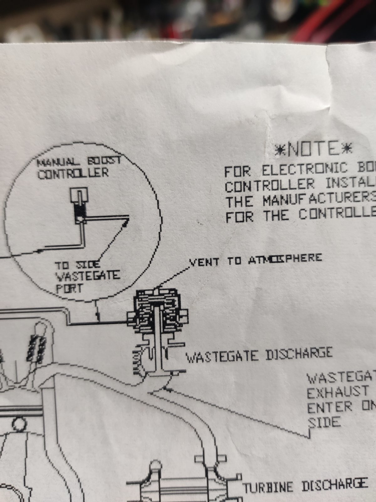

    Good gate. Is the signal line hooked to bottom port? Got pic of it installed? I just don't get how you only get .5psi with the solenoid setup as Type 1. You shouldn't be able to go lower than spring pressure.

    I followed the instructions and plugged it into to the side port. IMG_20240807_215905.jpg
    The engine felt sluggish and bogged down when it was only hitting .5 it was interesting for sure.

    That is the correct port.
    Elevation might be a factor.
    Bigger picture, keep ironing the Ve map. Don't be greedy and blow this thing up. We can add boost no problem later on.
