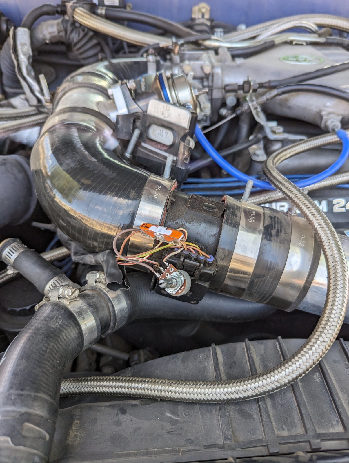

    Would anyone else like to take a peep at my current map. If there's changes to make I'd prefer to do it today because we'll be on the road for the next week starting tomorrow.
    I have classic transient throttle active instead of map prediction still and might try making the switch again but last time it died on me back to back at 2 different intersections and wouldn't start the second time until I loaded a previous file.
    I finally found the pull ups Zane was referring to. If there's a way to adjust that and get the CTS to register correctly on the ScanGauge id be very happy but my wife would be even happier because she's the one holding the laptop so I can monitor it in NSP.
