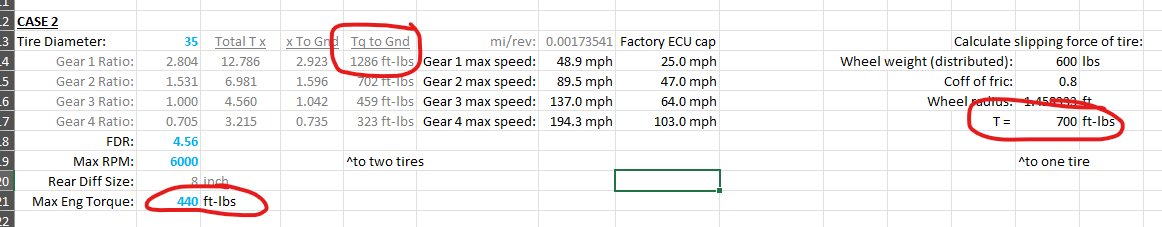

    @Speedytech7 I was doing some calcs to help me figure out what gearing/tire setup I want to pursue and I know you have a manual so a little different, but the napkin math shows you could be slipping soon with an empty bed. I don't remember your exact gearing or dyno torque though

    It wouldn't surprise me. I'm on mudterrains too so I would actually expect it to slip a little earlier at least on pavement. If there's even a slightest bit of moisture or anything altering the traction surface though it instantly lights them both up, in 4wd in winter I got a good full sideways launch just because it was below freezing and I dared to matt it haha.
