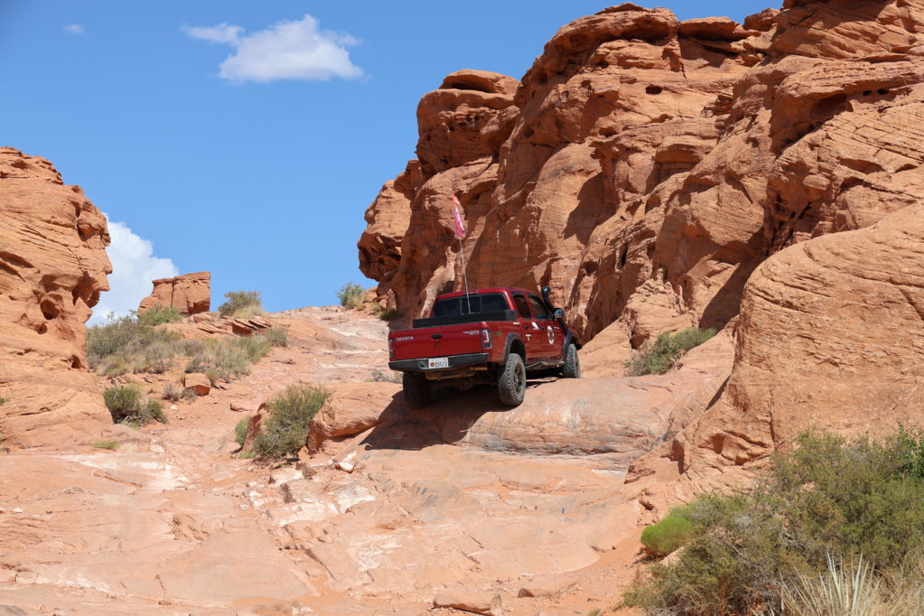

    I stalled out a couple more times yesterday while hooning around Sand Hollow.
    The first instance was right at the top of a small rock wall as my front tires were coming back down the other side. There was a crack/ gap in the rock that I wasn't expecting and the truck died right as the tire went into the gap. (@time623 may have a picture of the spot but I'm sure they don't have service right now) Was a nice natural wheel stop to keep me from rolling backwards but it's also probably part of why it died. Immediately after it died I was able to crank it but it was barely running at around 250 rpms and died after maybe 10 seconds. It did that maybe 3 times. The throttle didn't seem to have any effect on rpms.
    I forgot the laptop too so I wasn't able to check it out in NSP while it was happening.
    After almost exactly 10 minutes the truck started back up and ran like it never happened and away we went to get (almost) stuck in the sand.

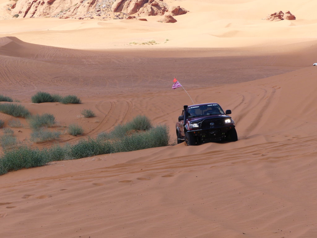

    The second time it died I was off the beaten path driving through some super deep sand that robbed all my momentum. I think it would have died there regardless of the ECU just from being bogged down by sand but I might as well mention it. I didn't even bother trying to start it back up at first. Just left it to get a couple quick pictures and point out a better path that I should have used.
    By the time James was in position above me as a possible anchor point another citizen showed up in a turbo charged dune machine to provide assistance. I climbed back in and the truck fired right back up, instead of fighting forward up the hill i put it in reverse and backed out without any issues.

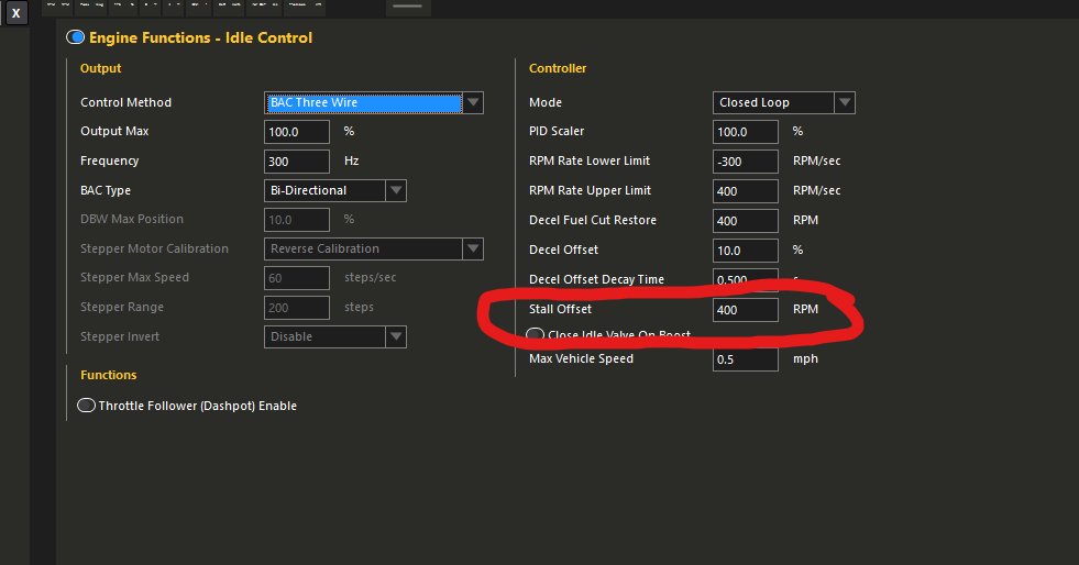

    I still have issues starting where it'll crank and crank and crank and finally stumble and catch, other times where it'll only start after I release the key, and times when it'll start immediately on the first crank. Very annoying and I still don't know what's causing it.
    I would increase your stall offset though for now

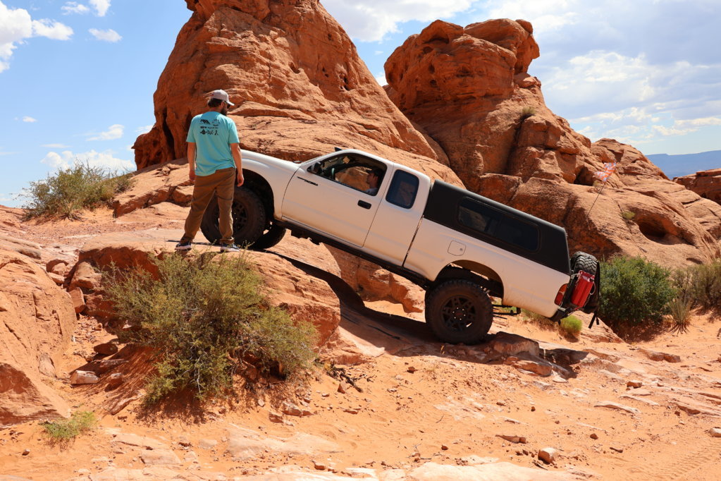

    Yeah that's the spot, Great shots too! my front drivers tire was right in the crack between the bolders to the left of where I'm standing in the last picture when it stalled. Definitely an on and off situation with the throttle crawling around in 4lo.

    @treyus30 my idle controle isn't even turned on. Maybe that's from being on the base map prediction :notsure:

    Idk man, the stall offset was already at 500rpm (once I turned it on)
    I have a hard time with this sort of thing. Maybe it was turned off for a reason and I'm screwing something else that I don't understand up by turning it on? i don't think I have ever touched it before just now

    Did you build your own harness? If so then I can see that being the case
    Except you're controlling ignition and factory ECU would be controlling throttle - I can see how that would result in these issues
