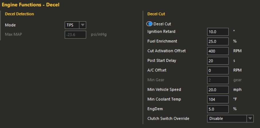

    Has anyone added in a decel fuel cut page?
    I'm still looking for some efficiency and found this video talking about it.
    https://www.youtube.com/watch?v=D8ABmD7bP-o
    Does anyone have a file that I can load and mess with? Don't really want to spend $550 to get it from Evans.

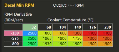

  10. Sep 14, 2024 at 5:34 PM
    #2170
    treyus30
    treyus30 70% complete 70% of the time
    Jun 24, 2015
    #158054
    8,406
    Trey
    Mesa / AJ, AZ
    '99 5VZ-FE Twin K03s w/Haltech
    Historic plates and 2 bar
    Auto and manual will work differently. Which one you got?
    TMFF[QUOTED] likes this.
  11. Sep 14, 2024 at 5:58 PM
    #2171
    treyus30
    Jun 24, 2015
    #158054
    8,406
    Trey
    Mesa / AJ, AZ
    Anyway, here's my current map for an auto. Decel isn't 100% optimized, but it's much better than the base map and works nearly seamlessly with my idle control setup.
    As I was saying before, I want to try bringing the min RPM all the way down to 1000, to where it coincides closer with my min vehicle speed.
    Min Coolant Temp setting makes the <104* cells useless, so reduction is an option there...
    A/C offset you might want to set up depending on how tight your idle control is.
    Fuel enrichment is possibly over-rich, but that should be a very minor impact.
    One final note is that cut activation offset and engdem could be too high, depending on how you drive. I noticed once going ~55 that I decel'd, put my foot down to maintain speed for a few seconds as traffic changed, and it was such a light throttle that it did not re-arm decel again. But that's probably a rare case.
    unstpible, Speedytech7[OP] and TMFF like this.
