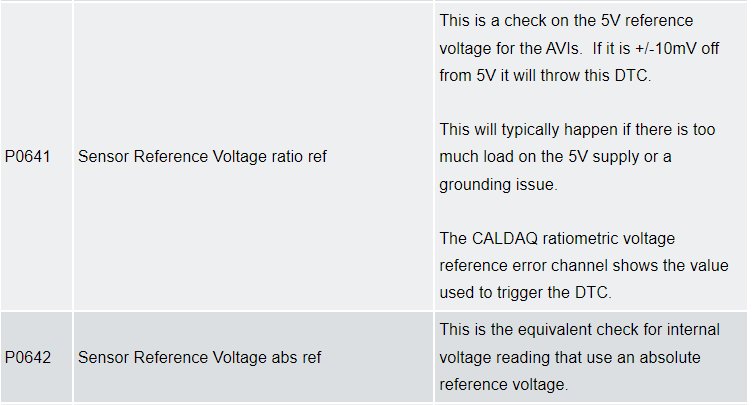

    It's less Tacoma and more mod
    That's a pretty ungood code and an odd one for your setup
    Check your grounds first and foremost, to my knowledge you're not using 5v ref for anything currently in your setup other than TPS maybe but it's throwing a code for the internal ref not the output one which points more to a 12v supply or grounding issue IMHO

    I guess that's why it reads "abs" not "ABS"

    yessir, short for absolute

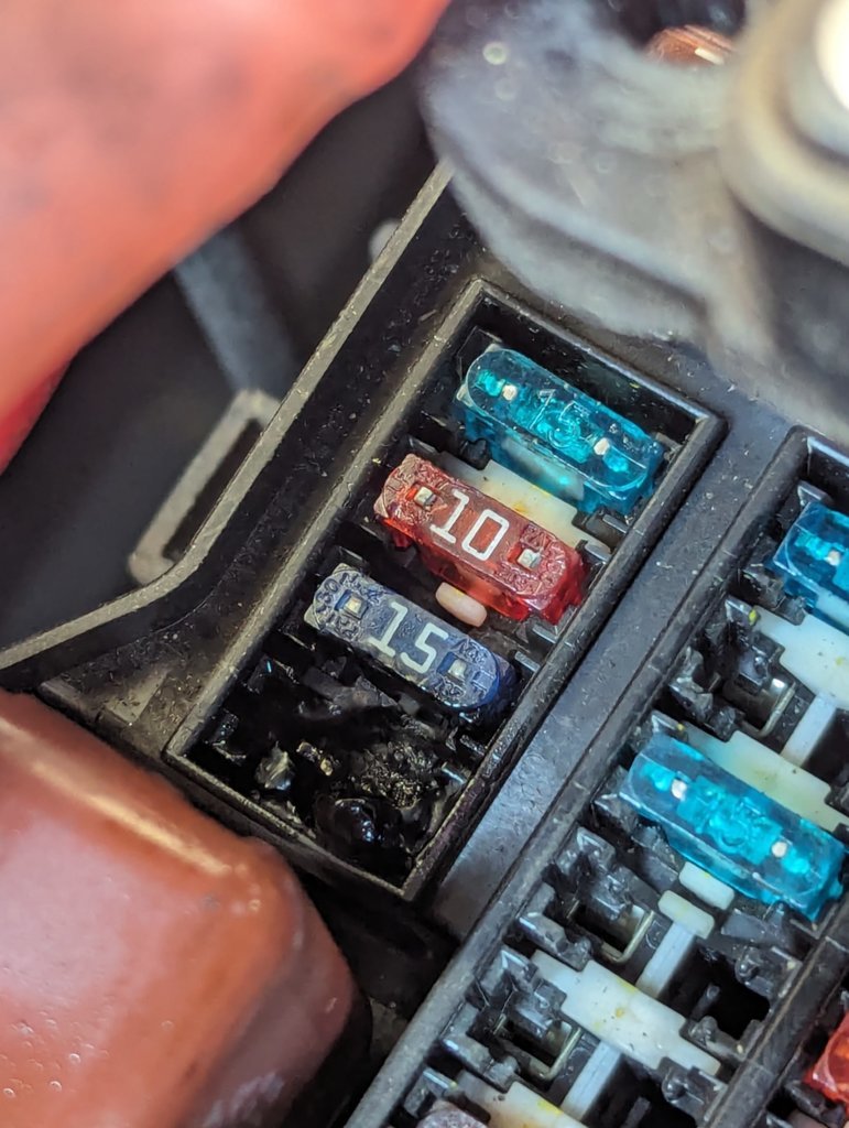

    Will be investigating how this could have happened, but this is my EFI fuse. I thought I smelled electrical burning after a towing adventure earlier this week... It's miraculous the truck still runs

    Are the remnants of the fuse still in there?

    Yes, just dug them out

    Wondering if I should drive my fuel pump on a separate circuit now since it draws 12 amps on its own.. I can't remember if I was running a 15A or 20A fuse either. FSM says run 20A, fuse box says run 15.
    I probably will, but not in a rewiring mood rn.

    That's pretty remarkable. I've never seen a fuse do that.

    Glad it didn't get any worse from there, that's crazy

    Seems like it was actually the +12V rail underneath making bad contact. I probed the current across the fuse contacts, got 12amps, and pulled them out to promptly burn myself on the tip (the plastic around it had also started melting). So I removed the whole fuse box, cut the wires, and put a new inline fuse in for it.
    Was hoping that was the cause of my uncorrectable lean and knock codes (going back to factory for emissions) but appears not.

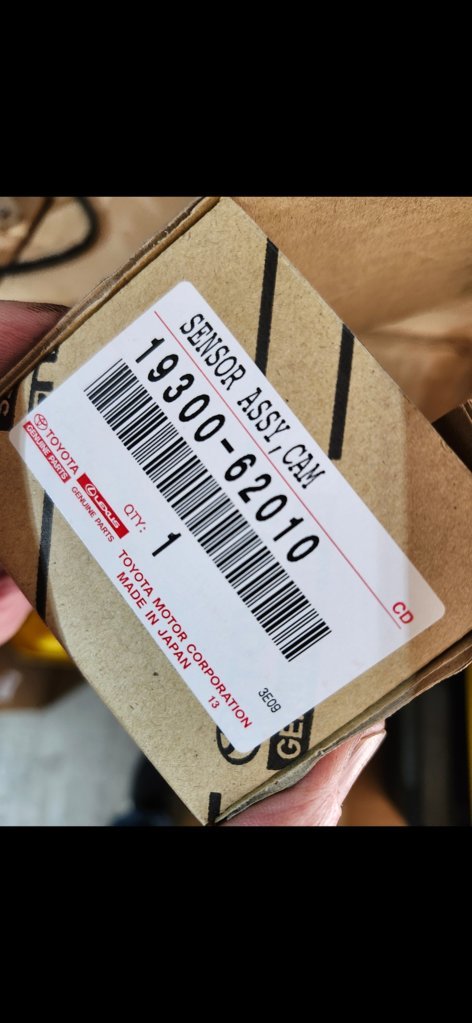

    New camshaft sensor and everything is good back to normal

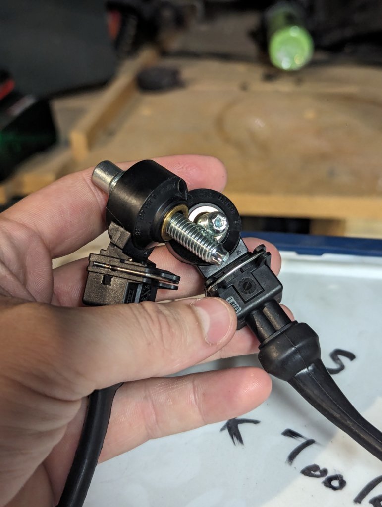

    Going to try these things with factory since apparently my stock are shot. Prepared to throw together a resonant band pass circuit with it if need be, but need to probe the ECU shunt resistance to determine L and C for 7.1kHz
