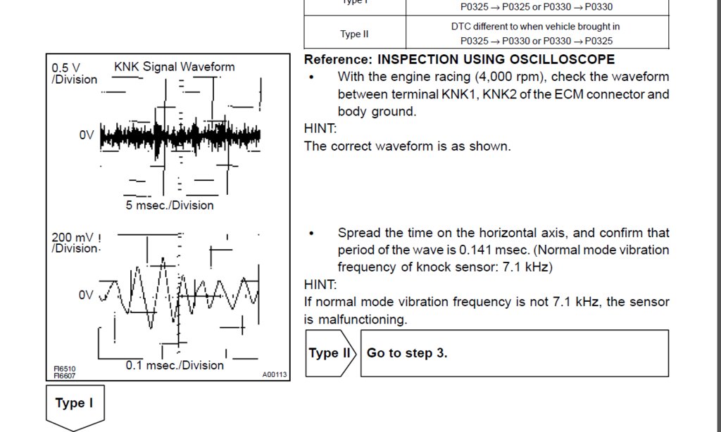

    Don't suppose anyone can confirm what voltage range should come from a knock sensor...?
    All I have on a P0300 is this and can't tell where the actual divisions are
    Widebands are in and are coming out at 20-50mV RMS between idle and 4krpm
    Narrowbands peaked at 200mV when I hit them with a flashlight
    Note this is with a multimeter, not a scope. That's the next step..
    Update: scope seems to show they are working correctly, but in factory open loop it just seems to not be very "loud". I'm at a loss for an explanation of these codes... Left a message for a historic vehicle insurance guy since supposedly that can actually bypass emissions requirement

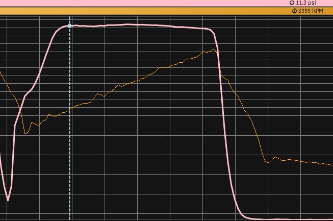

    Even more boost control tuning today with @2RZNoShi1... coming up to target and not oscillating around it is a beautiful thing, even moreso when you can do it in different gears immediately. Targeting 11.5psi and after each shift it is getting within +/- .3 which is great. Not overshooting and trimming back down has done wonders for the feel. Doesn't roll off power anymore either, it compensates as RPM rises so it'll be neat to see what that does for the dyno graph.

    How much are the duty cycles varying between gears?

    My system is touchy because it is a 4 port solenoid (less resolution than a 3 port) and my gate spring is 3.2lbs coupled with the fact that quick spool puts this thing on full boost rather quick.. so it varies by about .6% DC between gears usually which under steady state controller tuning is about 1psi. But using the PID control ideally has allowed us to shoot lower on the duty and have it bring it up to target very fast. We calculated it yesterday, it only took 500ms for it to regain control and tame a slight boost spike after a full throttle 3-4 (high load) shift. Proper PID control has also tamed its unruliness in denser air conditions.
