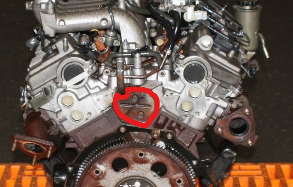

    I was planning on swapping out the knock sensors for the Bosch donuts as well, and tapping the lower manifold for an IAT sensor (supercharged), but worried about burning the sensors to a crisp in there. I wonder if removing the heat shield below would provide a little relief.

    Sensors should survive fine in there. Could live them to the outside of you wanted but I don't think there's a great bung location. There's no conjoined plenum area in the lower intake, I'd consider putting your IAT in the SC chamber right before it turns to individual runners
