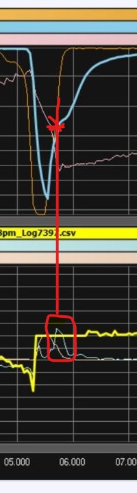

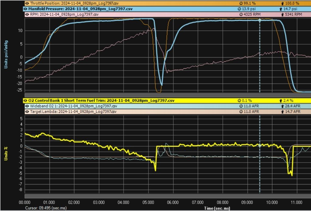

    Did some tuning with @Speedytech7 last night and got some good logs at some higher boost levels. Getting it ready for the dyno here soon. Pretty happy with that boost curve and the ve table is almost spot on. Should make some good numbers at 14psi

    Might want to get that transient looked at

    Wasn't last night's goal, we have a few hours of Dyno time coming up, should be a good time to tackle little odds and ends like that though. Anytime something lasts for a couple msec it's going to be hard to chase down entirely without some steady load tuning.

    The main goal has been to get the boost under control to eliminate spikes while keeping the response, and creating a very flat boost curve. Transient wasn't as much of a concern because the afr and load weren't in a bad place at that range, and I haven't looked over and smoothed the target lambda table yet. Map prediction also takes time to learn what it needs to do for situations like that, so we have to get the rest of the ve table dead on, and do some steady state tuning to get intricate little details like that more in line.
