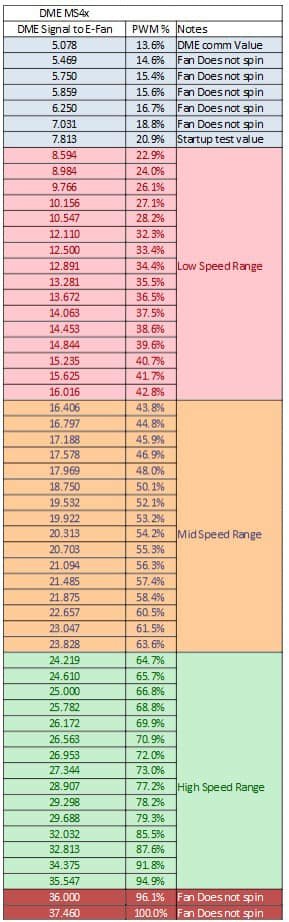

    Can you implement something akin to a deadband for the PWM?
    Like, no fan motion until the input signal passes 5% DC or some other threshold so any spurious signal below that threshold gets effectively ignored?
    Seems like it would be nice to still be able to run it off of constant power to help keep some airflow moving past the radiator after stopping in hot conditions, but maybe that’s not a big deal.
    At one point, my dumb nerd brain thought it would be neat to have a PID controller running a PWM fan and electric water pump so that both could potentially run together post-shutdown if needed. Seemed cooler than just relying only on the fan and convection in the coolant system. I figured it was a solution looking for a problem, but a neat idea nonetheless :D

    The fan controller is designed by Bosch and used in a ton of applications (OE BMW, Merc, Ford, Chevy...). It has some diagnostic duty modes that I think could cause this issue, it might be possible to put a diode in the PWM signal line to stop this behavior I guess. This is the table of various modes
    450145948_10160305472272406_151830010468_c6b7ee1919992ad999e4aeba864a335271e1394d.jpg
    I like the idea of the fan going when the engine isn't running for cooling but it doesn't really work in practice because there is no circulation, even at idle the engines cooling ability on the 5VZ is not radiator or fan limited it is water pump speed limited. I can run this fan at 100% (94.9% :p) duty at a perfect 750rpm idle and it won't go below ~192F, but if I even raise the idle slightly to 1200rpm I can get it down to 187 in seconds. Without an e-pump and e-fan I can't see much purpose to running the fan without the engine running, so I have that box checked in the software, turns it off if engine RPM = 0. That's how I dialed in the low idle fan DC I have now, because 28% might as well be 100% for how much hot coolant is making it to the rad.

    A 1-10k pull down resistor on the PWM wire near the fan side wouldn't work?

    I have a 1K one I can try. Certainly worth a shot. I just wondered if it would negate the DPO signal.

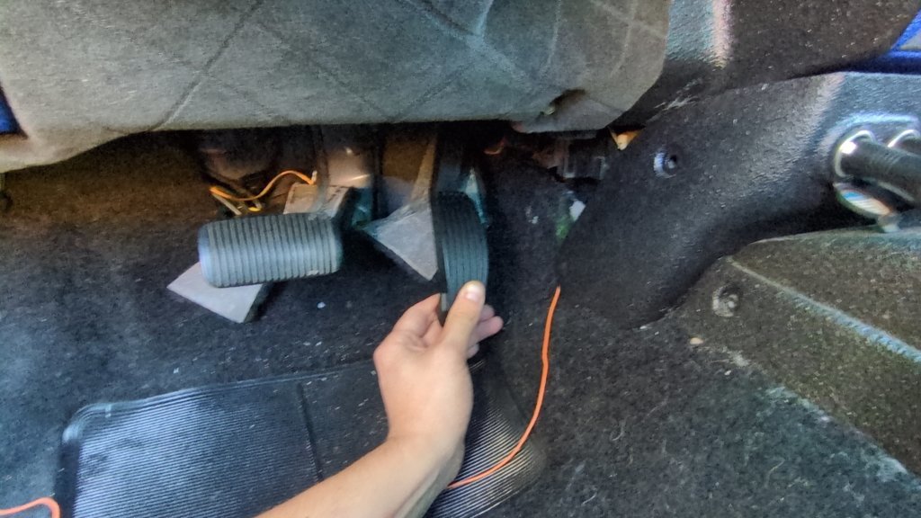

    Bosch pedal adaptation seems possible by reusing the top left stock firewall nut for the factory pedal wire, creating a small triangular plate that attaches the bottom two mounting holes to the two pedal mount nuts, and possibly just drilling another hole through the firewall for the final top right hole. Could probably run with 3 but the top is where all the force will be so kinda sketchy if you don't.
    I am holding it in place in the Pic because I don't have an M6 bolt quite long enough to get a nut on to hold it in place
