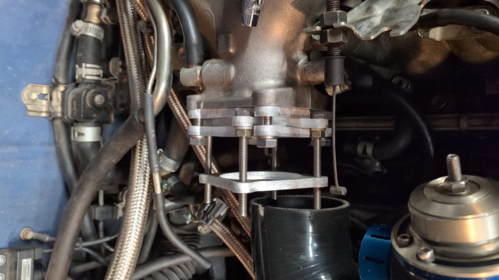

    Couple things I might do different if I need to remake them but I think it's secure and 99% leak free! (?) All in at around $65 for the adapter slices + hardware.

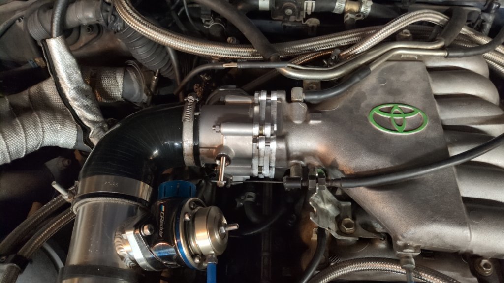

    Got the DBW all wired up and it used up all my AVIs haha so had to pull that one. Now onto relearning idle... I do have a tiny vacuum leak in the adapter stack I think so the throttle position oacillates around 1% to keep me at 650 rpm.
    So that high pitched whine is back and worse than ever. I think it might be injectors or FPR? Hopefully something dumb

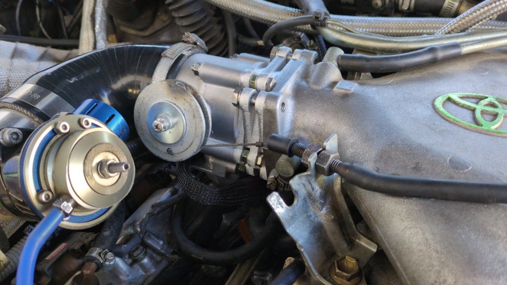

    Got the top pedal bracket fitted today (the hard part). Bottom is all that's left. The travel is a few degrees too long/more than factory, but I can program that out (eg: 80%=100%).
    It did some weird stuff when I moved the truck parking spots this morning so definitely going to have some kinks to iron out before hitting the road again.

    You may have to adjust your trans cable starting from when the throttle body is totally closed as well. When there's no power to them they're slightly open on a spring.

    Yea, it's a veryy tiny amount though. No trans issues (yet), but I have it about 15% preloaded. I could probably run it at 0 and just live with the top end neutered. If it works anything like throttle plates it'll be almost 100% pressure even at 70% pull

    Sounds like it needs a slipper mechanism after it reaches 100%. Wouldn't wanna lose WOT personally.

    You got it backwards, the cable still has some slack at WOT. I made the radius a little too small

    Oh I see, thought you weren't opening the throttle all the way, easy enough to make the radius bigger, just need some tape haha
