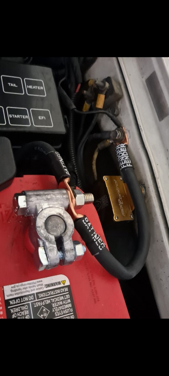

    Trigger issues fixed!
    Have had the haltech installed for a year now with 30k plus miles on it.
    I've been having Trigger issues for the last 7 months and before that it was running perfectly.
    The haltech did an auto update and the engine started to have trigger issues at 5100rpms from the previous 5600rpms rev limiter.
    Have been try multiple things to get it fixed and nothing worked.
    Decided to replace the camshaft sensor as I had already replaced the crankshaft sensor.
    Got an OEM camshaft sensor from dealership and then the Trigger issues got worse cutting the engine at 3800-4100rpms.

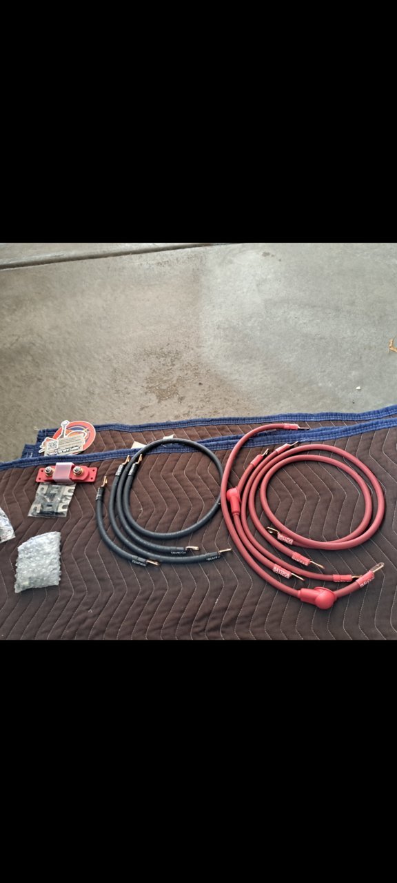

    I then added the big 7 (two gauge) ground wires, fender, engine and firewall,
    Still no change,

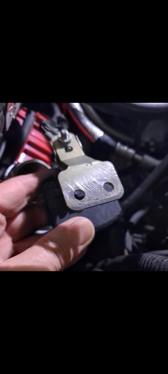

    I took a wire wheel to the bracket that holds the ground stap for the ECU and scrapped the paint off the supercharger where the bracket is attached,
    Still nothing.
    Today I decided to remove the new OEM camshaft sensor and put the old one back in so I could drive the truck with a 5100rpm until further time instead of the 3800rpms.
    Well guess what?
    The Trigger issues are gone and no Trigger check engine light anymore,
    THE OEM CAMSHAFT WAS DEFECTIVE
    The grounds were my problem!
    Can't expression HOW IMPORTANT all ground strap wires or connecting are and use dielectric grease.
    1) cable from battery to fender,
    2) cable from battery to engine,
    3)cable from firewall to engine

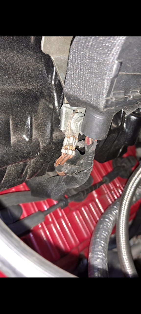

    4) the brown ground strap wires for the ecu that are connected to the supercharger.
    5) the bracket and supercharger contact areas.
    Shes running fantastic again
