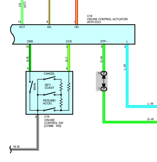

    lol, no, but I like the damping feature, and torque response is gonna be little more linear. Looking into cruise control now though. Seems like I just need to find the "CCS" wire upload_2024-11-27_16-48-22.png

    Seems like the CC has a double snag... the "Main SW" seems to have more circuitry tied to it that isn't listed, and the outputs are on a +12V base rather than a 5V.
    I could use the resistances with a 5V feed but it seems like they wont respond until 12V is present on the source feed.... so I'll need to find wherever that 'Main SW' is and bypass it in order to use the factory steering wheel buttons
