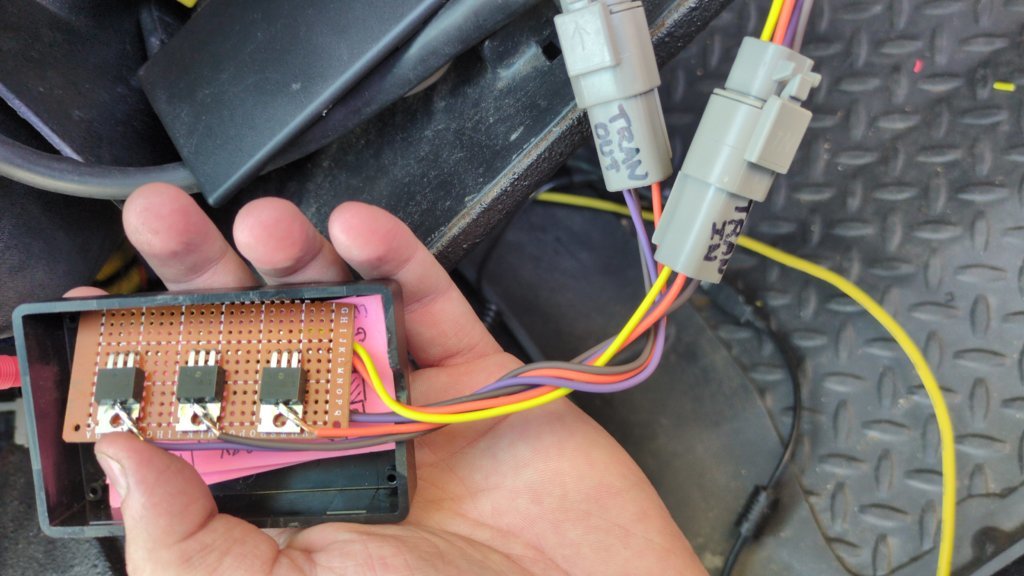

    Two side notes:
    1. Anyone interested, shoot me a PM if you want info on how to wire the solenoid amplifier and what to buy (very simple)
    2. The new Nexus ECU supports more amps and would not need external circuitry to drive them

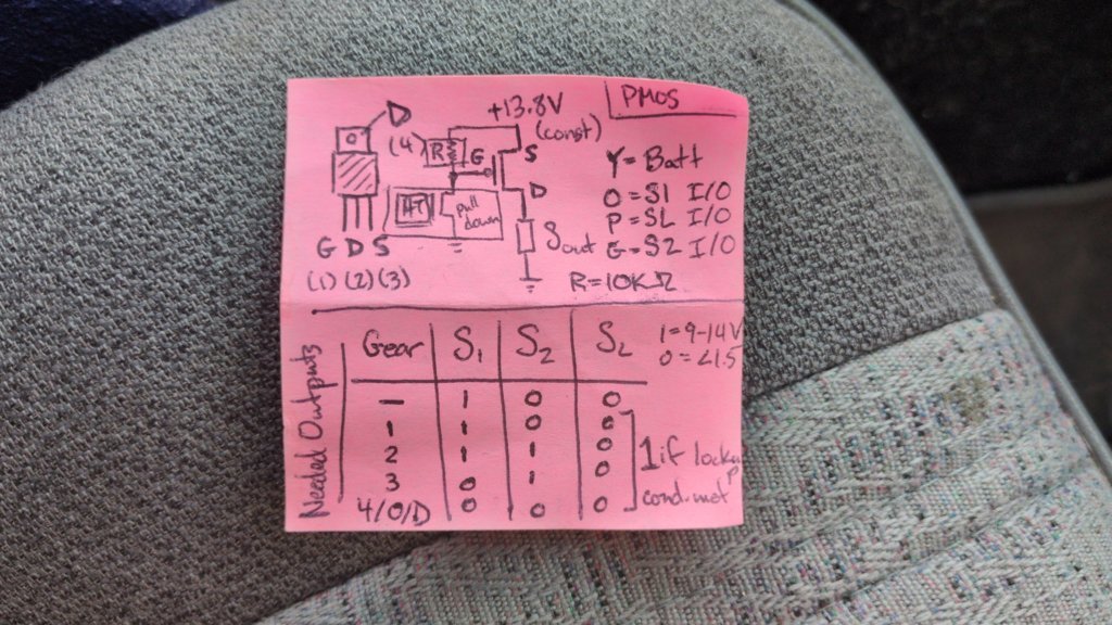

    IRF5305 MOSFETs. Source is battery (I tapped the CAN WB1 line), Drain is solenoids out, Gate is Haltech with a pullup to battery voltage (active low since PMOS).
    Ignore the "R". That was if I couldn't do an internal pull-up.
    I can always quickly go back to factory control:
    unstpible, TMFF, Digiratus and 2 others like this.

    betterbuckleup
    betterbuckleup Well-Known Member
    Jun 26, 2017
    #222483
    4,835
    Ian
    Concord, CA
    2000 Tacoma SC 2.7 4x4 5spd
    What's the function of this? For trans?
