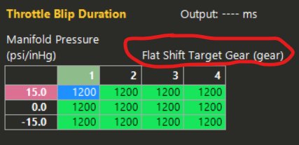

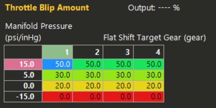

    4. (this is the one I need help with) I tried setting up flat foot shifting but it's not working. Specifically, this table does not change gears so I'm not even sure it's the correct axis to be using?

    Thought there was one person in here running flat foot. @garetcurry was that you? Any help on the above?

    I... don't think that's me? Sorry man.

    I think it may be doing downshifts but not upshifts. Yesterday truck almost died when the trans downshifted into first after a corner as I floored it. Hard to tell exactly without logs. So I think what happened was: throttle open in 2nd -> downshift to first / throttle blip -30% / MAP prediction to 100% -> super rich at low effective throttle -> RPM tanks under rich misfire. But that just adds to my MAP prediction issues too...lots of those I haven't talked much about.
